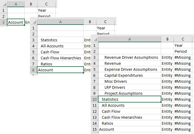

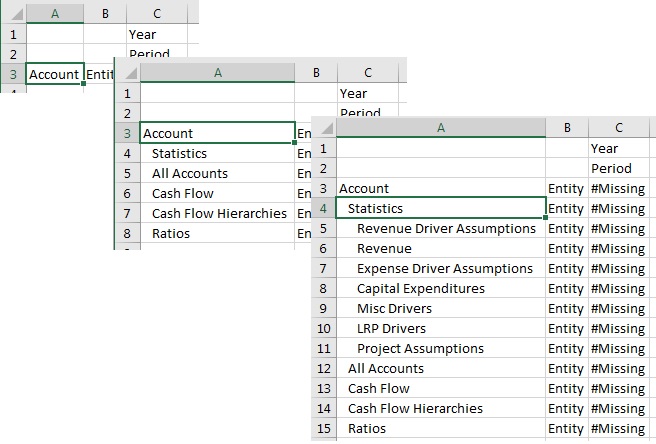

Example 6-3 Zoom in Results Selecting Ancestor Position - Top
In this example, we zoom in on the Account dimension. After zooming in, the Account ancestor is shown at the top of its children members. Next, we zoom in on Statistics. After zooming in, the Statistics ancestor is shown at the top of its children members.
Figure 6-8 Zooming In with Ancestor Position Set to Top
With the Ancestor on Top option selected, shows the result of zooming in on the Account dimension, then shows the result of zooming in on the Statistics member. In each case, the ancestor is at the top of the hierarchy, the children are listed below.
Example 6-4 Zoom in Results Selecting Ancestor Position - Bottom
In this example, we zoom in on the Account dimension. After zooming in, the Account ancestor is shown at the bottom of its children members. Next, we zoom in on Statistics. After zooming in, the Statistics ancestor is shown at the bottom of its children members.
Figure 6-9 Zooming In with Ancestor Position Set to Bottom
With the Ancestor on Bottom option selected, shows the result of zooming in on the Account dimension, then shows the result of zooming in on the Statistics member. In each case, the ancestor is at the bottom of the hierarchy, the children are listed above.
