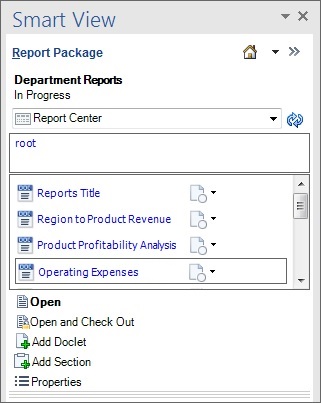

  2. In the Smart View Panel, select the doclet to check out.
    Figure 23-55 Smart View Panel Showing the Operating Expenses Doclets Selected
    Initial report package window showing the report package name and listing the doclets it contains. The doclet entitled Operating Expenses is selected

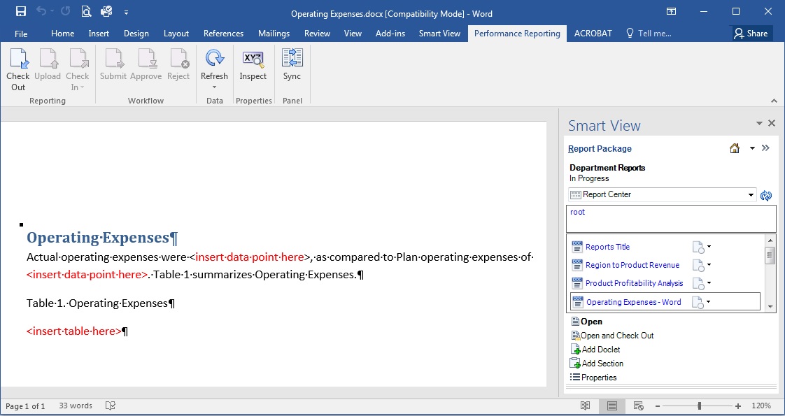

  3. Double-click the doclet name to open it.
    Figure 23-56 Doclet Opened from Smart View Panel, Ready to be Checked Out
    Shows the Word interface, at the right of the window, doclet opened on the left side
  4. In the Narrative Reporting ribbon, click Check Out.
    The Check Out button in the Narrative Reporting ribbon
    You can now author in the doclet. The example doclet in Figure 23-56 has placeholders within the paragraph for pasting data points. You can paste the entire grid below the table caption.

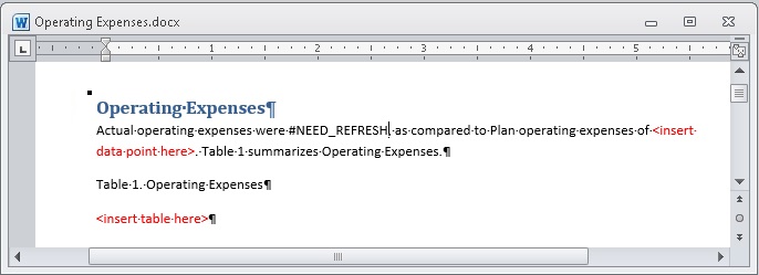

    3. In Word, position the cursor in the paragraph at the required location, and then, in the Smart View ribbon, click Paste.
      The paste operation results in a placeholder, "#NEED_REFRESH".
      The doclet showing the #NEED_REFRESH placeholder at the point where we pasted the data point
      In this scenario, a second data point for plan operating expenses is pasted into the paragraph.

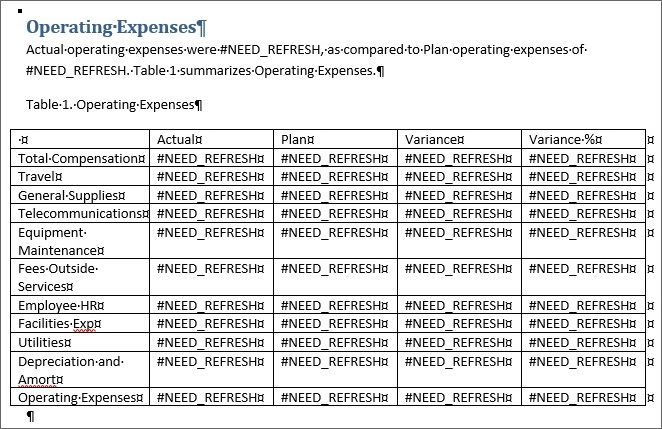

    3. In Word, position the cursor at the location that you require, and in the Smart View ribbon, click Paste.
      The paste operation results in a table in which every cell is populated with the placeholder, "#NEED_REFRESH", as shown in Figure 23-58.
      Figure 23-58 Ad Hoc Grid Range Pasted Below Table Caption
      Shows the grid pasted into Word, all data cells contain the #NEED_REFRESH placeholder.
    The data points and range are ready to be refreshed.

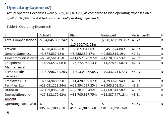

    The resulting doclet page should look like this:
    Shows the refreshed doclet page, with figures where the #NEED_REFRESH placeholders were.

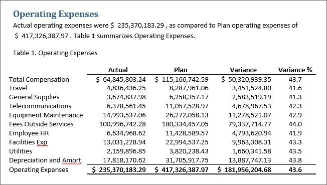

    After you've applied the Word formatting, the table should resemble the table in Figure 23-59.
    Figure 23-59 Doclet Example Containing Formatted Word Table
    Shows the report in a formatted Word table.
