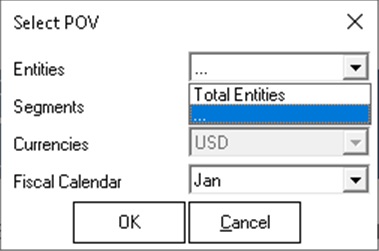

  3. If the drop-down list contains a ellipsis option, Ellipsis symbol:
    1. Click Ellipsis symbol to open the Member Selection dialog.
      In the following example, the Entities dimension contains an Ellipsis symbol option.
      Select POV dialog; the Entities dimension shows an ellipsis in the drop-down list
    2. In the left pane of the Member Selection dialog, expand the members where necessary, then select a member and click Right arrow button to move it to the right pane, and then click OK.
      Only one member from the current dimension can be selected at a time. To select a member from a different dimension, you must exit Member Selection and then select a different dimension in the Select POV dialog.
