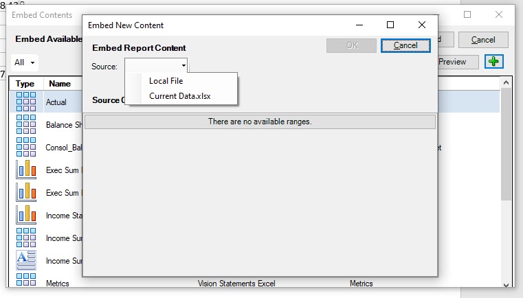

  3. Click The Add available content button in the Embed Contents dialog to launch the Embed New Content dialog.
  4. In Embed New Content, click the drop-down menu in the Source field and select an option, as shown in Figure 22-31.
    • Local File—After selecting Local File, click The Choose File button, browse to the location of the Excel file that you plan to use as a reference file, and then select the file.
    • A reference file—If you want to add more available content from a previously registered reference file in the list, select the file from the Source drop-down menu.
    Figure 22-31 Embed New Content Dialog Box
    The Embed New Content dialog box, showing the drop-down menu in the Source field, where you select Local File the first time you add a reference file to a doclet or select a reference file that is already in the list
    With either selection, the list of ranges that can be selected for available content is displayed under Source Objects.
    For the example in this topic, we'll select the Current Data.xlsx file that was using previously in Registering Reference Files with a Doclet and Embedding Reference File Content in a Doclet, and now lists four ranges under Source Objects that can be added as available content, as shown in Figure 22-31 in the next step.

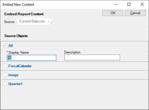

  5. In the Embed New Content dialog, click the source object name (not the check box) that you want to embed in the doclet.
    Tip:
    Select only one object.
    In Figure 22-32, the source object named "All" is clicked and the check box is selected.
    Figure 22-32 Embed New Content Dialog Box with a Named Range Selected
    The Embed New Content dialog box with a named range selected.
  6. Click OK to embed the selected content into the doclet.

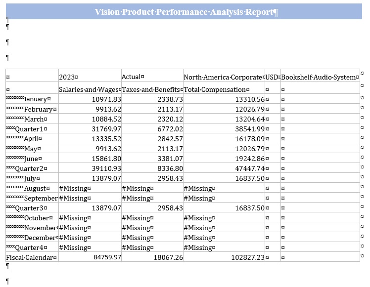

    The example in Figure 22-33 shows an Excel table embedded into a Word doclet.
    Figure 22-33 Content from Reference File Embedded in Word Doclet
    Example of an Excel table from a reference file embedded into a Word doclet
