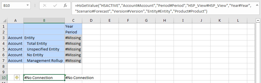

  • HsGetValue functions, function grids, and dynamic data points must be created using Smart View 11.1.2.5.900 or later and refreshed once to save the connection information. Otherwise, the server-initiated refresh will not be able to evaluate the functions, function grids, or data points and a #No Connection message will be returned.
    If you're not using Smart View version 11.1.2.5.900 or later, then HsGetValue functions, function grids, and dynamic data points should not be included on selected sheet.
  • If you plan to use HsGetValue functions with cell references that point to a connection name with server-initiated refresh, see Example 17-5 in HsGetValue.

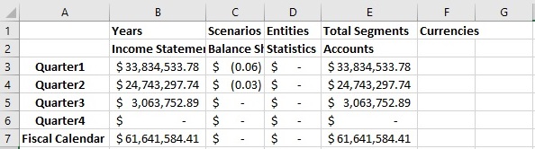

Basic Ad Hoc Grid
In the example below, the sheet contains only a basic ad hoc grid. There are no formulas, functions, pasted data points, referenced cells, or other Smart View or Excel elements on the sheet.
Supported by: EPM Cloud, Narrative Reporting
A basic ad hoc grid.

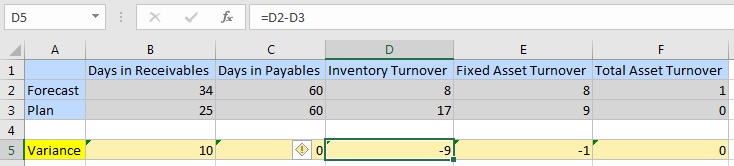

Ad Hoc Grid with Formula
You can place formula cell outside of the grid. In the example below, cell B9 contains a formula.
An ad hoc grid with a formula cell outside of the grid.

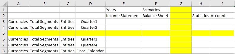

Ad Hoc Grid with Blank Rows and Columns
You may use blank rows and columns with a grid.
An ad hoc grid with a blank row and a blank column running through the center of the grid. There is no data on the grid.

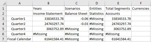

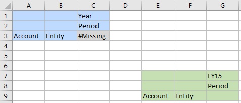

Multiple Ad Hoc-Grids on a Single Sheet
The multiple ad hoc grids on a single sheet scenario is not supported.
Shows two ad hoc grids on a single sheet, which server refresh does not support.

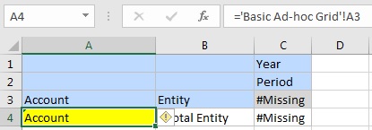

Grid with Referenced Member
This grid contains a member (cell A4) referenced as a formula from another sheet.
An ad hoc grid in cells A1 to C3, with a referenced member in cell A4.

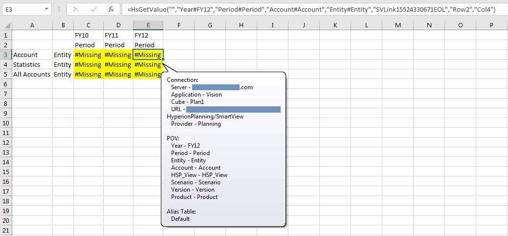

Grid Containing Pasted Data Points
This grid, based on an EPM Cloud data source, contains a cell range (cells C3 to E5) consisting of pasted data points. The data points can be copied from another sheet within the same workbook or from a different workbook. The data source for the data points could be based on the same data source as the original sheet, or a different data source.
An ad hoc grid with pasted data points. Hover over a data cell and we see the connection and POV info for the cell.
Function-Only Grid
This grid contains two functions, both based on an EPM Cloud data source. Sheets may contain functions based on different support data sources.
Grid contains only Smart View functions. Cell A1 is selected and the formula bar shows the formula for an HsGetValue function.

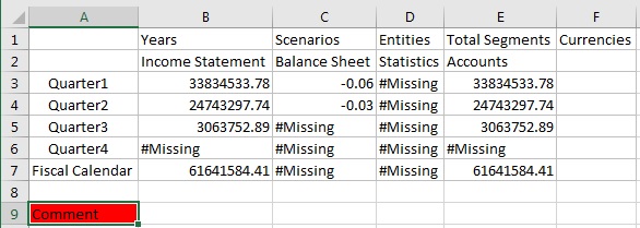

Form with Comment and Formula Cells
This grid, based on an EPM Cloud data source, contains both comment cells and formula cells in row 5. Notice that the comment cell and formula cells are placed below the form. Sheets containing a form may contain either comment cells, formula cells, or both.
An ad hoc grid with both comment cells and formula cells below (outside) the grid.

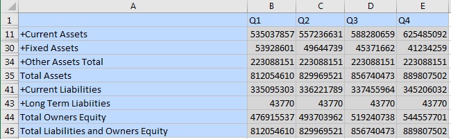

Formatted Ad Hoc Grid
An ad hoc grid using some Excel formatting, such as bolding, dollar signs, commas for the thousands separator, and decimal points.
