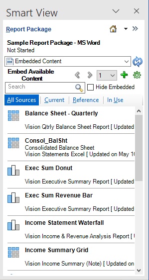

                     In the Report Package panel, select
                        Embedded Content from the drop-down menu (see Figure 23-29.
Figure 23-29 Embedded Content Option Selected in the Report Package Panel
The Embedded Content panel is displayed.
Figure 23-30 Embedded Content Panel
In the Embedded Content panel, all available content is listed.

                     In the Embedded Content panel, locate the
                    available content to embed.
You can use these methods to help you locate the available content:
Use the Search field. If you know the name or portion of the name of the available content, type the string to search on in the Search field, then click
Wildcards are not required. Narrative Reporting searches for the term any where in the available content name.
Click
 to cancel the search.
Scroll down the panel. If there are multiple pages of available content, use the Page Number drop-down menu to jump to the other pages.
With either method, you can use filters—All, Current, Reference, or In Use—to narrow your search:
All Sources—Includes available content sourced from reference doclets and Reports
Current—Displays available content from any reference files that are registered with the current doclet.
Reference—Includes available content sourced from the reference doclets in the report package.
In Use—Includes available content that is in use in the currently-opened doclet.

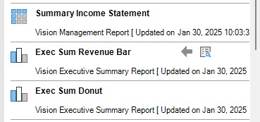

                     From the list, select the available content to insert.
When you select an available content in the list, the Insert button,
, is displayed, as shown in Figure 23-31.
                        Figure 23-31 Available Content Selected with Insert and Preview Buttons Displayed
                     Click
 to insert the available content in the target doclet at the point you
                    selected point in step 3.
