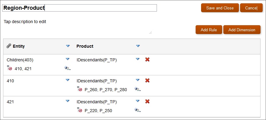

Valid intersection rules are set up by Planning administrators in the Planning web application. In Figure 8-6, valid intersection rules are set up as follows.
  • When the 403:Sales member is selected in the Entity dimension, all products in the Product dimension are available for selection.
  • When the 410:International Sales member is selected in the Entity dimension, then the members P_260:Game, P_270:Camera, and P_280:Television are not available for selection. All other members are available for selection.
  • When the 421:Sales NorthEast member is selected in the Entity dimension, then the members P_220:Software Suite and P_250:Network Card are not available for selection. All other members are available for selection.
Figure 8-6 Valid Intersections Rules Constructed in Planning Web Application
Shows the valid intersection construction interface in the Planning web.
