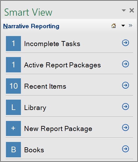

  7. If the Narrative Reporting Home panel is displayed, select Library to launch the Smart View Panel (if the Home panel does not display, skip to the next step).
    Shows the Narrative Reporting Home panel, providing access to the items that require user attention and access to recently accessed items as well as the Narrative Reporting Reporting Library node.
    The Narrative Reporting Home panel will display if you have already installed the Narrative Reporting extension, and are creating other connections to Narrative Reporting. For example, an administrator may be creating connections to a test environment and to a production environment.
