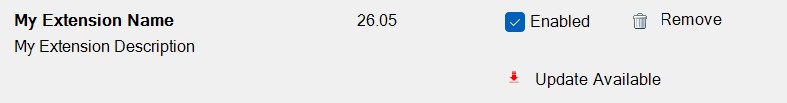

    The following is an example of an extension displayed in the Extensions tab.
    An extension as it appears in the Extensions tab
