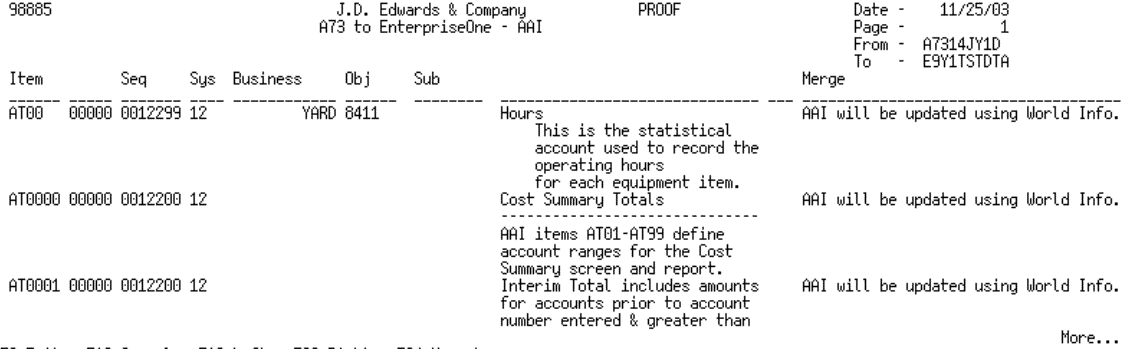

This graphic describes the AAI Merge Program

The third processing option allows you to run the program in either proof mode or final mode.
Whether you select proof mode or final mode, a report is produced which shows what action was taken (final mode) or would be taken (proof mode) for each AAI.
