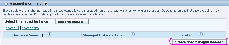

Select the Managed Home in which you wish to install the Business Services Server.
In the Managed Instances section of the page, click the Create a New Managed Instance button.

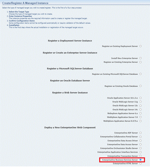

On Create/Register a Managed Instance, Instance Type, select this radio button:
EnterpriseOne Business Services Server

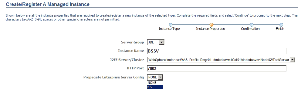

On Create/Register a Managed Instance, Instance Properties, complete these fields:
Server Group
Use the dropdown to select the Server Group to which you want this instance to belong.
Also refer to Administer Server Groups.
Instance Name
Enter a name for the instance.
Tip:A good business practice is to name your instances so that they are easily and consistently identifiable. For example:
PRODUCT_SERVER_PORT
where
PRODUCT
is the JD Edwards EnterpriseOne server type, such asEnterprise_Server, HTML_Web_Server, RTE_Transaction_Server, Collaborative_Portal
, orBusiness_Services
, andwhere
SERVER
is the machine on which the instance is installed, andwhere
PORT
is the HTTP port which is defined for use by this server.J2EE Server
Use the dropdown to select a valid J2EE server.
Ensure the J2EE Server that you choose is a secure WebSphere 7.0 or 8.5 profile (releases prior to 7.0 are not supported). Otherwise, Server Manager will not allow you to continue the installation.
HTTP Port
You must ensure that the port that you specify is available and is not being used by any other application currently installed and running on the server on which the application server is running.
Propagate Enterprise Server Config
Select the enterprise server from the drop-down list to propagate the configurations.
Note:By default, the selected item is set to NONE. Selecting NONE signifies that you do not wish to propagate configurations from any available enterprise server. If any enterprise server is selected, all the inherited values are seen in the next screen, otherwise the properties are seen with blank/default values. If propagated, the propagated values are not editable on the confirmation page, however, they can be modified post installation.
Click Continue.

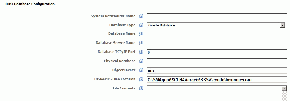

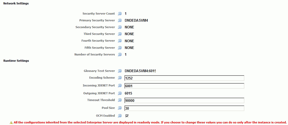

Note:This example illustrates an installation by selecting an enterprise server to be propagated.

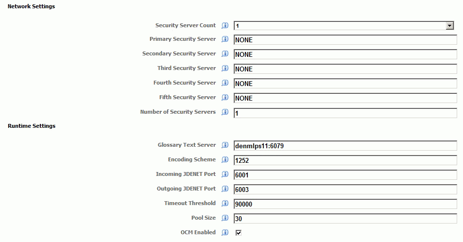

Note:This example illustrates an installation by selecting NONE under Propagate Enterprise Server Config.

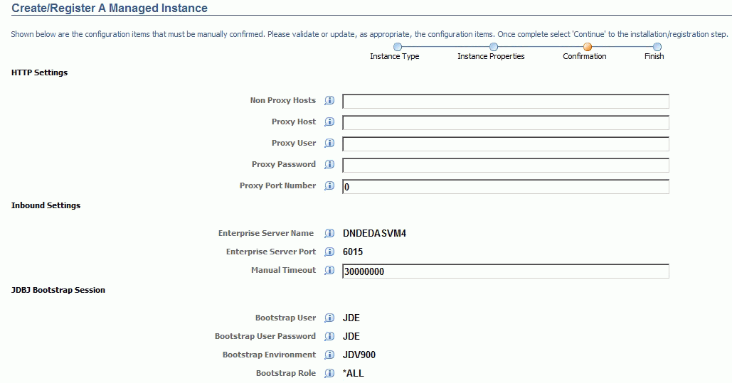

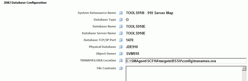

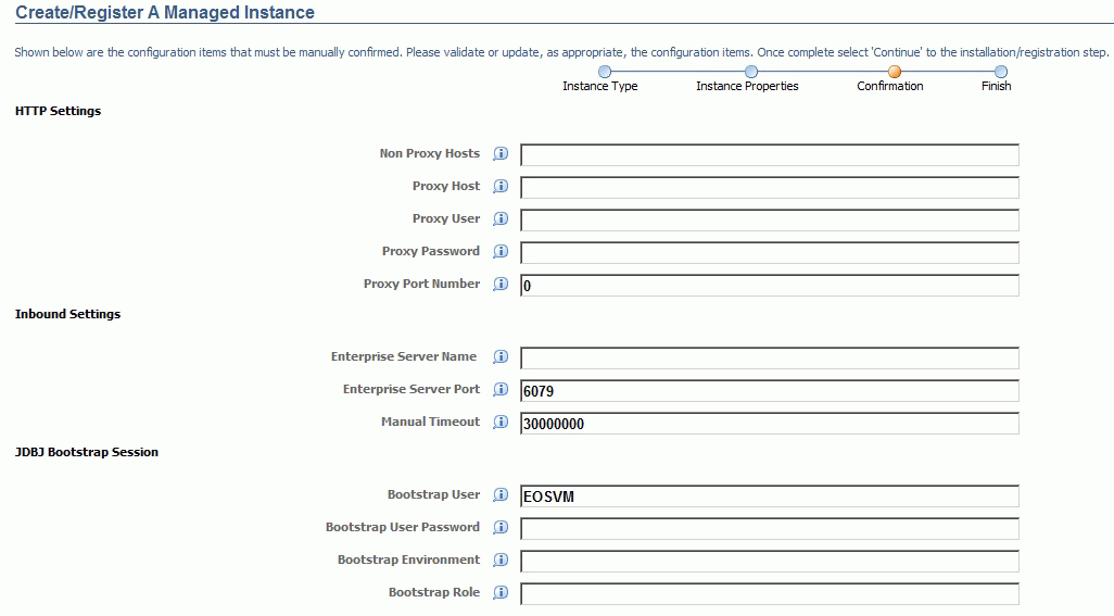

On Create/Register a Managed Instance, Confirmation, review the key configuration items. The values on this form must be confirmed manually. You must validate or update, as appropriate, all configuration items.
Tip:For help, click the Information icon next to the title of a field.
After you have validated and updated all configuration items, click Continue to proceed to the next installation step.

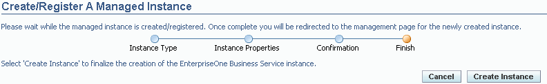

On Create/Register a Managed Instance, Finish, click the Create Instance button to complete the installation of the Business Services Server.

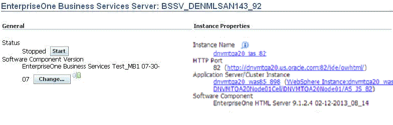

After you have completed the installation, the browser is redirected to the Management Console page for the newly created Managed Instance. This Managed Instance also appears as a Managed Instance in the corresponding Managed Home.
Note:After you have created the EnterpriseOne Business Services Server Managed Instance, unlike all other web-based server products it does not start automatically. This is because the Managed Instance is not functional until the Business Services components are installed in it through the special JD Edwards EnterpriseOne package build process designed for that product. Refer to the JD Edwards EnterpriseOne Tools Release 9.2 Package Management Guide.
For each registered Managed Instance, the Management Console displays appropriate information at the top of the page:
General
Status
Valid values are:
Running
When the status is Running, the Stop button is available.
Stopped
When the status is Stopped, the Start button is available.
Software Component Version
Displays the version of this Software Component.
Instance Properties
Instance Name
The name assigned to the Managed Instance at the time it was created or registered.
HTTP Port
Displays the HTTP Port for this server and also provides a link to the HTTP server.
Application Server Instance
Displays the application server into which this EnterpriseOne server is installed and also provides a link to the application server instance and associated WebSphere Application Server profile.
