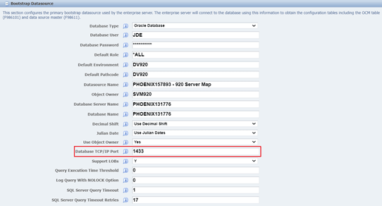

Navigate to Enterprise Server Instance > Configuration > Advanced > Database > Bootstrap Datasource. Enter the secured port number in the Database TCP/IP Port field.
The Database TCP/IP Port field is not applicable to AS/400 database and is not displayed when AS/400 database is selected.
This image shows the Database TCP/IP Port field
Note: You must update the Database TCP/IP Port field for IBM UDB and Oracle Database. However, AS/400 and MS SQL Server have default Database TCP/IP Port and updating the Database TCP/IP Port field is not required.

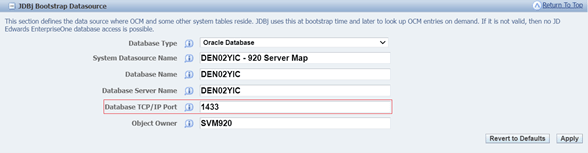

Navigate to Enterprise Server Instance > Configuration > Advanced > Java Runtime Properties > JDBj Bootstrap Datasource. Enter the secured port number in the Database TCP/IP Port field.

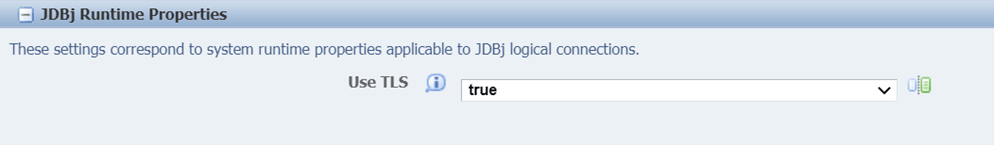

Navigate to Enterprise Server Instance > Configuration > Advanced > Java Runtime Properties > JDBj Runtime Properties. Use the drop-down menu to select true for the Use TLS field.
This image shows the Use TLS field
Note: The Use TLS configuration is not applicable to Oracle Database.
