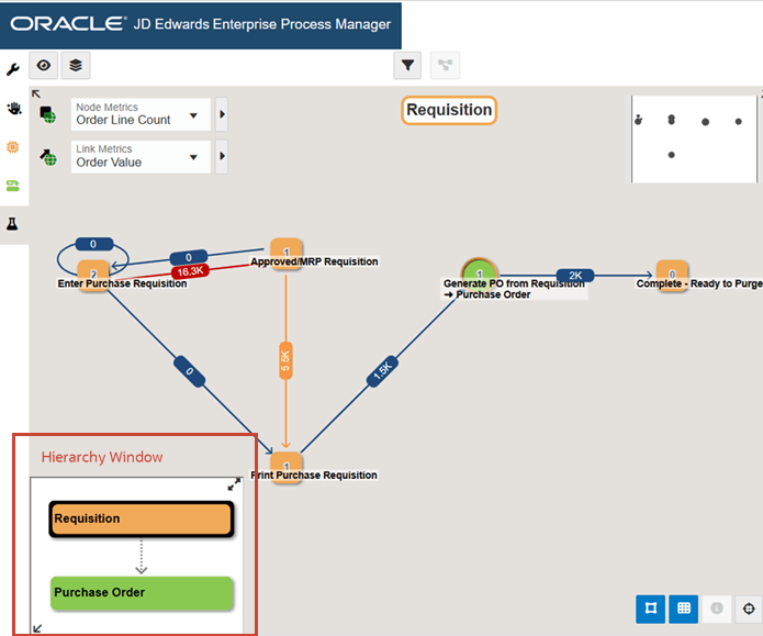

Starting with Tools Release 9.2.9.3, if the process model includes subprocesses, you can preview both the parent and the subprocesses using the Preview tab. In this case, the system displays the Hierarchy Map window showing the hierarchy between the processes in the Preview tab. You can drag and drop this window to resize it. You can also use the Hide Hierarchy Window icon or Show Hierarchy Window icon as per your preference.
Note: You can select the color themes for the parent and subprocesses while creating the process.
In following example, the parent and subprocesses are displayed based on the selected color themes. The subprocess is indicated by the circular node in green (Purchase Order).
You can right-click this node and click Open Child Process to open the child process window.
For example, in the preconfigured template for the Requisition process, Requisition is the parent process, and Purchase Order is a subprocess.
In the Hierarchy window, you can click the Requisition (in orange color) to preview the parent process, and you can click the Purchase Order(in green color) to preview the child process. To indicate that the parent process is displayed as a preview, the system displays a dotted arrow to the child process. To indicate that the child process is displayed as a preview, the system displays a prominent arrow to the child process.This image is described in surrounding text.

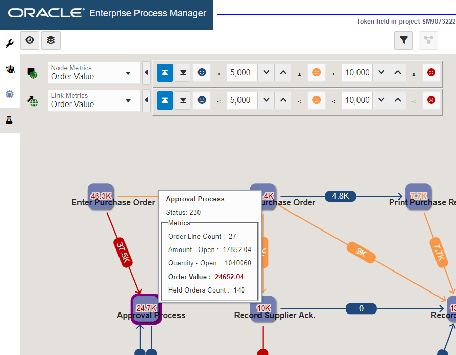

    1. Hover over the node to view the status code and metric details on the hover form. On the hover form, the field selected in the Node Metrics drop-down list is displayed in bold and its value is displayed in the threshold color.
      In the following example screenshot, you can see that the Order Value is selected in the Node Metrics drop-down list. The value is displayed in red, since it exceeds the threshold value.

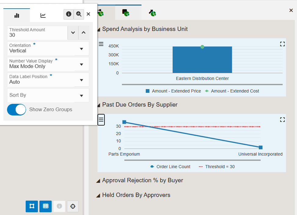

    Starting with Tools Release 9.2.26.0, the Configure window displays the Chart Configuration and Series Configuration tabs. The fields displayed on these tabs depend on the chart type (bar or pie chart) and source (aggregation, orchestration, or logic extension) of the analytics charts. The Configure window also displays the Show Query Details and Drill into Data options.
    Note: Starting with Tools Release 9.2.26.0, the Stack Series option is displayed on the Series Configuration tab (instead of Chart Configuration), and this option is available only for bar, line, area, and combined charts (not the pie charts).
    1. On the chart, click the Configure icon This image is described in surrounding text.and enable the Stack Series option if you want to view the bar chart or pie chart in the stack chart format .
    2. Select the values as required in the Configure window for the charts such as Orientation (Vertical or Horizontal; available for all charts except Pie charts), Number Value Display (Never, Always, or Max Mode Only) and so on. In the Process Analytics tab, you may see the fields such as Threshold Amount, or Alert Limit displayed in the Configure window depending on the design of the analytic.This image is described in surrounding text.

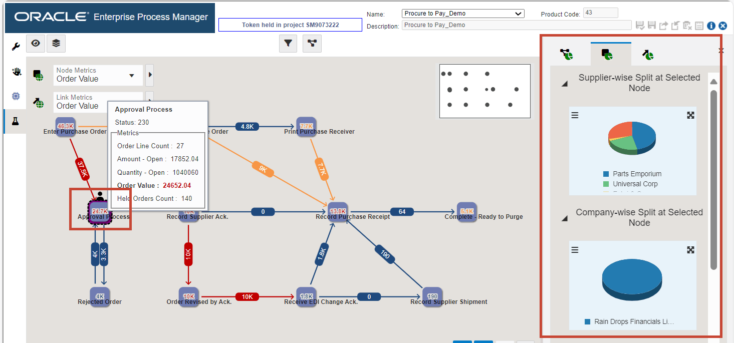

  5. Click the node to view the node-specific analytics in the Node Analytics tab on the right.
    The system displays a People icon and a border to indicate that the node is selected. The system displays a dashed border (with a "marching ants" effect) around the node when you hover over a selected node.
    The image is described in the following text.

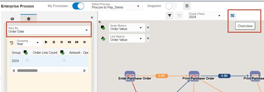

  8. Click the Show Analytics Options iconThis image is decribed in surrounding text.. Select the values from the View By drop-down list. The values displayed in this drop-down list are based on the selected template. If you select an option other than Overview, either a Timeline view (for Date and UTIME data types) or a Domain view (for other data types) is displayed. You can make changes to the node and link metrics in the Timeline and Domain views. The system displays the corresponding changes in the analytics tab on the right.
    (Tools Release 9.2.9.3) If you select an option other than Overview, the system displays the Overview icon next to the Group drop-down list. Click this icon to reset the value in the View By drop-down list to Overview.
