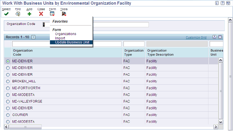

You must perform the following setup steps in the JD Edwards EnterpriseOne Environmental Accounting and Reporting application:
Setting Up User Defined Codes for Environmental Accounting and Reporting (P0004A)
Mapping an Environmental Organization to a Business Unit (P79A76)
Setting Up Suppliers (P79A02). This is an optional step, unless you plan to create vouchers.
After completing the setup steps above, perform the following two steps in order to generate EAR reports:

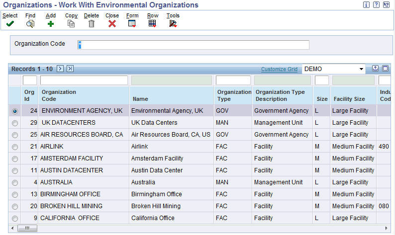

An Environmental Organization can be defined as a single undertaking or an enterprise or any entity that performs activities or a series of activities that emit greenhouse gases and/or produces, or consumes energy at a single site and is attributable to a single industry sector. An organization can have multiple hierarchies for reporting, for example, government reporting hierarchy, operational hierarchy, or legal structure hierarchy. In addition an organization can be a division, company subsidiary, or operation.
The Work With Environmental Organizations form enables you to create organization entities that are required for hierarchical reporting of emission information. These entities can be facilities, sub-facilities, aggregate facilities and so on for reporting aggregation and government agencies that may be interested in data related to an organization. An organization also needs to identify the multiple parties involved in an organization. The involvement of a party could be from a control or reporting perspective. Control can be either operational, financial, or equity. Under the GHG Protocol, reporting organizations are recommended to select one of the following control options:

Navigate to the Work With Environmental Organizations form.

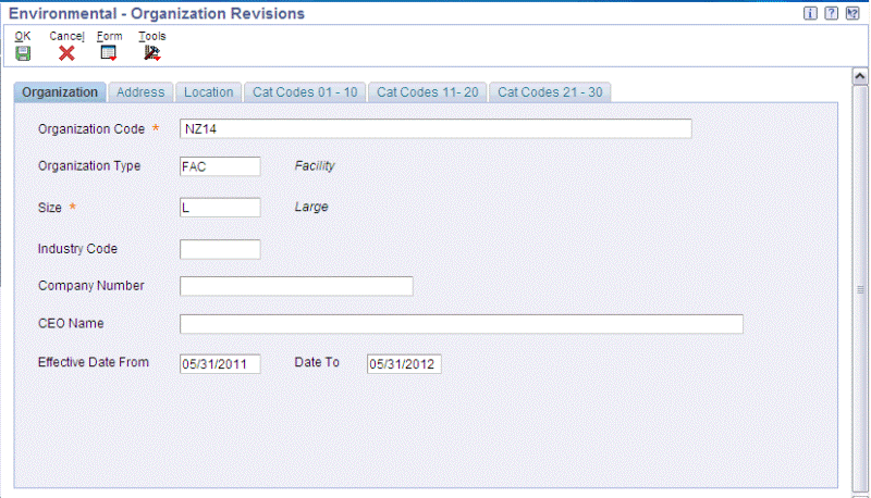

Click Add. The Environmental - Organization Revisions form appears and defaults to the Organizations tab.
In the Organization Code field, enter a required code for the organization.
Select the type of the organization from user-defined code table 79A/OT. Valid options are:
Aggregate Facility: This is a logical facility that acts as a container for many smaller facilities.
Facility: This is a main container for collecting emission transactions.
Government Agency
Joint Venture
Management Unit
Organization
Partnership
Sub-facility
In the Size field, enter a required value for the size of the company from user-defined code table 79A/FS. Valid values are Large, Medium, and Small. Facility specific reporting requirements apply according to the size of a facility, which is determined by facility-level thresholds.
Note: The amount of pollution created determines the size of the company, not the physical size, market value, or quantity of goods produced.
Select the Industry Code and the Company number for the company. Industry Code is the standard industry code for the organization.
Note: The Size, Industry Code, Company Number, CEO Name, Effective Date range, Latitude, Longitude, Location and Category Codes are used in Business Intelligence Analysis and Reporting.
Enter the Name of the CEO of the company.
Enter the Effective Date From and Date To as the date range in which the company is effective. These dates are automatically populated if you do not enter a value. The Date From field defaults to the current date. The Date To field defaults based on the CENTCHG DD (Century Change Year) item and reflects the last day of the year defined in that field.
Click the Address tab.
Optionally, select an address in the Address Number field. To select an address:
Click Search in the Address Number field. The Address Book Master Search form appears. Search by Name or Type and select the address number. Click Select. When you select an Address Number, the details appear in the Address Details region if the details have been entered previously. or,
Enter address details if you do not select an Address Number or if the Address Number selected has no details.
Note: Selecting the Address by Effective Date option in JDE's Address Book Constants enables the Previous and Next buttons in the Address tab. Use the Previous and Next buttons to enter address details for multiple addresses with different effective dates.
Select the Location tab.
Enter the Latitude, Longitude and the Location of the organization. Latitude and Longitude provide the GPS coordinates for the organization. Location is the location of the organization. This information is used for BI reporting.
Select the Cat Code tab.
Enter the Organization Codes for the organization. You can enter up to 30 organization codes.
Click Ok to save.
The system creates an Org Id. Org Id is the unique identifier for the organization.

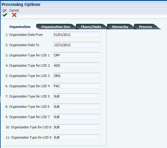

During the organization creation process, the Import Organizations from Real Estate Management program automatically maps the new organization to the business unit used to create the organization. For more information about the mapping process, refer to Mapping an Environmental Organization to a Business Unit (P79A76).
Navigate to the Work With Batch Versions - Available Versions form. Search for and select a version of the Import Organizations from Real Estate Management program.
Navigate to the Processing Options form (Row > Processing Options). Set the following processing options, then click OK. Refer to "To set up an organization:" above for detailed information about any fields represented by these processing options.
Tip: The Processing Options form opens automatically later, after you select a program version to run. You can update the processing options at that time, too.
Organization tab
Organization Date From/To - The date range for which the organizations created from Real Estate Management are valid.
Organization Type for LOD 1, 2, etc. - Specify the type of the organization from user-defined code table 79A/OT. When importing from Real Estate Management, LOD 1 represents the company, LOD 2 represents the business unit, LOD 3 represents the floor, and LOD 4 represents the unit. If LOD 3 or 4 is not defined, then the Organization Type defaults from the parent LOD for the floor and unit.
Organization Size tab - Provide the default size of the organization from user-defined code table 79A/FS. Valid values are Large, Medium, and Small. The size defaults to Medium if no size is defined for a particular LOD. For floors and units, the size defaults from the parent LOD.
Floors/Units tab - Specify whether or not to create organizations based on floor and unit information.

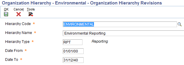

Hierarchy tab - Select the top level Hierarchy Code to use from the list of existing Hierarchy Codes.
For more information about hierarchies, refer to Defining an Organization Hierarchy (P79A70).
Processing tab - Select whether to run the batch in proof or final mode. Proof mode enables you to run the batch and determine if there are any data issues, without committing any data to the database. Final mode commits the data to the database where possible. Any errors encountered during the batch run are displayed.
Double click a version of the Import Organizations from Real Estate Management program or select a version to run it.

The Processing Options form opens. Change processing options as needed, then click OK.

To add or edit organizations or facilities that Control Me
Select the controlled organization.
Select Control Me from the Row menu. The Environmental - Organizations Controlling Me form displays. The Controlled Organization / Type display.
Enter the code for the organization that controls the current organization in the Organization Code field. The Organization Type, Organization Type Description, Org Date From and Org Date To fields default to the values defined for the selected organization.
Select the Control Type that the selected organization has in the current organization. Required. The Control Type Description displays.
Enter Control % as the percentage of interest that the selected organization has in the organization.
Enter Date From and Date To as the effective date range for the selected organization’s control in the organization.
Controlling Org Id is the identification number of the controlling organization.
Org Id displays the identification code of the organization selected.
Click Ok.

To view My Hierarchy
Select the organization for which you want to view the hierarchy.
Select My Hierarchies from the Row menu. The Environmental - My Hierarchies form displays.
The following fields display:
Hierarchy Code is the code for the hierarchy.
Hierarchy Name is the name for the hierarchy.
Immediate Parent Organization Code is the code for the parent organization.
Hierarchy Id is the identification number for the hierarchy.
Parent Org Id is the identification code for the parent organization.
Org Member Hierarchy Id is a unique identifier for the relationship between the parent and child organizations within the hierarchy.

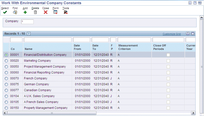

To set up EAR company constants
Navigate to the Work with Environmental Company Constants form.
Click Add. The Environmental - Company Constants Revisions form displays.
In the Company field, search for a company for which you want to define EAR constants. The Company Master Search form appears. Select a company from the list of companies available and click Select.
Enter Date From and optionally a Date To as the date range for the Company and related Business Units set up in the Business Unit Master to create environmental Ledger transactions. Set the From Date to the earliest date in which historical environmental data is loaded. If left blank, the Date To field defaults to the last day of the year defined in the CENTCHG DD (Century Change Year) item field.
Select the Date Pattern as the period and year that you want the application to allocate to the environmental transactions. Click Search in the Date Pattern field. The Select User Defined Code form appears. Select the required Date pattern. If you set the Date Pattern, then the Environmental Company Constants application allocates the period and year to the environmental transactions regardless of the financial year that applies to the organization’s accounting transactions.
Select the Measurement Criterion for the company. Click Search in the Measurement Criterion field. The Select User Defined Code form appears. Select the required measurement criterion. This is required only for Environmental Ledger entries created using the Accounts Payables application. Refer to “Setting Up UDCs” topic for more information.
In the Close Off region, select the Close Off checkbox if you want the application to prevent Ledger transactions being generated on or prior a specific date. If you select the checkbox the following fields are enabled:
Current Year / Period
Close Off Date displays
In the Plant Equipment Business Unit region, select the Use Plant Equipment BU if you want to specify a business unit as the ‘destination business unit’ during inventory processing. The destination business unit also holds the link to the state and country based on which the GHG calculation are applied. Select:
Responsible Business Unit, if you want the application to use the state and country of the business unit of the equipment in environmental calculations.
Site Location, if you want the application to use the state and country of the current location of the equipment in environmental calculations.
Click Ok to save.
To view environmental company constants
The following fields display for a company for which constants are defined.
Co is the code for the company.
Name is the name of the company.
Date From and Date To is the effective date range for the company.
Fiscal Pattern (FP) is the date pattern that you wish to use for this company.
Measurement Criterion indicates the reliability of information that is related to the transactions.
Close Off Period displays as checked if Ledger transactions for the company are prevented from being generated on or prior a specific date.
Current Year displays the current year.
Current Period displays the current period.
Close Off Date is a date after which ledger transactions are prevented for the company. It is also the last day of the fiscal year and period, as selected in the Current Year and Current Period fields.
Use PE BU displays as checked if a destination business unit is specified for all transactions of the company.
Plant BU displays as:
L- Asset location
R- Responsible Business Unit
Plant Business Unit.
Cur Code is the code for the currency used by the company in its transactions.
Address Number is the address code of the company.
To update company constants
Select the Company for which you want to update information.
Click Select. The Environmental - Company Constants Revisions form appears.
You can edit the following fields:
Date To
Date Pattern
Close Off Periods (including Current Year / Period and Close Off Date)
Click Ok to save.

Updating the Organization to Business Unit Mapping
You can also update Business Unit mappings for an organization. To update a mapping:
Navigate to the Work With Business Units by Environmental Organization Facility.
Select Update Business Unit from the Form menu. The Update Business Unit With Environmental Organization Facility form appears.
In the Header region, enter Organization Code/Ty to view business unit mappings of a specific organization. When you enter the Organization Code/ Ty, then the following fields display:
Industry code is the industry code for the organization.
Apply Date From and To as the effective range for the organization to business unit mapping.
Click Find. The Details region displays a list of all business units mapped to the organization and also the unmapped business units. Information displays for each business unit to organization mapping as described in the “Viewing Existing Mappings” topic.
Select the unmapped business unit or business units that you want to map to the organization.
Click Update BU Facility. The Organization Code field displays the Organization Code of the organization selected in the Header region of the form.
Click Save.

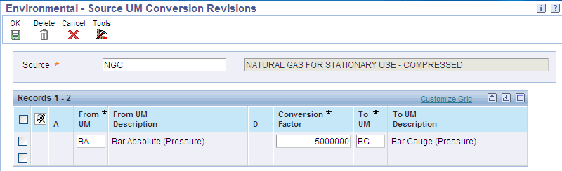

Setting Up UM Conversion for a Source
You can set the UM conversion for a source using the Work With Environmental Source UM Conversion form. To set the UM conversion for a source:
Navigate to the Work With Environmental Source UM Conversion form.
Click Add. The Environmental - Source UM Conversion Revisions form appears.
In the Source field, select the emission source for which you want to set up the UM conversion. Required.
In the From UM field, select the unit of measure that you want to convert. Required. The description of the selected UM displays in the From UM Description field.
Enter the Conversion Factor that must be applied to From UM to convert into To UM.
In the To UM field, enter the unit of measure that you want the From UM to convert into. Required. The description of the selected UM displays in the To UM Description field.
Click Ok to save.

To create an organization hierarchy:
Navigate to the Environmental Organization Hierarchy form.
To create a hierarchy, click Add from the menu. The Environmental - Organization Hierarchy Revisions form displays.
Enter a value in each of the following required fields:
Hierarchy Code - enter a unique value.
Hierarchy Name - enter a descriptive name for the organization hierarchy.
Hierarchy Type - select one of the following Hierarchy Types from the user-defined table 79A/HT:
FIN - Financial
OPR - Operational
RPT - Reporting
Date From and Date To - enter the effective date range for the hierarchy.
Click Ok to save.
Click Find. The left pane of the form displays a list of existing hierarchies.
To view the details of a hierarchy, select the hierarchy record from the list of existing hierarchies or enter the name of the hierarchy in the Hierarchy field and search. The information for the selected hierarchy displays in the right pane of the form and is categorized under the following tabs:

To edit information for the hierarchy or add a new hierarchy, click Edit or Add. The Environmental – Organization Hierarchy Revisions form appears. Refer to the “Adding Organizations to a Hierarchy” topic for detailed information. To delete the hierarchy, click Delete. Refer to the “Deleting a Hierarchy”topic for detailed information.
Selection: When you select the Selection tab, a list of available organizations displays. You can select an organization and click the left arrow that adds the organization below the selected hierarchy or organization in the tree. You can also search for specific organizations to add using search criteria. Refer to the “Adding Organizations to a Hierarchy” topic.
Organization: The Organization tab displays the details of the EAR organization, when you select an EAR organization on the left pane of the form. The following fields display:
Code is the code for the organization.
Type is the type of the organization
Size is the size of the organization.
Business No. is the contact number of the organization.
CEO Name is the name of the CEO of the organization.
From and To is the effective date range for the organization.
Line 1, Line 2, Line 3, Line 4, City, County, State and Country provide the address of the EAR organization.
To edit information for the organization or add a new organization, click Edit or Add. The Environmental Organization Revisions form appears. Refer to the “Setting Up Environmental Organizations” topic for detailed information.
My Interests: When you select an EAR organization on the left pane of the form, the My Interests tab displays the details of the organizations that the selected organization is interested in. You can click Edit to access the Environmental - My Interests form and add organizations of interest. Refer to the “Setting Up EAR Organizations” topic for detailed information.
Interested in Me: When you select an EAR organization on the left pane of the form, the Interested in Me tab displays the details of the organizations interested in the selected. You can click Edit to access the Environmental- Interested in Me form and add interested organizations. Refer to the “Setting Up EAR Organizations” topic for detailed information.
I control: When you select an EAR organization on the left pane of the form, the I Control tab displays the details of the organizations controlled by the selected organization. You can click Edit, to access the Environmental- Organizations I Control form to add organizations to control for the selected organization. Refer to the “Setting Up EAR Organizations” topic for detailed information.
Controlling Me: When you select an EAR organization on the left pane of the form, the Controlling Me tab displays the details of the organizations that control the selected organization. You can click Edit, to access the Environmental - Organizations Controlling Me form to add organizations controlling the selected organization. Refer to the “Setting Up EAR Organizations” topic for detailed information.
My Children tab displays a list of child organizations for an organization hierarchy. You can click Edit to access the Environmental- My Children form to add or edit child organizations to the organization hierarchy.
My Hierarchies tab displays a list of hierarchies that the selected EAR organization belongs to.
To add organizations to a hierarchy:
Navigate to the Environmental - Organization Hierarchy form. The left pane displays a list of existing hierarchies display.
Select the hierarchy to which you want to add organizations. The hierarchy details display on the right pane of the form.
Select the Selection tab. A list of available organizations display.
Select the organization that you want to add to the hierarchy and click the left arrow. This adds the organization below the selected hierarchy or organization in the tree.
Search for specific organizations to add to the hierarchy by entering the following criteria:
Organization Type.
Effective Date .
Organization Code.
To delete a hierarchy:
Select the hierarchy you want to delete and click Delete.
Editing a Hierarchy
To edit a hierarchy:
Select the hierarchy record from the list of existing hierarchies or enter the name of the hierarchy in the Hierarchy field and search.
Click Select menu option. The Environmental - Organization Hierarchy Revisions form displays. Edit the effective date range for the hierarchy by entering new dates in the Date From and Date To fields.
Click Ok to save.
