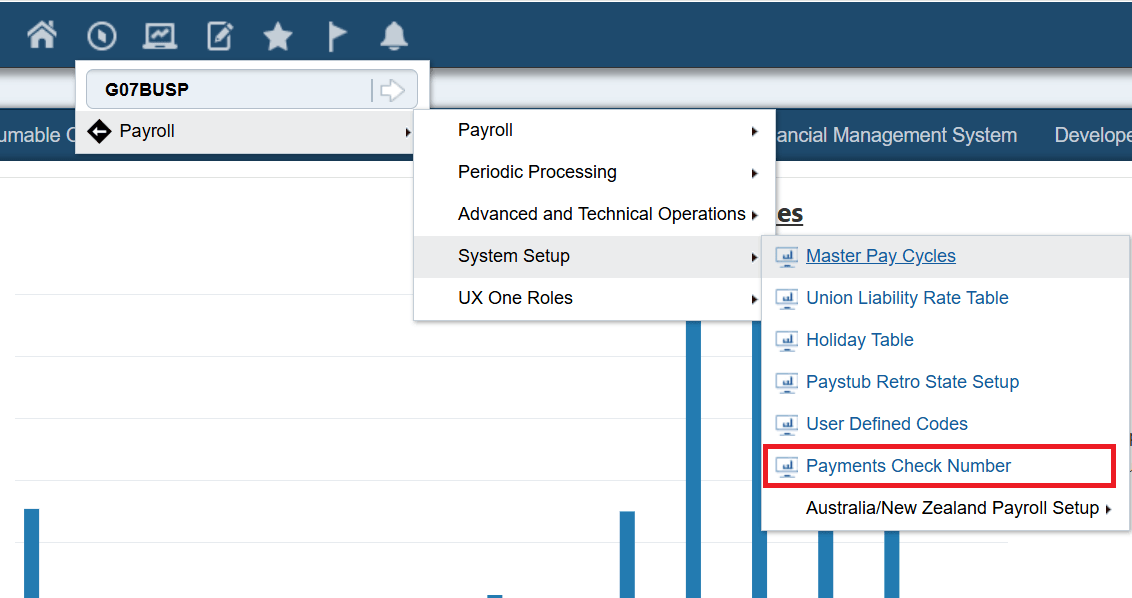

  1. In the Navigator (Fast Path), enter G07BUSP (Payroll). From the Payroll menu, select System Setup, and then select Payments Check Number.
  2. Description of sample-arch-image.png follows
    Payments Check Number Program - Navigation

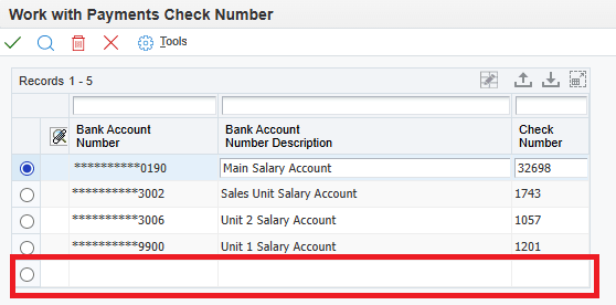

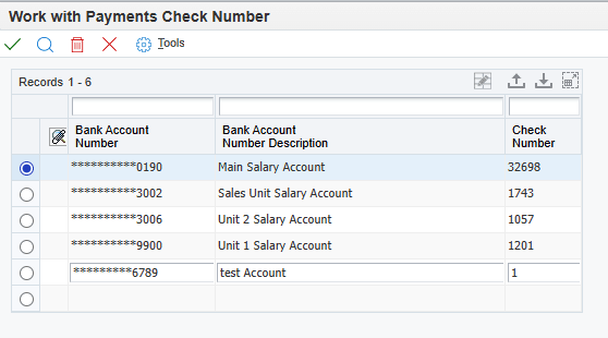

  3. Enter the bank account number, description, and check number details in the last row to create a new bank record.
  4. Description of sample-arch-image.png follows
    Payments Check Number Program - Create Bank Record
  5. Click OK to save the record to the Print Payments Check Number Setup (F07237) table.
    • You can add multiple records at one time in this form.

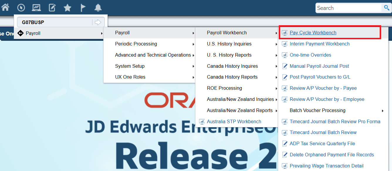

  1. In the Navigator (Fast Path), enter G07BUSP (Payroll). From the Payroll menu, Payroll Workbench, then select Pay Cycle Workbench.
    Pay Cycle Workbench - Navigation

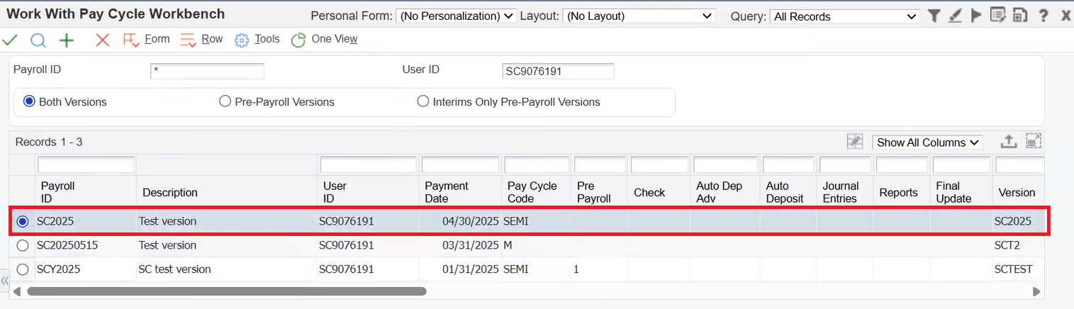

  3. Select the Payroll ID from the list for check printing.
    Pay Cycle Workbench - Select Payroll ID

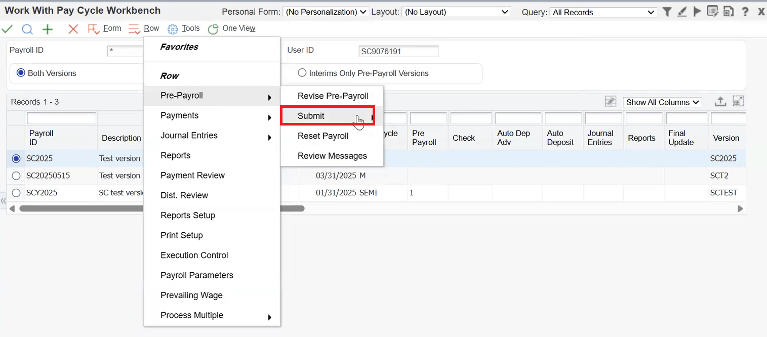

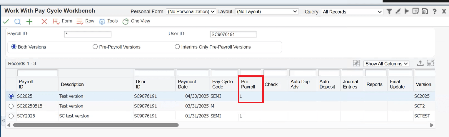

  5. From the Row menu, select Pre-Payroll and click Submit.
  6. Description of sample-arch-image.png follows
    Pay Cycle Workbench - Payroll ID Submit
  7. When submitted, the status on the Pre-Payroll column updates to indicate the payroll ID is processed.
  8. Description of sample-arch-image.png follows
    Pay Cycle Workbench - Pre-Payroll Processed
    NOTE: If Pre-Payroll is not run, the subsequent payment print steps will not be available.

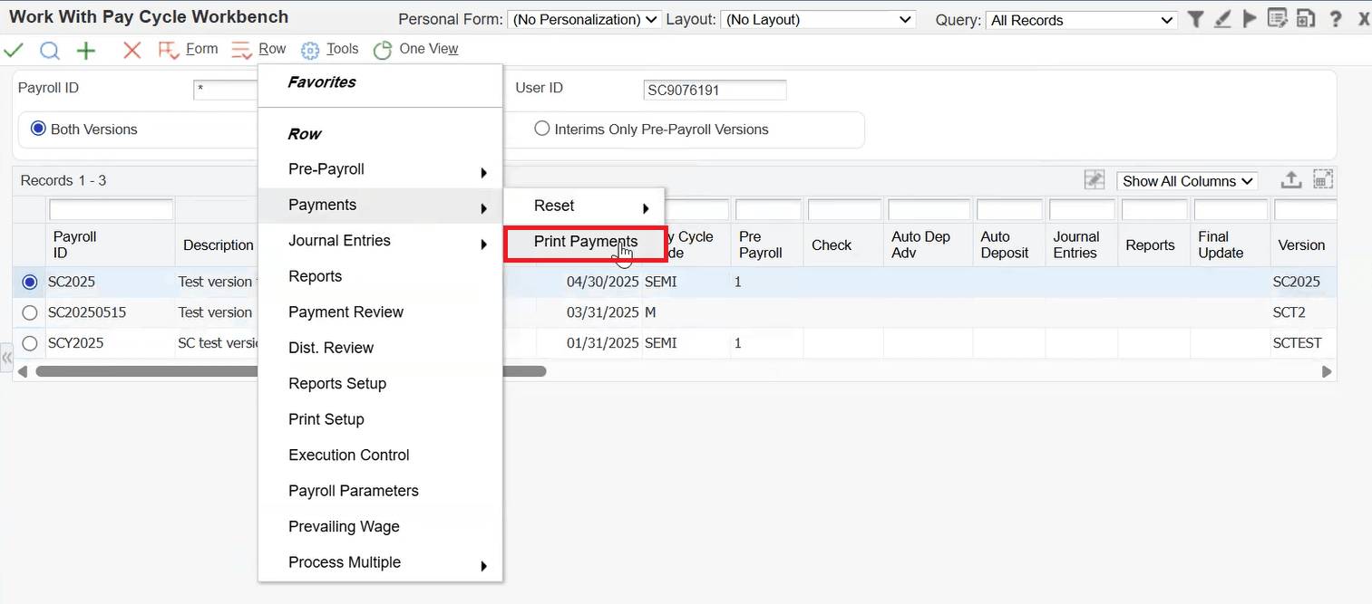

  9. Then from the Row menu, select Payments, and click Print Payments.
  10. Description of sample-arch-image.png follows
    Pay Cycle Workbench - Print Payments

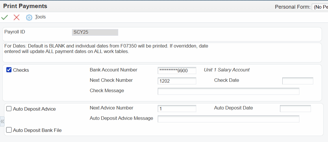

  11. In the Print Payments form, select the Checks checkbox.
  12. NOTE: If the Checks checkbox is deselected, the check printing is not initiated.
    Print Payments form

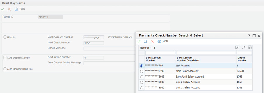

  13. Select the Bank Account Number using the Visual Assist for printing checks.
  14. Description of sample-arch-image.png follows
    Pay Cycle Workbench - Visual Assist
  15. To edit the next check number you want to print, select the respective Bank Account Number, edit the Check Number field with the number you want to print as next check number, and click OK to save.
  16. Report output of Print payments will now have check number set in P07200 app.
  17. Review the settings and click OK. The system prints checks with sequential numbers as defined.

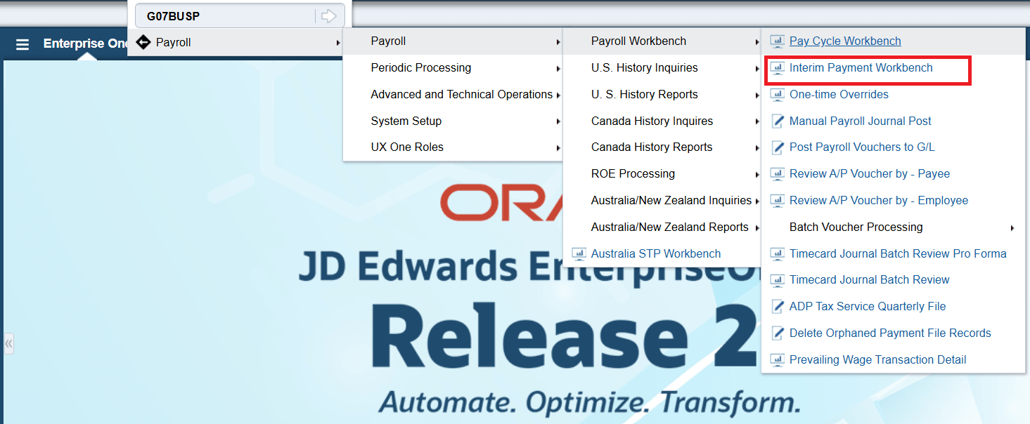

  1. In the Navigator (Fast Path), enter G07BUSP (Payroll). From the Payroll menu select Payroll Workbench, then select Interim Payment Workbench.
    Interim Payment Workbench Program - Navigation

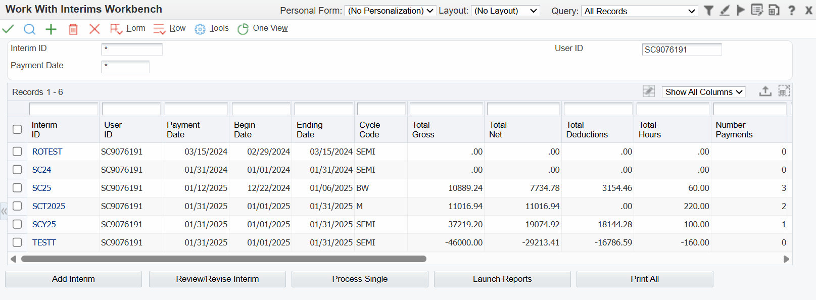

  2. Select the Interim ID you want to process, or create a new Interim ID.
  3. Description of sample-arch-image.png follows
    Interim Payment Workbench Program - Interim ID

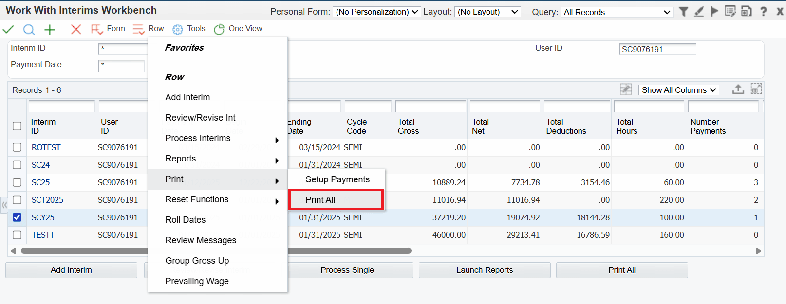

  4. From the Row menu, select Print, and then select Print All.
    Interim Payment Workbench Program - Print Interim ID
