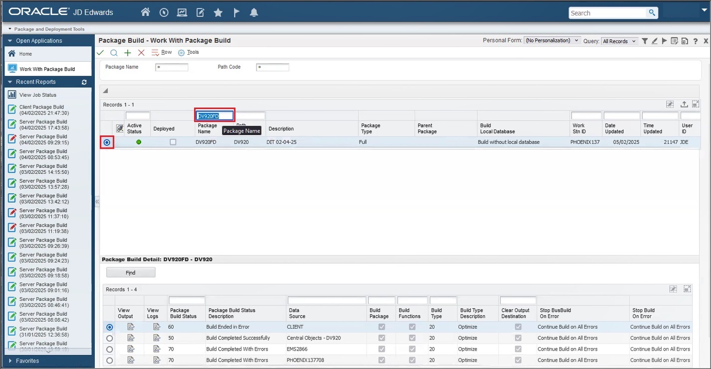

  1. Access the Work With Package Build (P9621W) web application.
  2. Find and select the package DV920FD (built with Tools Release 9.2.9.3) from the records grid.
    Work With Package Build Web Application

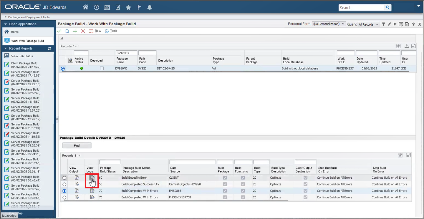

  3. In the Package Build Detail section, click the View Log Icon View Log icon and download the log file PKG_DV920FD_DV920.zip. The system retrieves package logs from the enterprise server and the deployment server, contains them in a compressed file, and then imports them into the EnterpriseOne Software Archive Repository table (F96700R).
    Work With Package Build - Package Build Detail Section

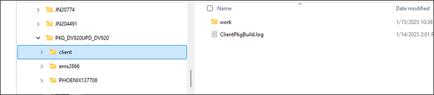

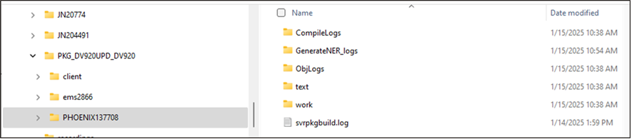

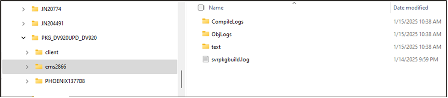

  4. Locate the downloaded compressed file to review the client and server log files.
    Client Log File
    Client Log File
    Server Log File
    Server Log File
    Secondary Server Log File

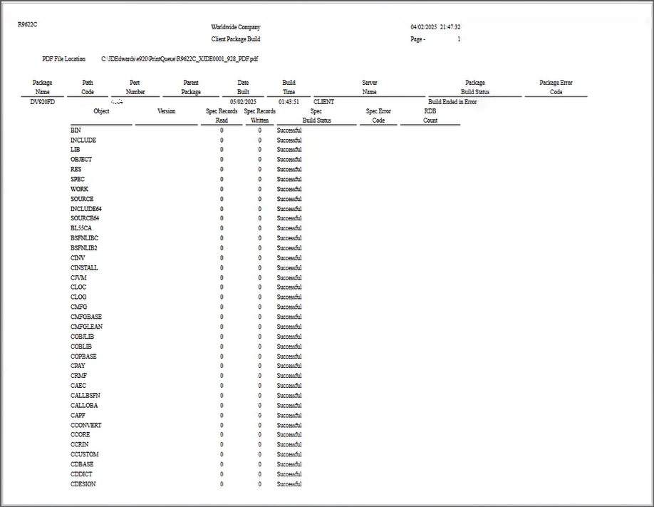

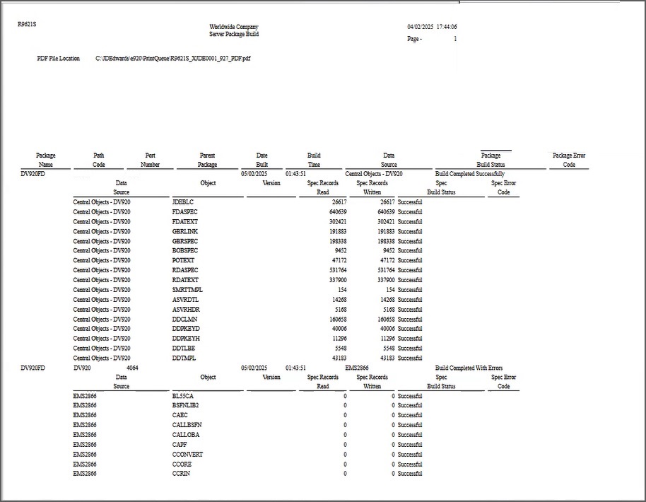

  3. In the Package Build Detail section, click the View Log Icon View Output icon in the grid column to download the corresponding client or server package build report.

    Client Package Build Report
    Server Package Build Report
