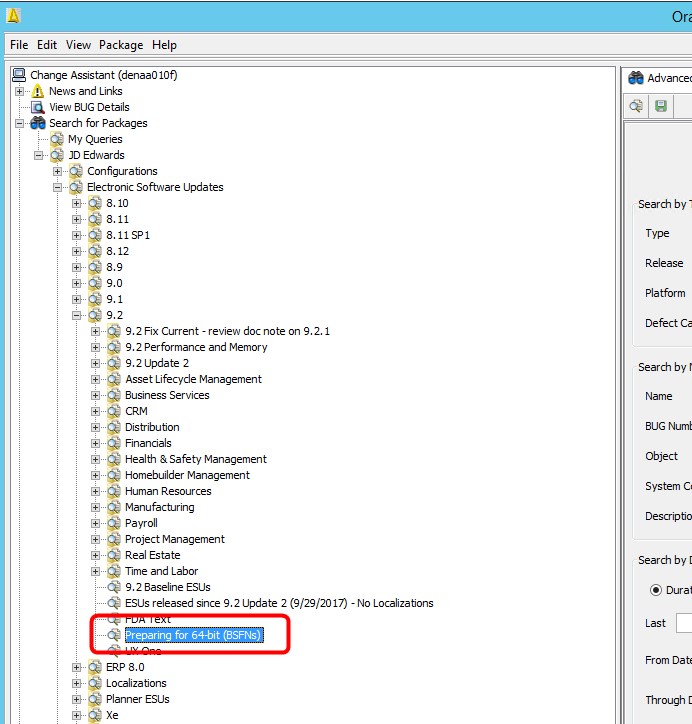

  2. Expand the Search for Packages node.
  3. Navigate to JD Edwards Electronic Software Updates 9.2 and select the profile, Preparing for 64-bit (BSFNs).Business Function ESU
  4. Click the Search button.
