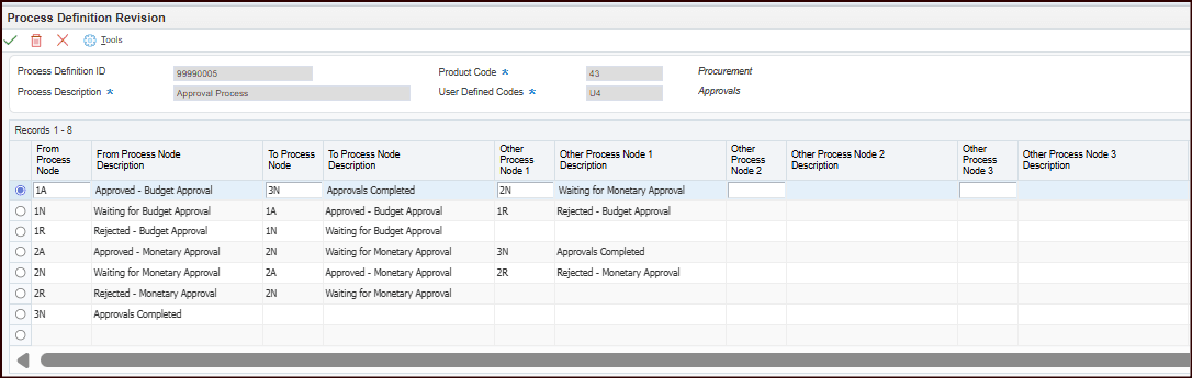

Use the Work with Process Definition application (P00201) to define process flows using values from the User-Defined Codes (UDC) tables. The following example shows a reference process definition configuration for the approval process. For more information, see Setting Up Process Definition Records for Procure to Pay Process Model Templates.
Note: You must set up process definition IDs for the enterprise processes. The Enterprise Process Modeler uses your process definition setup to automatically generate process flow diagrams. For more information, see Setting Up a Process Definition Record Using P00201 in the JD Edwards EnterpriseOne Tools Enterprise Process Modeler Guide. -

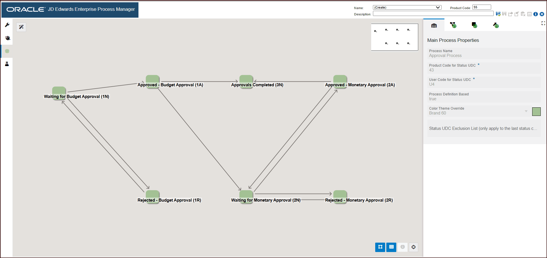

- Click OK. The Main Module tab is displayed in the Enterprise Process Manager window,
where you can see the automatically generated enterprise process diagram based on
the values defined in the Create Process window and the Process Definition that you
set in P00201.
The Approvals process diagram displays nodes and the links between the nodes. The nodes represent the tasks in the process template and the links represent the connection between the nodes.

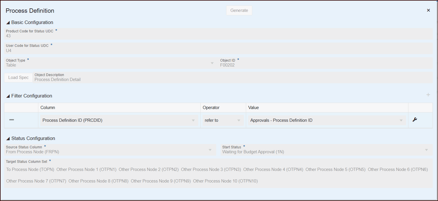

Click the Open Process Definition icon (next to Design Option) to review the settings in the read-only tab.
The Process Definition window opens. You can view the Basic Configuration, Filter Configuration, and Status Configuration details based on the values defined in the Create Process window and the process definitions that you have set. These configurations are used to build the nodes and links and to automatically generate the process model.
- The Basic Configuration section displays the UDC - Procurement/Approvals (43/U4) and the table that the system uses to generate the template - Process Definition Detail table (F00202).
- The Filter Configuration section displays the columns based on which the data is filtered. The system filters the data based on the Process Definition ID values for the Procure to Pay process modeler.
- The Status Configuration section displays the Source Status Column, Start Status, and Target Status Column Set.
