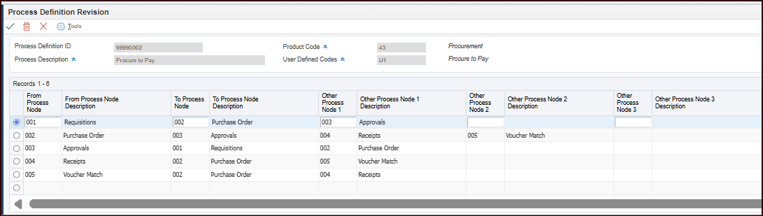

Use the Work with Process Definition application (P00201) to define process flows using values from the User-Defined Codes (UDC) tables. The following example shows a reference process definition configuration for the procure to pay process. For more information, see Setting Up Process Definition Records for Procure to Pay Process Model Templates.
Note: You must set up process definition IDs for the enterprise processes. The Enterprise Process Modeler uses your process definition setup to automatically generate process flow diagrams. For more information, see Setting Up a Process Definition Record Using P00201 in the JD Edwards EnterpriseOne Tools Enterprise Process Modeler Guide. -
