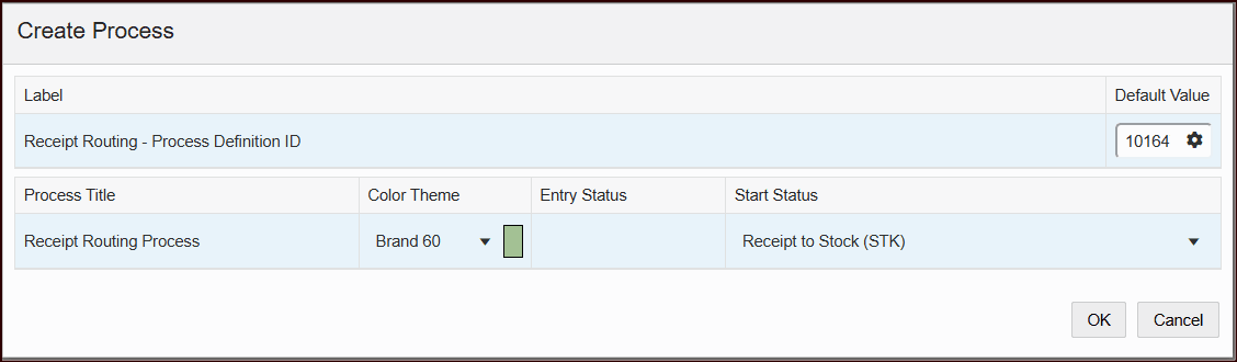

The system displays the Create Process window.
Note: The Create Process window is only displayed when you are creating an enterprise process for the first time. After creating a process, when you click Processes again, the system displays the previously created process layout along with the template used for its creation and the Enterprise Process Manager options.If you want to create a new process, in the Enterprise Process Manager window, click the Name drop-down list and select Create. - From the Import Process Template drop-down list, select JDE TMPL P2P Receipt Routing template.
- Click OK. The Process Definition ID, along with the default value for the receipt
routing process is displayed in the Create Process window. You can edit the value or
accept the default value.

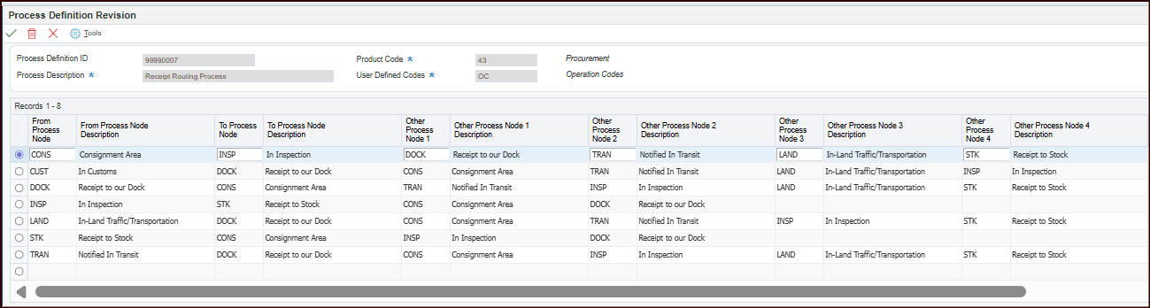

Use the Work with Process Definition application (P00201) to define process flows using values from the User-Defined Codes (UDC) tables. The following example shows a reference process definition configuration for the receipt routing process. For more information, see Setting Up Process Definition Records for Procure to Pay Process Model Templates.
Note: You must set up process definition IDs for the enterprise processes. The Enterprise Process Modeler uses your process definition setup to automatically generate process flow diagrams. For more information, see Setting Up a Process Definition Record Using P00201 in the JD Edwards EnterpriseOne Tools Enterprise Process Modeler Guide. -
- For the Receipts Routing process, view and review the Color Theme and Start Status
from their respective drop-down lists. The system populates the drop-down list with
available nodes for the receipt routing process. The selected value in this field
serves as the first (start) node in the automatically generated process model. By
default, the Start Status is set to
Receipt to Stock (STK).

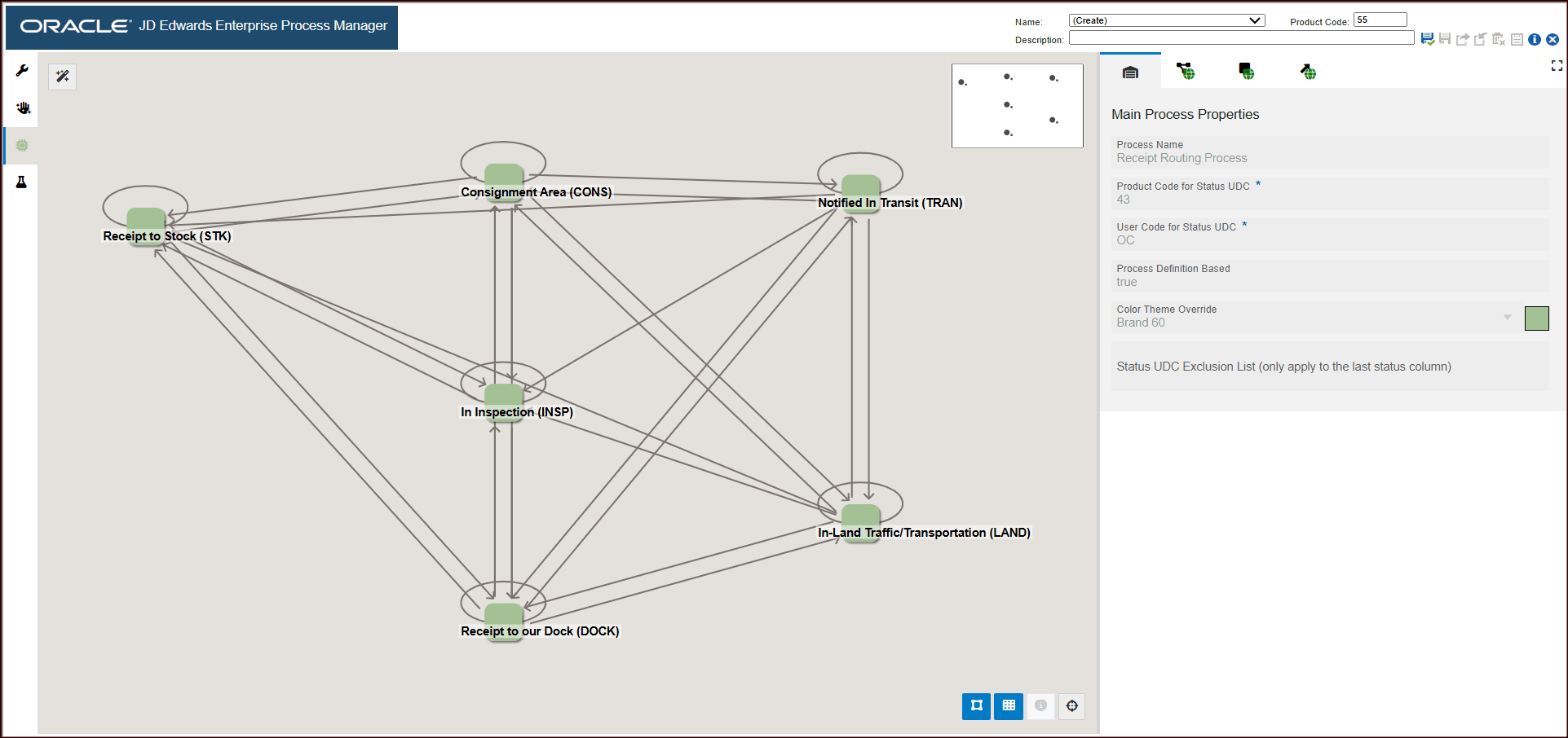

- Click OK. The Main Module tab is displayed in the Enterprise Process Manager window,
where you can see the automatically generated enterprise process diagram based on
the values defined in the Create Process window and the Process Definition that you
set in P00201.
The Receipts Routing process diagram displays nodes and the links between the nodes. The nodes represent the tasks in the process template and the links represent the connection between the nodes.
