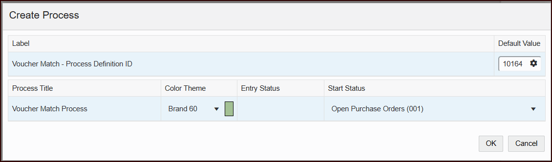

The system displays the Create Process window.
Note: The Create Process window is only displayed when you are creating an enterprise process for the first time. After creating a process, when you click Processes again, the system displays the previously created process layout along with the template used for its creation and the Enterprise Process Manager options.If you want to create a new process, in the Enterprise Process Manager window, click the Name drop-down list and select Create. - From the Import Process Template drop-down list, select JDE TMPL P2P Voucher Match template.
- Click OK.
- The Voucher Match - Process Definition ID, field along with the default
value, is displayed in the Create Process window. You can edit the values or
accept the default value.

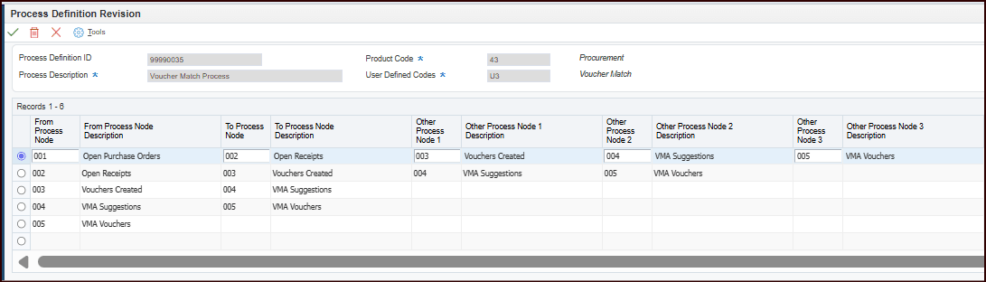

Use the Work with Process Definition application (P00201) to define process flows using values from the User-Defined Codes (UDC) tables. The following example shows a reference process definition configuration for the voucher match process. For more information, see Setting Up Process Definition Records for Procure to Pay Process Model Templates.
Note: You must set up process definition IDs for the enterprise processes. The Enterprise Process Modeler uses your process definition setup to automatically generate process flow diagrams. For more information, see Setting Up a Process Definition Record Using P00201 in the JD Edwards EnterpriseOne Tools Enterprise Process Modeler Guide. -
- For the voucher match process, select the Color Theme and Start Status
from their respective drop-down lists. The system populates the drop-down list with
available nodes for the voucher match template. The selected value in this field
serves as the first (start) node in the automatically generated process model. By
default, the Start Status is set to Open Purchase Orders (001).

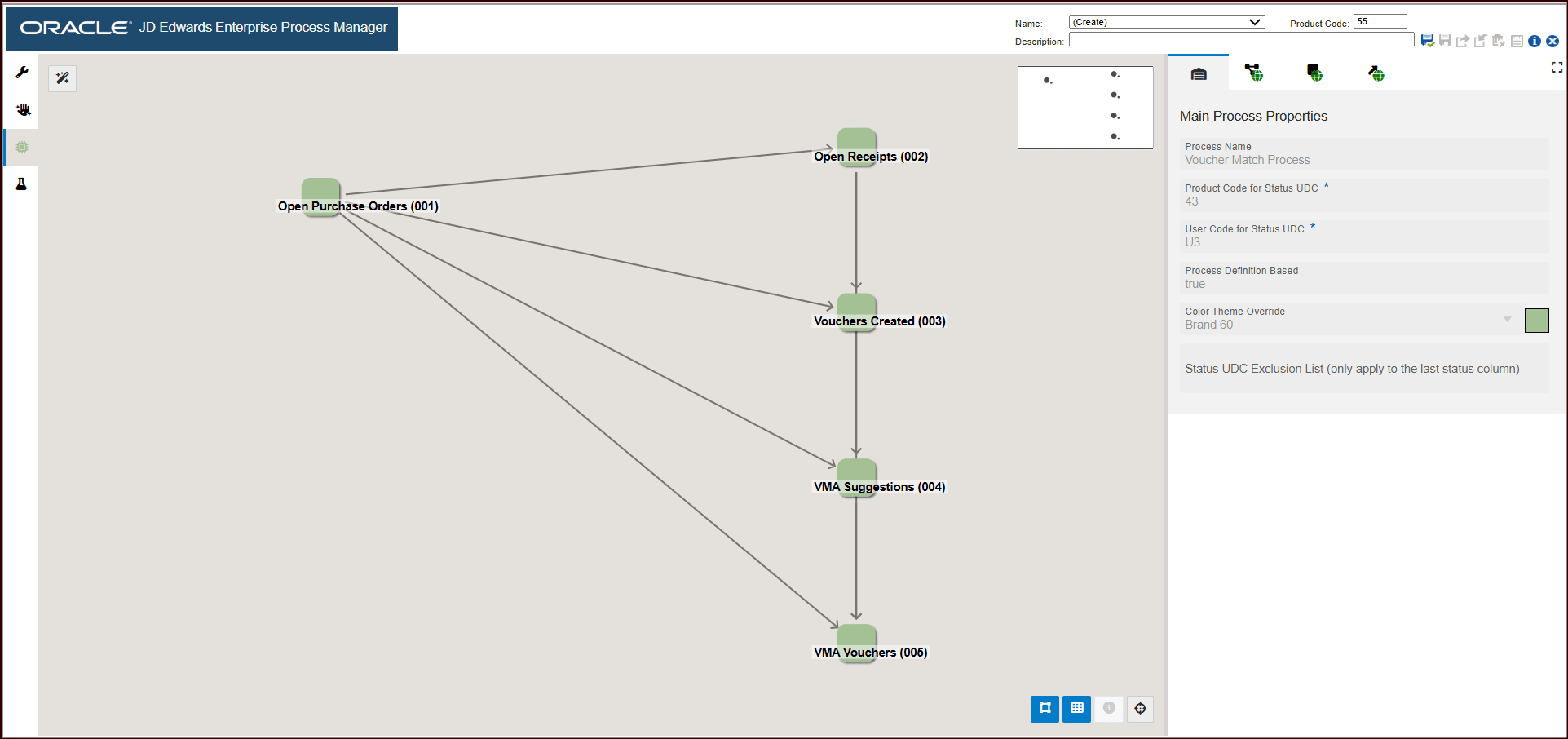

- Click OK. The Main Process Properties tab is displayed in the Enterprise Process
Manager window, where you can see the automatically generated enterprise process
diagram based on the values defined in the Create Process window and process
definition that you set.
The enterprise process diagram displays nodes and the links between the nodes. The nodes represent the tasks in the process template and the links represent the connection between the nodes.

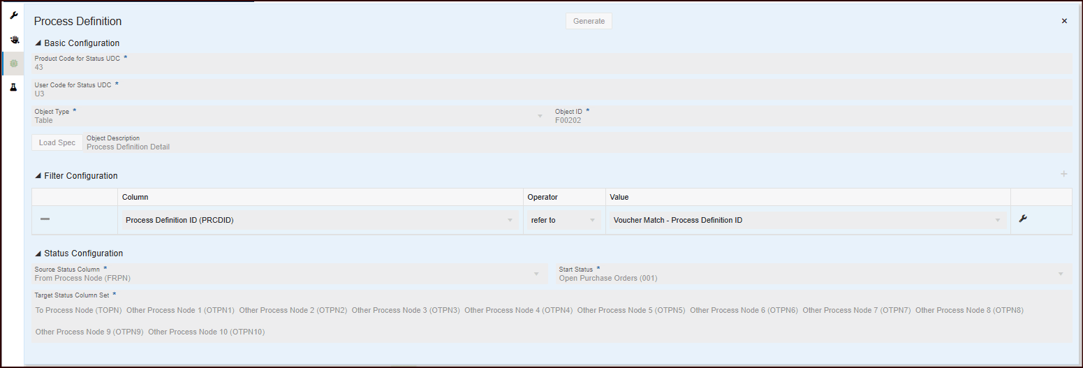

- Click the Open Process Definition icon (next to Design Option) to review the
settings.
The Process Definition window opens. You can view the Basic Configuration, Filter Configuration, and Status Configuration details based on the values defined in the Create Process window and the process definition that you have set. These configurations are used to build the nodes and links and to automatically generate the process model.
- The Basic Configuration section displays the UDC - Procurement/Voucher Match (43/U3) and the table that the system uses to generate the template - Process Definition Detail table (F00202).
- The Filter Configuration section displays the columns based on which the data is filtered. The system filters the data based on the Process Definition ID values for the voucher match process model.
- The Status Configuration section displays the Source Status Column, Start Status, and Target Status Column Set.
