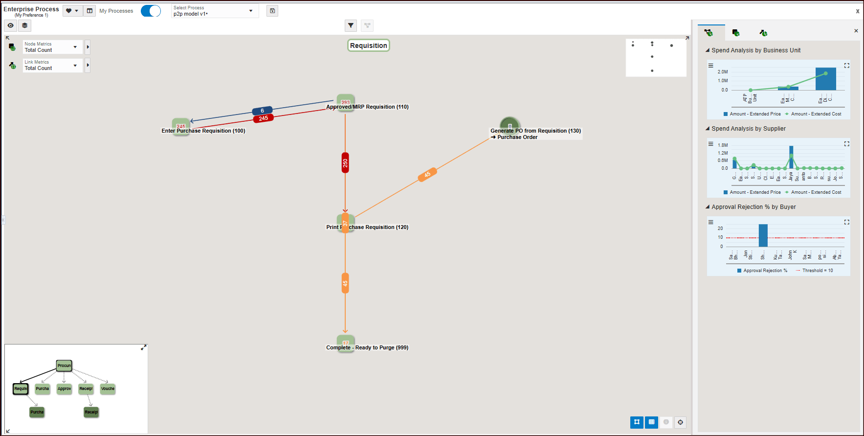

The starting node displays the value selected in the Create Process – Start Status field for the requisition process. Additionally, the connected process is set at the Entry Status node selected earlier in the Create Process window. The connected process button is color-coded according to your preference and is highlighted with a circular border for clear identification.
You can also use the Hierarchy Map at the bottom corner of the window to view the connected parent and child processes. You can resize the window by dragging and dropping or hide it as needed.
In the following example, the parent and child processes are displayed in the Hierarchy Map based on the selected color themes.
This image displays the requisition connected process.
