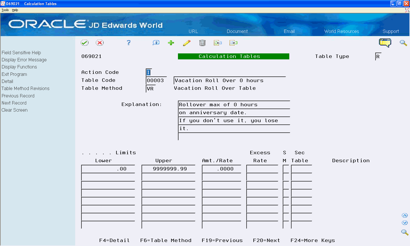

Example: Limit on Vacation or Sick-Leave Rollover
Your organization's vacation or sick-leave policy might state that employees cannot carry forward more than 80 hours from one year to the next.
To administer this policy, you set up a calculation table that allows only 80 hours to roll over to the following year. The table is associated with the DBA that tracks availability.
The available amount might include a beginning balance from a prior year.
The system compares the balance with the limit on the table. The system does not roll over any amount to the new year that is over the limit.
Alternatively, your organization's vacation or sick-leave policy might state that employees cannot carry forward hours from one year to the next. To administer this policy, you define 0 (zero) as the limit in the rollover calculation table.

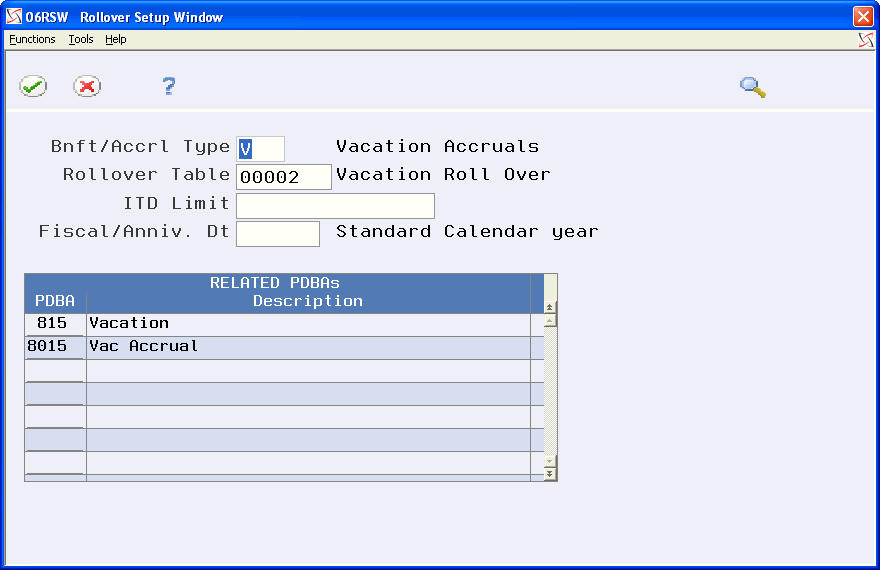

When you set up accrual 8016, Vacation Available, you enter the following rollover information:
In the Benefit/Accrual Type field, enter V (Vacation Pay).
In the Rollover Table field, enter the table code of the table that you just created so that the mandated amount rolls over.
In the first Related PDBAs field, enter the number of the pay type that you use for vacation pay.
In the next Related PDBAs field, enter the DBA number of the accrual that represents accrued but not yet available hours.
When you run the rollover program, the system calculates the balance to roll over by adding the accumulated and available balances and then subtracting the vacation time that the employee has taken.

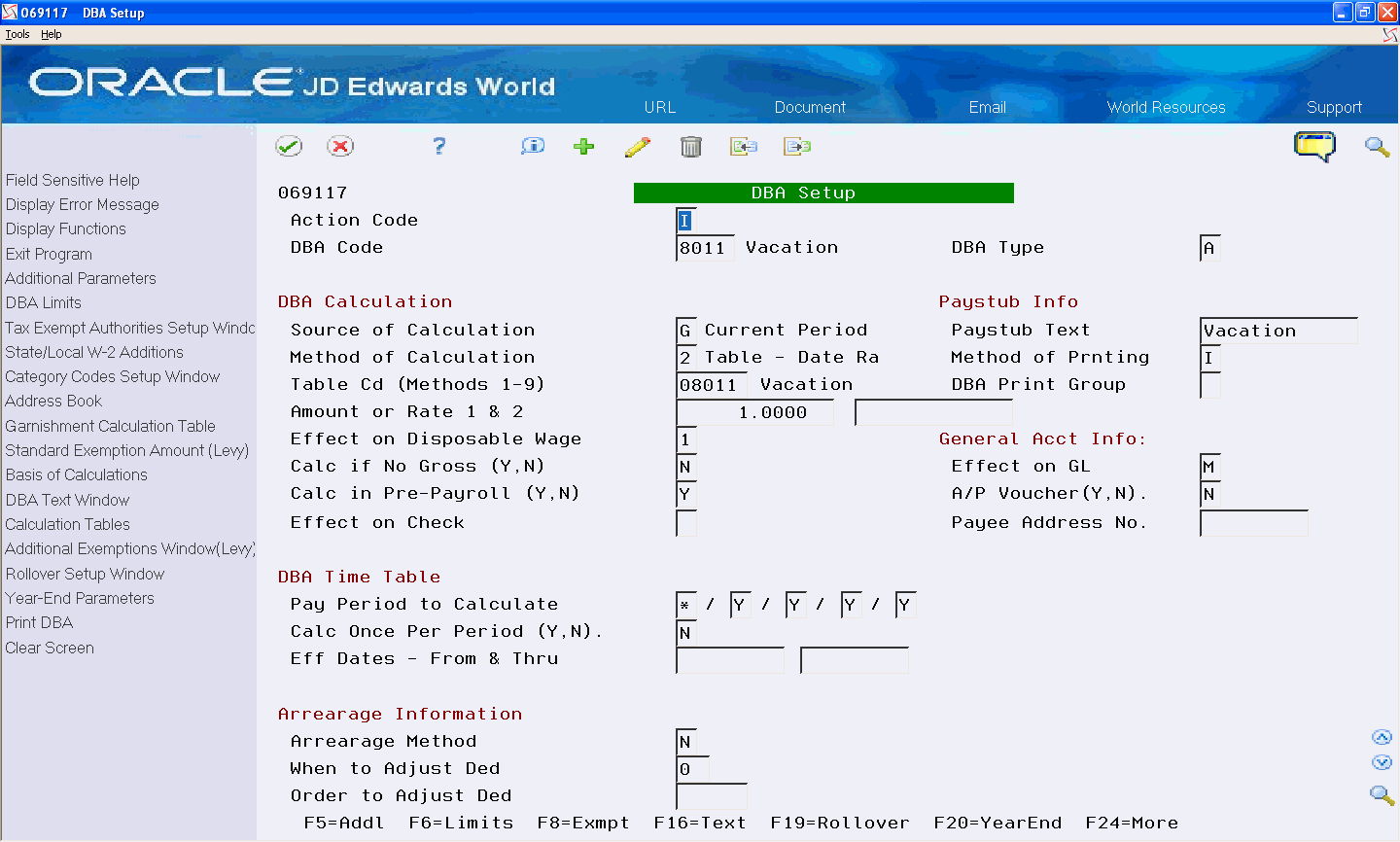

To enter rollover information for a DBA
Navigation
From Pay/Deductions/Benefits (G7742), choose DBA Setup
On DBA Setup, complete the steps for setting up an accrual.
Choose Rollover Setup Window (F19).
On Rollover Setup Window, choose Rollover Table (F17) to define carryover limits.
On Calculation Tables, enter R in the Table Type field.
Enter VR in the Table Method field.
Enter the number of months of service from the original hire date in the following fields:
Lower Limit
Upper Limit
Complete the following fields:
Table Code
Amount/Rate
Click Add.
On Rollover Setup Window, complete the following fields and click Enter:
Rollover Table
PDB
