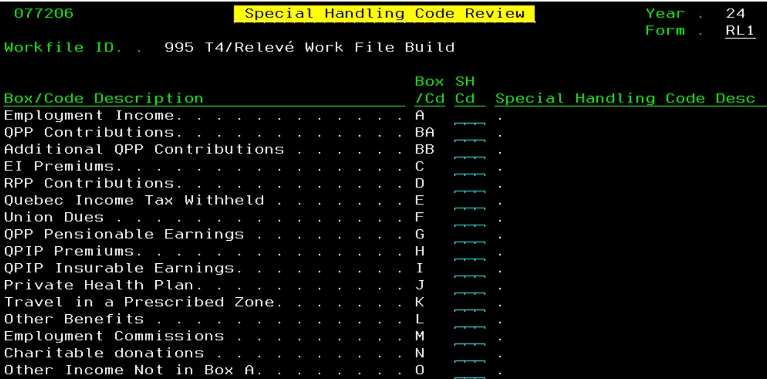

You can also access special handling code screens from the second Build T4/Relevé Workfiles screen. Use Special Handling Review (F15) to access the Special Handling Code Review screen and Special Handling Table (F16) to access the Special Handling Code Table screen.

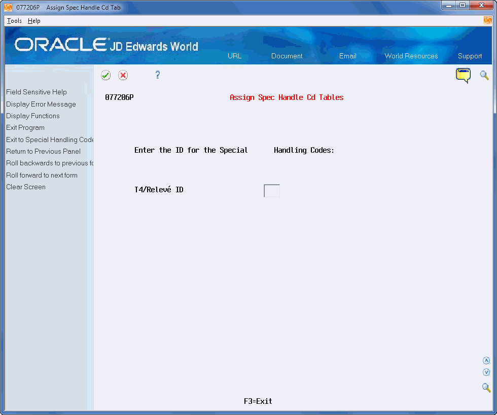

To assign special handling codes to boxes on the forms
Navigation
From T4/Relevé Setup (G772472), choose Assign Special Handling Code Tables
The default for the Assign Special Handling Code Tables screen is the T4 form, however you can set which form displays in several ways. You can set the processing option or you can enter the form type (RL1, NR4) in the Form field. You can use the following functions to access the codes for other forms for special handling:
F19 to display the special handling codes for the previous form
F20 to display the special handling codes for the next form
On Assign Special Handling Code Tables, enter the associated workfile build ID version and click Enter twice.
                     On the second Assign Special Handling Code Tables screen, enter a special handling code in any of the fields for each form and click Enter.
