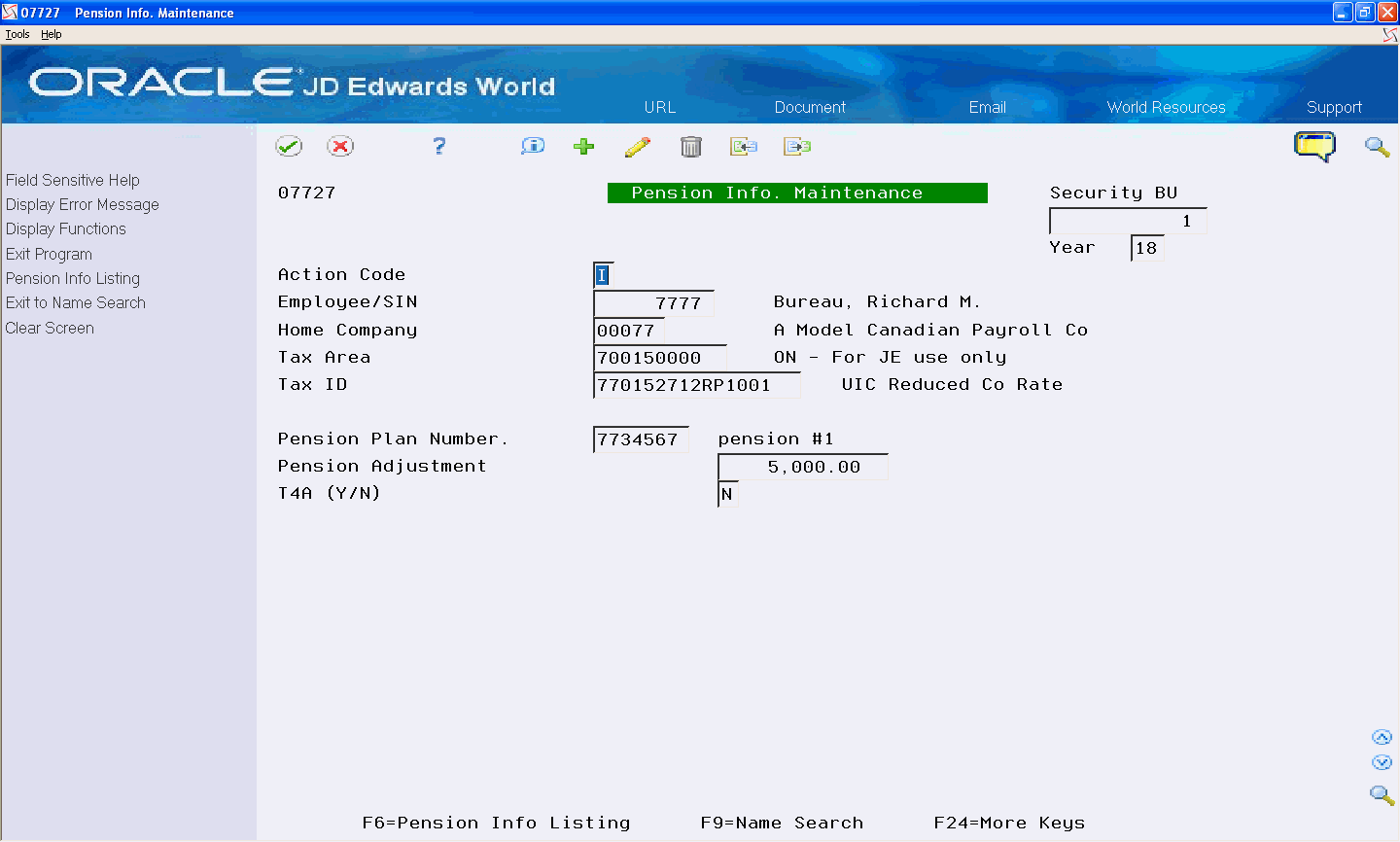

Creating Individual Pension Records
You can enter a pension plan number and the pension adjustment amounts that you need to report for individual employees.
You might need to enter a pension adjustment for an individual employee if the employee made voluntary contributions that exceeded the payroll deduction amount and you did not withhold tax on that amount.
When you enter a pension adjustment, you might create multiple records for any employee who worked in more than one tax area or under more than one tax ID.
The Pension Information Maintenance program creates or updates records in the Canadian Pension Information File table (F07727).
To create individual pension records
Navigation
From T4/Relevé Setup (G772472), choose Pension Info. Maintenance
On Pension Info. Maintenance, complete the following fields and click Add:
Year
Employee/SIN
Home Company
Tax Area
Tax ID
Pension Plan Number
Pension Adjustment
T4A (Y/N)
            Field  |
                        Explanation  |
Pension Plan Number  |
                        The seven-digit registration number that is issued for the employees' pension plan or deferred compensation profit-sharing plan. Screen-specific information The pension plan numbers that you enter on this screen must exist in user defined code table 77/PN.  |
Pension Adjustment  |
                        The amount of the pension adjustment that you want to print on the T4 or T4A.  |
T4A (Y/N)  |
                        A code that specifies where the system prints the pension plan number and pension adjustment. Valid values are: Y – Print the pension plan number and pension adjustment on a T4A form N – Print the pension plan number and pension adjustment on a T4 form (default)  |
