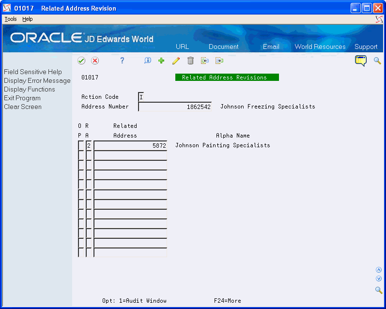

The following task illustrates how to set up the related code and address book number of the legal entity for supplier 1862542.

Navigation
From Auxiliary Address Book Information (G01111), choose Related Addresses
  1. On Related Addresses, locate a supplier or company.
    This graphic is described in the surrounding text.
  2. Enter a value from UDC 01/RA in the RA field.
  3. Enter the address book number of the reporting entity in the Related Address field and click Change.
