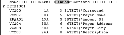

The system determines the location of each box on the form based on the horizontal and vertical position in the source code. The following graphic displays the source code layout for the MISC form. In the graphic, the value directly below the Lin column determines the line number; therefore, to move a line up or down, you adjust the line number. The value directly below the Pos column determines the starting position on that line; therefore, to move a value to the right or left, you adjust the position number. By changing these values, a box can be moved to the desired position without affecting any other boxes on the form. If you need to change multiple boxes, you can adjust the position and line of surrounding boxes accordingly.
This graphic is described in the surrounding text.
After you complete the source code changes for the laser form, you must use the compile process to create a new object from the source code. Once you verify that the system created the object from your compile report, you must then compile the Write Media program (P04515) to incorporate the changes on the new laser form.
