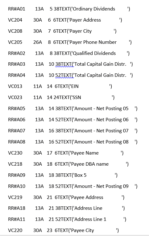

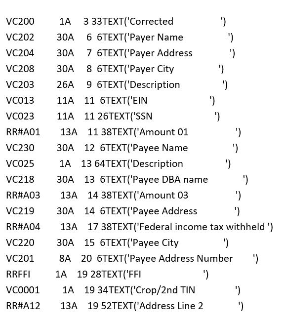

The names of the fields in the source do not necessarily coincide with the description of the fields that display in UDC 04/TR (Type of Return). On the Miscellaneous form, the field names for Amount 01 through Amount 08 correspond with the numbered boxes on the 1099 return. In this example, the field RR#A01 corresponds to Box 1 (Rent), which is the line you need to change.
To change the second form area, which starts from the heading DETMISC2, locate the RR#A01 line in that section. According to the source code, both the line and position are 38. From your print test, you determined that the line on the second form for Box 1 was one line too high, so you need to change the value of the line (Lin) from 38 to 37. Because the value prints two spaces to the right, you need to change the value of the position (Pos) from 38 to 36.

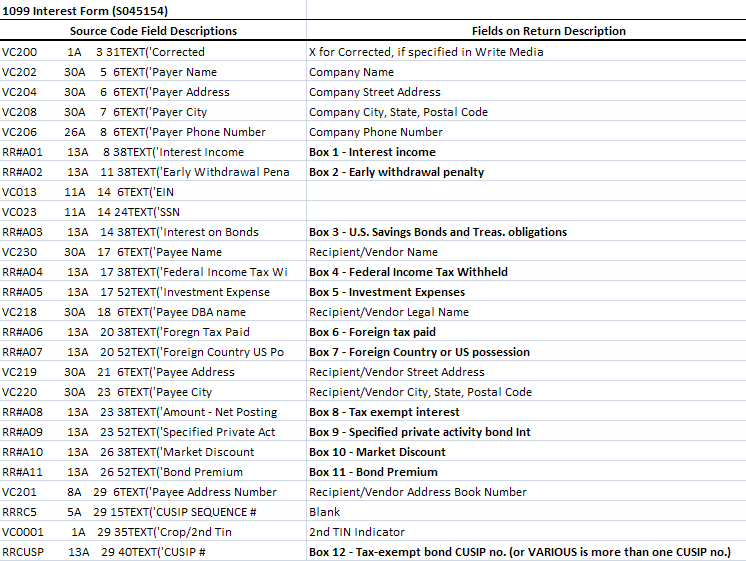

Field Name Identification
The following table illustrates how the fields in the source code for the laser forms map to the actual fields on the 1099 returns.
