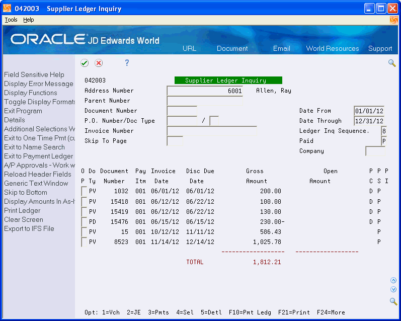

  1. On Supplier Ledger Inquiry, to display paid vouchers for the supplier for the 1099 reporting year, complete the following fields.
    • Address Number
    • Date From and Date Through
  2. Enter 8 in the Ledger Inquiry Sequence field to display paid vouchers by G/L date.
  3. Enter 1 or P in the Paid field to limit the display to paid vouchers and click Enter.
    This graphic is described in the surrounding text.
  4. Enter 9 in the Option field (Voucher 1099 Information Update) to select the vouchers to update and click Enter.

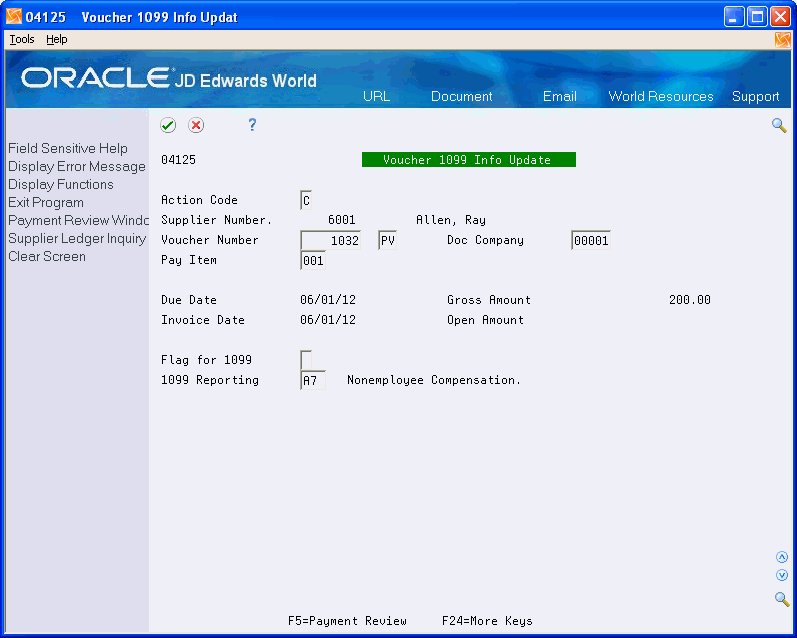

  5. On Voucher 1099 Info Update, complete one or both of the following fields and click Enter:
    • Flag for 1099
    • 1099 Reporting
