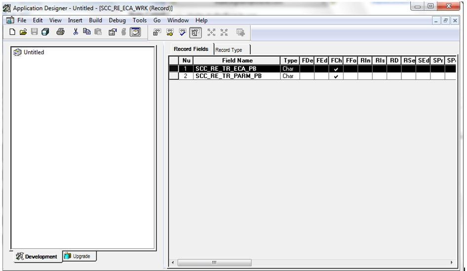

Attach Generated Code to the Component Event
The code can be copied from the Generated Code window and pasted into the PeopleCode Event. Open Application Designer and navigate to the PeopleCode Event. In this example, the Event is added to the FieldChange event of a WorkRecord field:
This example illustrates the Application Designer Example for Rules Engine User Interface Integration Example.
