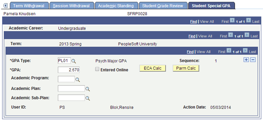

This example illustrates the Student Special GPA page after Customization for Rule Engine User Interface Example.
Student Special GPA (grade point average) page after Customization for Rule Engine User Interface Example
The act of clicking a button is the FieldChange Event to which the PeopleCode should be added to call the Trigger.

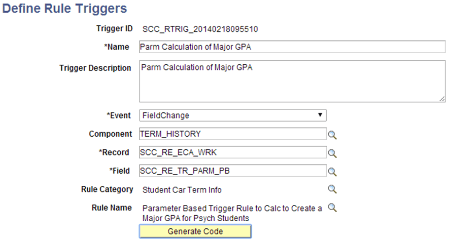

Use the Define Rule Triggers page (Set up SACR > System Administration > Rules Engine > Setup > Define Rule Triggers) to generate boilerplate code and attach that code to the Component Event. The setup created here also acts as an administrative reference to Events and associated Rules. You must minimally specify a PeopleCode Event, a Record, and a Field. The following PeopleCode Events can be selected:

You may also add a Component for reference. Once you have the setup, click the Generate Code button to generate the boilerplate PeopleCode. The Generate Code option uses information from the Trigger to create a Code example which can be used to call the Trigger from the Component.

Generate Code for the Parm Calc
This example shows a Trigger based on Method B, which only contains Input Variables. The calculated GPA is passed back to the Component Event which takes care of updating the GPA value.
Access the Define Rule Triggers page (Set Up SACR, and then System Administration, and then Rules Engine, and then Setup, and then Define Rule Triggers).
This example illustrates the Define Rule Triggers page for Parm Calc for Rules Engine User Interface Integration Example.
Here is the example generated code:
