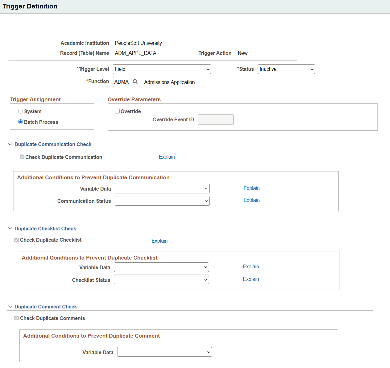

Access the Trigger Definition page (Campus Community, and then 3C Engine, and then Set Up 3C Engine, and then Trigger Definition).
This example illustrates the fields and controls on the Trigger Definition page (1 of 2). You can find definitions for the fields and controls later on this page.

Field or Control Description
Trigger Action
The system displays the action (New (add), Change, or Delete) that you selected. The action must occur as described on this page to invoke the 3C engine.
Note: The SavePostChange PeopleCode must use the same add, change, or delete action that you define here.
Trigger Level
Select the level at which this action must occur to invoke the 3C engine.
Record: The specified trigger action on the row invokes the 3C engine process, regardless of field. You must specify the 3C engine Event ID to process for a record level trigger.
Field: The specified trigger action on the field invokes the 3C engine process. You must specify the Event ID to process and the fields on which the specified action occurs, to invoke the 3C engine.
Function
Enter the functional area (administrative function) for this event trigger.
Trigger Assignment
System
Select this check box to insert or update in real time, the communications, comments, and checklists specified in the 3C engine event ID.
Batch Process
Select this check box to indicate that when the specified action occurs to the record or field, the system should insert a row on the Engine Trigger Results page for use by 3C engine background processing later.
Override Parameters
Override
Select this check box to prevent the 3C engine from using the field or record conditions identified on this page, and, instead, use the logic configured around the Function Trigger3CEngine PeopleCode on the record or component location.
If you select the Override option, you must specify the overriding 3C engine event ID to use.
Override Event ID
Enter the 3C engine event to process when the Override option is selected.
Duplication Communication Check
Check Duplicate Communication
Select to determine if a communication is a duplicate and to assign or prevent assignment according to the defined conditions.
See Managing Duplicate Communication Assignments.
Duplicate Checklist Check
Check Duplicate Checklist
Select to determine if a checklist is a duplicate and assigns or prevents assignment according to defined conditions.
Duplicate Comment Check
Check Duplicate Comments
Select to determine if a comment is a duplicate and create or prevent the creation of the comment according to defined conditions.
