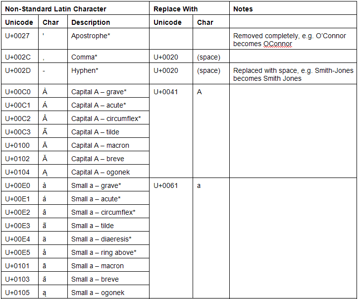

This table illustrates the Character Conversion for Punctuation Marks; Capital and Small A.

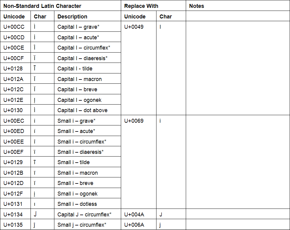

This illustrates the Character Conversion for Capital and Small I; Capital and Small J.

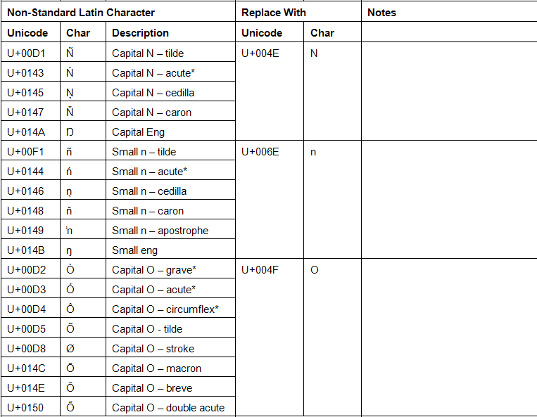

This illustrates the Character Conversion for Capital and Small N; Capital O.

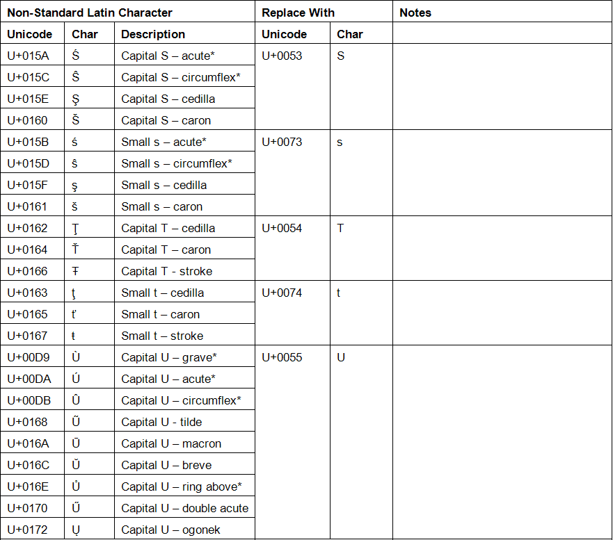

This illustrates the Character Conversion for Capital and Small S; Capital and Small T; Capital U.

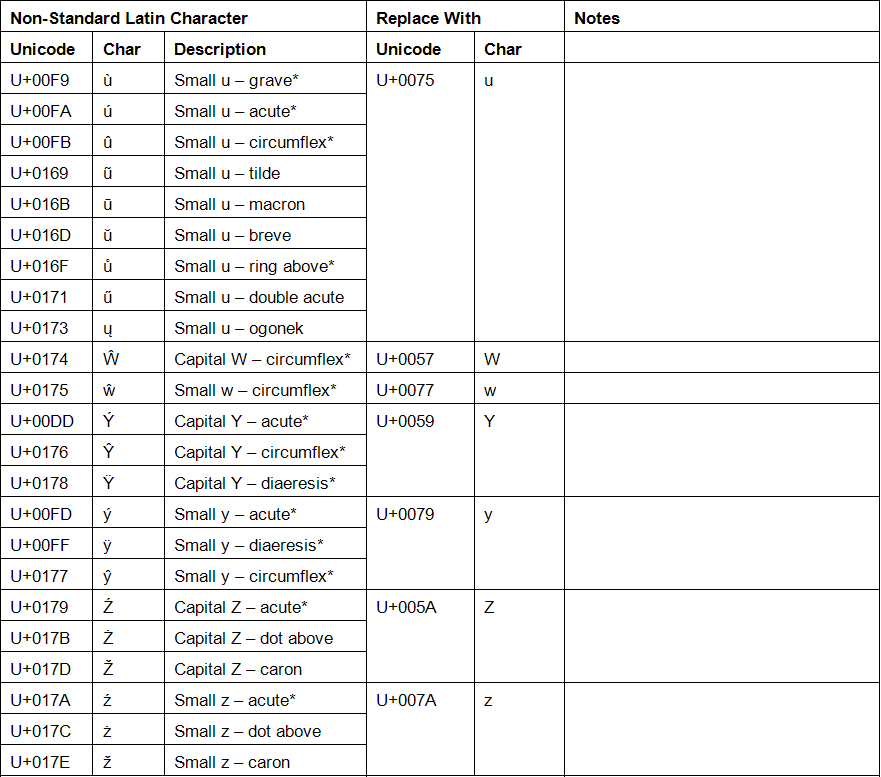

This illustrates the Character Conversion for Small U; Capital and Small W; Capital and Small Y; Capital and Small Z.

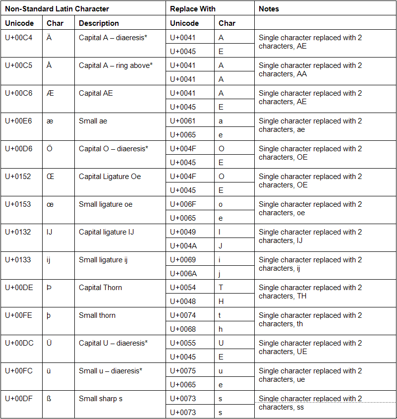

This illustrates the Character Conversion for Other Special Characters.
