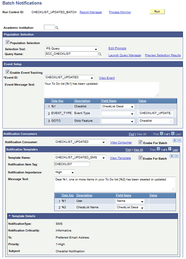

This example illustrates the fields and controls on the Batch Notifications page. You can find definitions for the fields and controls later on this page.
Batch Notifications Page
Population Selection
Field or Control Description
Select this check box to enable the Selection Tool. This run control does not support manual selection.
Selection Tool
Select the Population Selection tool available for this component.
Event Setup
Enable Event Tracking
Select this check box when event tracking is needed. If it is selected, event configuration setup is available to configure it and send events. If it is not selected, only notification consumer and templates configuration are available to send notifications.
Event ID
Select an Event ID from the list of the Notifications Framework events.
View Event
Select this link to access the Event Setup page for selected event ID.
Event Message Text
Displays a read-only field populated from the selected event template configured in event setup.
Event Bind variables
This grid is populated based on the event selected and the population query selected.
  • Data Key: Displays the bind variable key from the generic template.
  • Description: Displays the bind variable description from the generic template.
  • Field Name: This is populated with the list of fields selected in the PS Query. Select the field from the PS Query to the bind variable, so that the value from the query can be used as bind value for the bind variable in the template.
  • Value: Enter a static value in this field for use as a bind value for the bind variable in the template.
Notification Consumers
Select a consumer from the list of all active Notifications Framework consumers/Event framework consumers based on ‘Enable Event Tracking’ check box selection. If the ‘Enable Event Tracking’ check box is selected the list is populated with active consumers of selected event; otherwise the list is populated with all active notification framework consumers.
View Consumer
Click this link to access the Notification Consumer Setup page.
Enable for Batch
Select this check box to enable the flexibility to mark the consumer as enable/disable for the current batch process rather than deleting and configuring again.
Notification Templates
Template Name
Select a template from the list of all active templates for the selected consumer. Currently, only templates of types Email, SMS, Alert & Push and those not set to use “Custom Logic” in recipient configuration are available.
View Template
Click this link to access the Notification Template setup page.
Enable for Batch
Select this check box to enable the flexibility to mark the template as enable/disable for current batch process rather than deleting and configuring again.
Notification Item Tag
Enter ad-hoc text to tag the notification. The text entered in this field is used to populate the notification item SCC_NTFREQ_ITM_TAG column.
Notification Importance
Select Notification Importance. By default this importance is populated with the generic template priority field.You can override this value.
Message Text
This is a read-only field populated from the selected notification template.
This grid is populated based on the template name selected and the population query selected.
  • Field Name: This drop-down list box is populated with the list of fields selected in the PS Query. Select the field from the PS Query to the bind variable, so that the value from the query can be used as bind value for the bind variable in the template.
Template Details
These fields are read-only fields populated from the selected notification template.

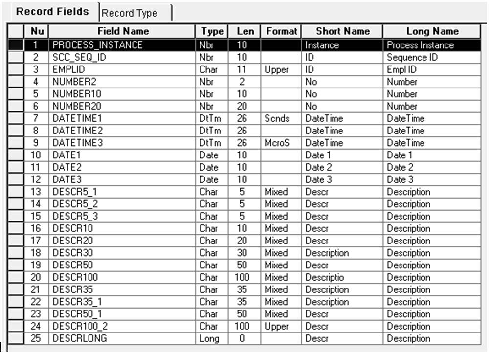

Results record: SCC_BAT_NTF_TGT
This example illustrates the SCC_BAT_NTF_TGT Record Structure.
Usually Population Selection works with a predefined set of columns (field) list for selection. This predefined fields list is used in PS Query. To make the PS Query dynamic in terms of column list selection, Batch Notifications Run Control uses an approach to create PS Query with ‘Expression’ and use this expression as Field with a Unique name mapped to one of the appropriate fields in SCC_BAT_NTF_TGT.

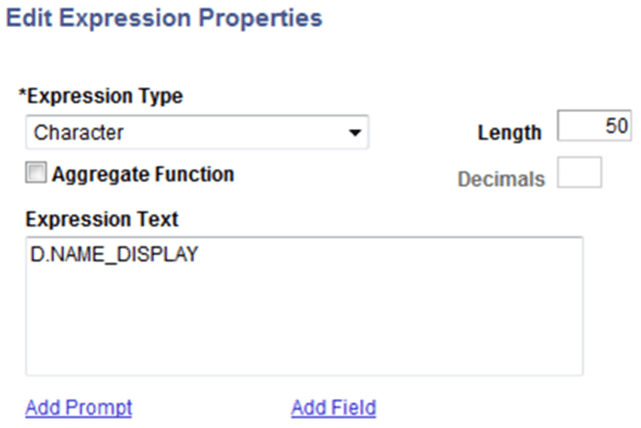

For example, if a field ‘D.NAME_DISPLAY’ needs to be added to the select list (example from a delivered Query ‘SCC_CHECKLIST’), then create an expression as follows:
This example illustrates the fields and controls on the Edit Expression Properties page.
Edit Expression Properties Page

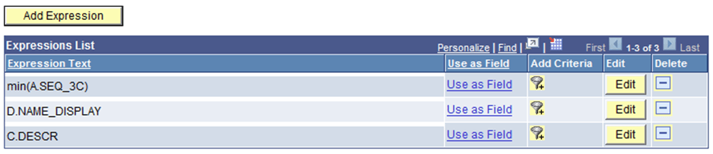

Use the above Expression as field by clicking the Use as Fieldlink:
This example illustrates the fields and controls in the PSQuery Expression “Use as Field” Link Example.
PSQuery Expression Use as Field Link Example

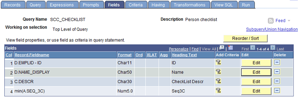

Click the Edit button for the field D.NAME_DISPLAY in the Fields tab of the Query manager:
This example illustrates the fields and controls on the PSQuery Fields page.
PSQuery Fields Page

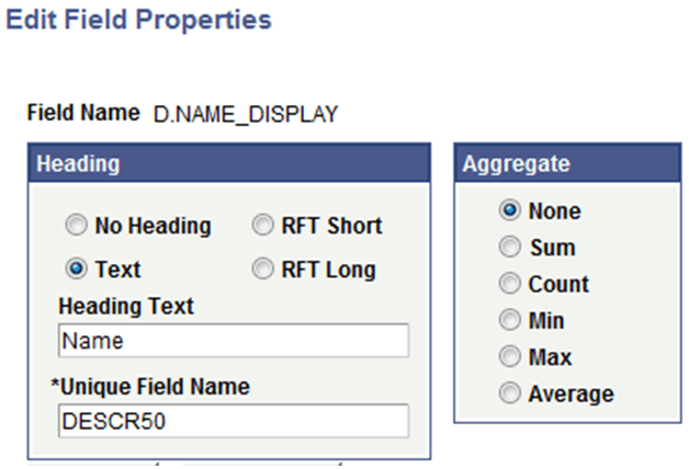

Enter the appropriate Heading Text and map the Unique Field Name with one of the appropriate available fields in the results record (SCC_BAT_NTF_TGT) - in this example - DESCR50.
This example illustrates the fields and controls on the PSQuery Edit Field Properties page.
PSQuery Edit Field Properties Page
While executing such PS Queries using Population Selection, the result data is inserted in to the results record with the fields mapping. In this example, D.NAME_DISPLAY is inserted in DESCR50 and it is also used in the Batch Notifications process.

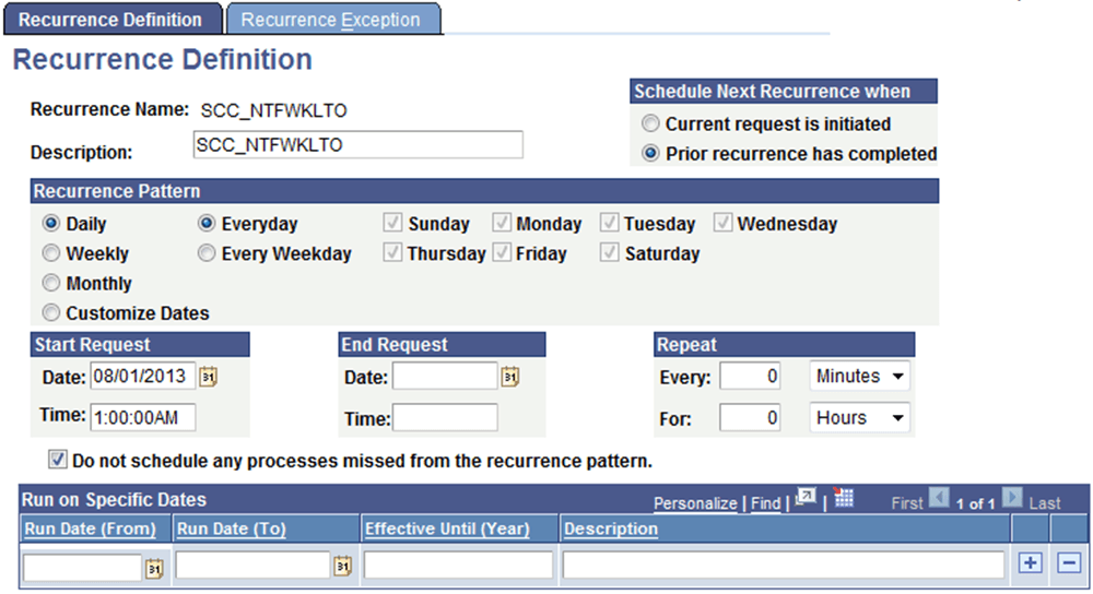

The process does not have a Run Control component. The process should be run after midnight to avoid any timing issues (date changes). A recurrence (PeopleTools, and then Process Scheduler, and then Recurrences) must be created and then assigned to the Process Definition for SCC_NTFWKLTO.
Be sure to select the check box for “Do not schedule any processes missed from the recurrence pattern”.
This example illustrates the fields and controls on the Recurrence Definition page.
Recurrence Definition Page

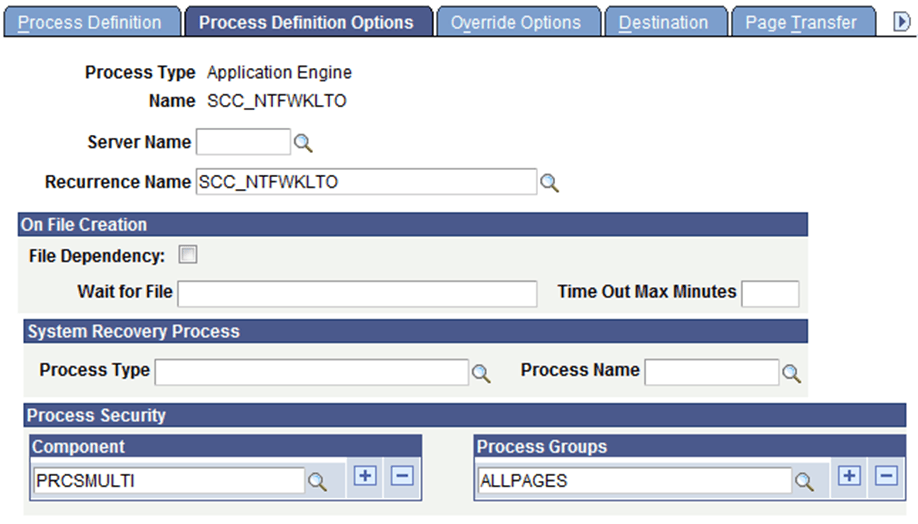

Once the Recurrence has been created, it can be assigned to the SCC_NTFWKLTO process definition (PeopleTools, and then Process Scheduler, and then Processes).
This example illustrates the fields and controls on the Process Definitions Options page.
Process Definitions Options Page
