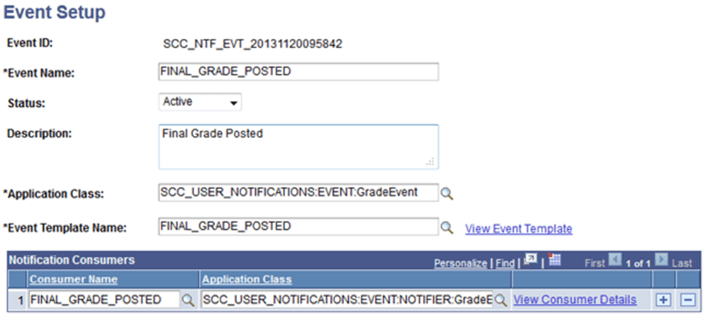

Configuring an Event for the Events Framework
Access the Event Setup page (Set Up SACR, and then System Administration, and then Utilities, and then Notifications, and then Event Setup).
This example illustrates the fields and controls on the Event Setup page. You can find definitions for the fields and controls later on this page.
Event Setup Page
Field or Control Description
Event ID
Displays a read-only unique ID field which is generated automatically after successful save of component.
Event Name
Enter the event name.
Status
Select the event status. Only active events can be raised.
Description
Enter the event description.
Application Class
Select the application class which is extending AbstractEvent class (SCC_COMMON:NOTIFICATION:EVENT:AbstractEvent) which handles the event notifications.
Select the SCC_COMMON:NOTIFICATION:EVENT:BatchEvent app class for batch events.
Event Template Name
Select a Generic template which is configured for event message text and event context data.
View Event Template
Select this link to open the Generic Template Definition page for the selected template.
Consumer Name
Select the Notification consumer for this event to connect the Notifications Framework into the Events Framework. The Notifications Framework is invoked for the selected consumers when the event is raised.
Application Class
Select the application which is extending AbstractEventNotifier (SCC_COMMON:NOTIFICATION:EVENT:AbstractEventNotifier) application class which handles the connection with the Notifications Framework. Select SCC_COMMON:NOTIFICATION:EVENT:BatchEventNotifier app class for batch events.
View Consumer Details
Select this link to open the Notification Consumer Setup page for selected consumer.
