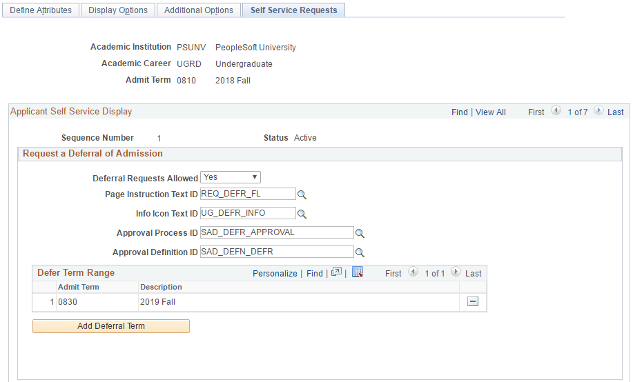

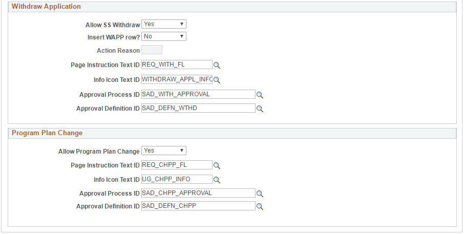

Self Service Requests
SAD_FLSS_REQUEST
Set Up SACR, and then Product Related, and then Recruiting and Admissions, and then Applicants, and then Fluid Applicant SS Setup, and then Self Service Requests
Configure display options for requests for deferrals, withdrawals, or change of program or plan.

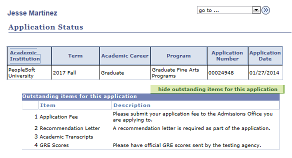

Examples
Suppose you have selected all the check boxes for PSUNV (PeopleSoft University) and Graduate on the Applicant Status Options page and the Complete check box has not been selected for a PSUNV- Fine Arts Graduate application. In such a case, the Admissions section in the Student Center displays the incomplete status for the application:
This is an example of Admissions section displaying the application status.
Example 1 of impact of settings on Applicant Status Options page

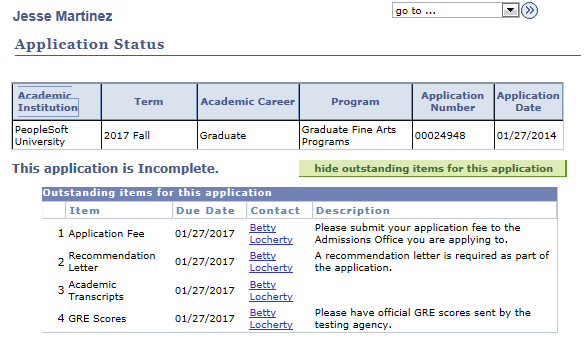

The applicant clicks the View Status link for Fine Arts Graduate application to navigate to the Application Status page. The system displays the Show outstanding items for this application button on the Application Status page. When the applicant clicks this button, she or he can view the outstanding checklist items with the due dates and contact names.
This is an example of Applicant Status page displaying the Due Date and Contact columns.

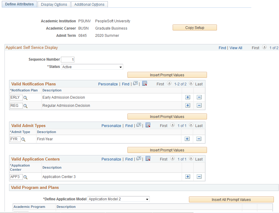

Defining Applicant Attributes for Applicant Self Service
Access the Define Attributes page (Set Up SACR, and then Product Related, and then Recruiting and Admissions, and then Applicants, and then Fluid Applicant SS Setup, and then Define Attributes).
This example illustrates the fields and controls on the Define Attributes page. You can find definitions for the fields and controls later on this page.
Use the Define Attributes page to configure a set of attributes for an applicant cohort. The attributes you define are used to determine which options on the Display Options and Additional Options pages apply to an applicant cohort.
You can define one sequence to apply to all applicants or you can define multiple sequences under Institution, Academic Career and Admit Term to handle various applicant groups where you want to vary the display and timing of display to those groups.
Field or Control Description
Copy Setup
Click to copy this setup to another term under the same institution and career.
Status
Select the status for each row: active or inactive.
Valid Notification Plans
Select the type of notification plan. Click the Insert Prompt Values button to insert all valid notification plans.
Valid Admit Types
Select admit types which are valid under the institution or career.
Valid Application Centres
Select an application center that is valid under a career. Other non-career specific application centers may be added as well.
Valid Program and Plans
Select an academic program that is valid under a career, and an academic plan that is valid under the associated career or program.

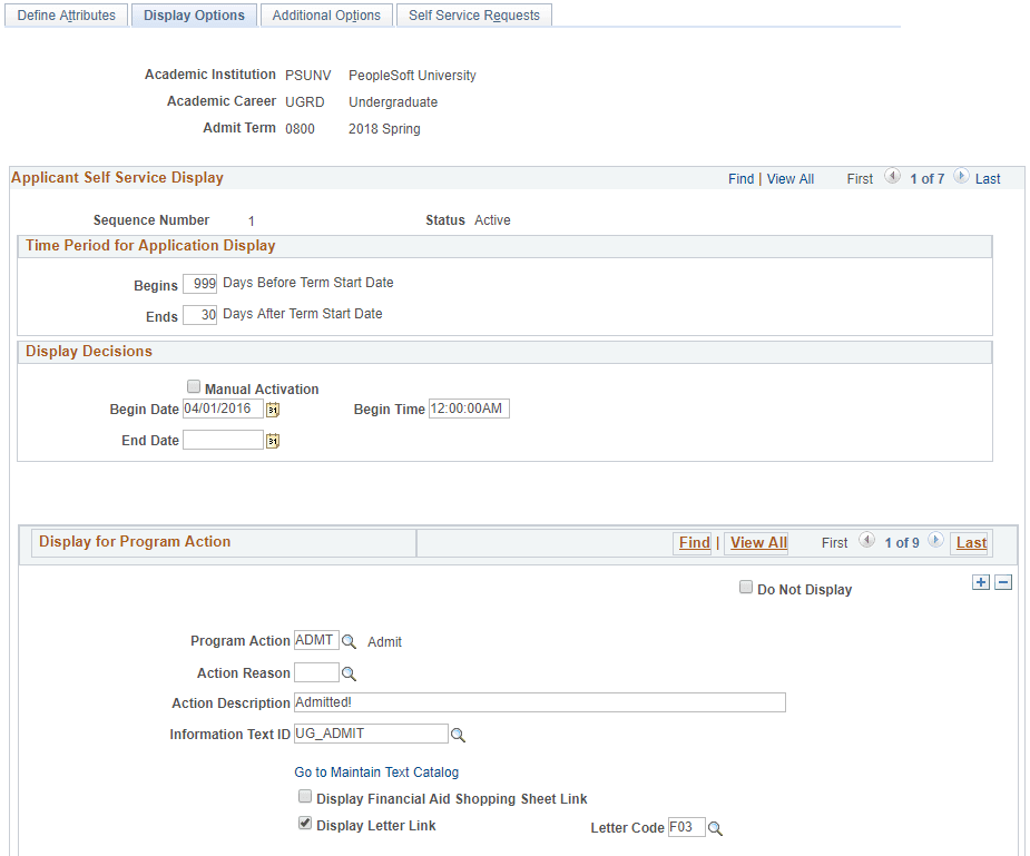

Configuring Display Options for Applicant Self Service
Access the Display Options page (Set Up SACR, and then Product Related, and then Recruiting and Admissions, and then Applicants, and then Fluid Applicant SS Setup, and then Display Options).
This example illustrates the fields and controls on the Display Options page. You can find definitions for the fields and controls later on this page.
Use the Display Options page to configure display options for the following items in Application Self Service in Fluid user interface:
  • applications
  • decisions
  • program actions
Self Service setup uses the Text Catalog to provide information to the applicants. Campus Solutions delivers a Text Catalog Owner ID of SAD, and a Sub ID of SSFL. In order to return values in the setup component, make sure you create your text IDs under this hierarchy.
Time Period for Application Display
Use this group box to define the length of time the application remains active in Self Service Fluid user interface. Start and end dates are calculated from the Term Start and End dates in the valid Term session table for the respective Institution and Career.

Display Decisions
Use this group box to define when decisions become available to applicants in Self Service for the cohort defined for this sequence.
Manual Activation
Select this check box to indicate that a user manually activates whether decisions appear in Self Service using the Activate check box.
Activate
This field is enabled only if you select Manual Activation. If Activate is selected, the decisions are immediately available to applicants in Self Service.
Begin Date
Specify the date when you would like the decisions to be made available in Self Service.
Begin Time
This field becomes available when you populate Begin Date. Specify an exact time on the Begin Date to display the decisions.
End Date
Set the date when the decisions stop displaying.
Delay Days
Use this option if you want decisions to appear for a set number of days from the decision row effective date. For example, if a program action of ADMT is dated 04/01/2016, and you specify 7 delay days, then the decision becomes available in Self Service on 04/08/2016.
This field is enabled only if Begin Date is blank.

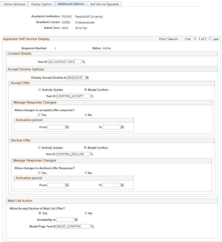

Configuring Other Display Options for Applicant Self Service
Access the Additional Options page (Set Up SACR, and then Product Related, and then Recruiting and Admissions, and then Applicants, and then Fluid Applicant SS Setup, and then Additional Options).
This example illustrates the fields and controls on the Additional Options page. You can find definitions for the fields and controls later on this page.
Use the Additional Options page to configure display options for contact details, accept or decline offers, and wait-list actions for Applicant Self Service. The options you define on this page appear only for applicants that meet the criteria you define on the Define Attributes page. See Defining Applicant Attributes for Applicant Self Service.
Contact Details
Select a Text ID from the Text Catalog to provide Content to the Contact Information page which renders from the Contact Us link in Self Service.
Accept Decline Options
Display Accept Decline to
While the applicant does not act on an Offer of Admission, use this field to specify the date by which the Accept and Decline buttons continue to appear on the Application Status page.
If the date you set is greater than the current date, the Accept and Decline buttons are displayed until the date you specified is reached. Once the date you set is reached, the buttons do not appear on the Application Status page. If you do not set a value for this field, the buttons are always displayed.
Accept Offer / Decline Offer
Use this group box to define whether a Modal Confirm or Activity Guide is used when an applicant clicks the Accept or Decline button on the Application Status page. Depending on what you select, either the Modal Confirm or Activity Guide label and fields are displayed.
If you use an Activity Guide, you can select which Activity Guide to launch. PeopleSoft Campus Solutions delivers activity guides for Accept (SAD_ACCPOC) and Decline (SAD_DECPOC) options. These are intended as proofs of concept to demonstrate how each activity can be configured. Oracle recommends that you clone and configure guides for your own content and business process requirements.
In the delivered example, the Accept Offer activity guide leads the applicant through the acceptance steps of understanding the terms of the offer of admission and confirmation. Upon exiting the activity guide, the applicant is returned to the Application Status page. At this point, a Pay Admissions Deposit button may display if a deposit is due. Selecting the button launches the Student Financials Make A Payment activity guide. The applicant is returned to the Applicant Home page after completing the payment process.
An applicant is able to view and use the Pay Admissions Deposit button while using the modal confirm method.
If an applicant declines an offer, the activity guide leads the applicant through a confirmation and survey, similar to existing Self-Service functionality in the classic user interface. Responses are populated on the Application Student Response page in Application Maintenance. Upon submitting the survey, the applicant is returned to the Application Status page.
For more information, see:
Manage Response Changes
Use this group box to allow applicants to change their response to the admission offer.
Allow changes to accepted offer Response
Select Yes to allow applicants who accepted the admission offer to change their response. By default, No is selected.
Allow changes to declined offer Response
Select Yes to allow applicants who declined the admission offer to change their response. By default, No is selected.
Activation Period
Use this field to specify the date by which students are able to change their response.
If you do not set a date, the ability to change a response is always available .
Wait List Action
Use this group box to determine whether to allow applicants to accept or decline an offer to be on the wait list. When an applicant:
  • accepts a wait-list offer, the program action WAIT (waitlist) is inserted in the applicant’s application program action stack.
  • declines a wait-list offer, the program action WAPP (applicant withdrawal) is inserted in the applicant’s application program action stack.
Allow Accept Decline of Wait List Offer
Select whether to allow applicants to accept or decline an offer to be on the wait list.
Availability to
While the applicant does not act on a Wait List Offer, use this field to specify the date by which the Accept and Decline buttons continue to appear on the Application Status page.
Configuring Display Options for Requests in Applicant Self Service
Access the Self Service Requests page (Set Up SACR, and then Product Related, and then Recruiting and Admissions, and then Applicants, and then Fluid Applicant SS Setup, and then Self Service Requests).
This example illustrates the fields and controls on the Self Service Requests page 1 of 2. You can find definitions for the fields and controls later on this page.
This example illustrates the fields and controls on the Self Service Requests page 2 of 2. You can find definitions for the fields and controls later on this page.
Use the Self Service Requests page to configure display options for the following requests in Applicant Self Service Fluid user interface: deferral, withdrawing an application, and changes to program or plan. The options you define on this page appear only for applicants that meet the criteria you define on the Define Attributes page. See Defining Applicant Attributes for Applicant Self Service
Campus Solutions uses Approval Framework to facilitate the approval process for requests. To implement and use Approval Framework for Applicant Self Service, see Configuring Approval Framework for Applicant Self Service.
See also the product documentation for PeopleSoft Approval Framework.
Request a Deferral of Admission
Deferral Requests Allowed
Select whether to allow students to defer an admission.
Page Instruction Text ID
Select a text catalog entry that contains the information you want to display on the Fluid Self Service page.
Info Icon Text ID
Select a text catalog entry that contains the instructions that you want to display. This message appears when users click the information icon on the Requests page.
Approval Process ID
Select the process ID that you created for the deferral process.
Approval Definition ID
Select a definition ID that is configured for use with the Approval Process ID you selected.
Defer Term Range
Identify the valid terms to which an applicant can request a deferral. The values you add to this table appear on the Request a Deferral page in Self Service.
Withdraw Application
Allow SS Withdraw (Allow Self Service Withdraw)
Select whether to allow students to withdraw an application.
Insert WAPP Row (Insert Application Withdrawal Row)
Use this field to indicate whether the request to withdraw is automatically approved.
Select:
  • No to manually approve the withdrawal request. The Action Reason field is disabled, and the Approval Process and Approval Definition ID fields are enabled and must be set.
  • Yes and the system considers this as an automatic action and is handled by PeopleCode. An approval workflow is not needed. The Action Reason field is enabled and the Approval Process and Approval Definition ID fields are disabled. When the applicant confirms the withdrawal action, a WAPP row and the action reason is inserted in the applicant’s application program action stack.
Action Reason
Select the value that is valid for the action.
Select a text catalog entry that provides information to the applicant regarding the request for withdrawal. This information appears on the Fluid Self Service page.
Info Icon Text ID
Approval Process ID
Select the process ID that you created for the withdrawal process.
This field is available when Insert WAPP Row is set to No.
Program Plan Change
Allow Program Plan Change
Select whether to allow students to change their program or plan.
Select a text catalog entry that provides information to the applicant regarding the request for change. This information appears on the Fluid Self Service page.
Info Icon Text ID
Select a text catalog entry that contains the information you want to display. This message appears when users click the information icon on the Requests page.
Approval Process ID
Select the process ID that you created for the program plan change process.

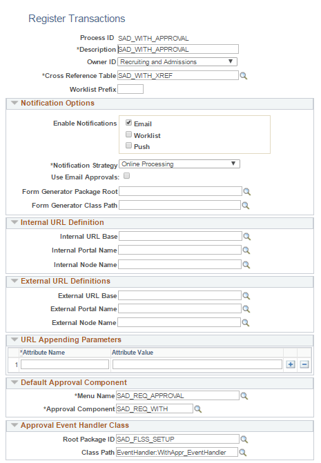

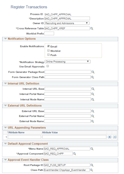

Registering Information with Approval Framework

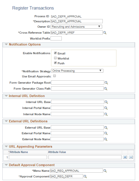

Use the Register Transactions page to register an approval transaction with Approval Framework. This is the page you use to create a process ID. For information about using the Register Transactions page, see PeopleSoft Approval Framework, Defining the Approval Transaction Registry.
Campus Solutions provides the following transaction setup for each request that applicants can submit through Self Service in Fluid user interface.
This example illustrates the fields and controls on the Register Transactions page for Deferrals Requests in Self Service Fluid User Interface.
This example illustrates the fields and controls on the Register Transactions page for Withdrawal Requests in Self Service Fluid User Interface.
This example illustrates the fields and controls on the Register Transactions page for Change in Program Plan Requests in Self Service Fluid User Interface.

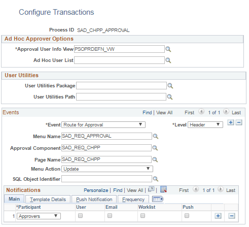

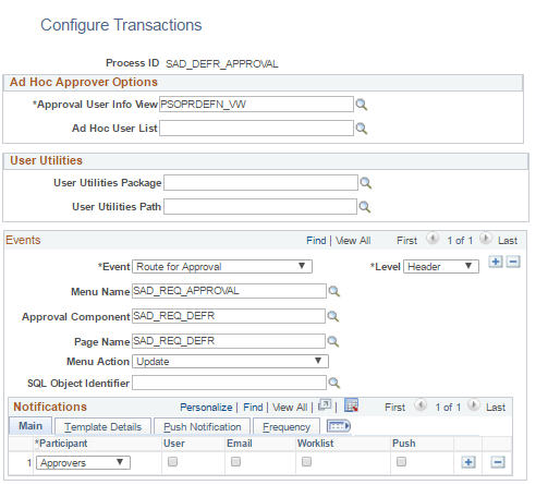

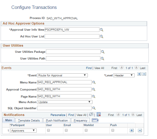

Configuring Approval Transactions
Campus Solutions provides sample process IDs. For each process ID, a Configure Transactions page is set up. The Configure Transactions page is where you select and define elements that determine what triggers a notification, who receives the notification, and the content of the notification. Notifications are mapped to work with the approval transaction registry. For information about configuring approval transaction, see PeopleSoft Approval Framework, Defining the Approval Transaction Registry.
This example illustrates the fields and controls on the Configure Transactions page for Deferral Requests in Self Service Fluid User Interface.
This example illustrates the fields and controls on the Configure Transactions page for Withdrawal Requests in Self Service Fluid User Interface.
This example illustrates the fields and controls on the Configure Transactions page for Change Program Plan Requests in Self Service Fluid User Interface.

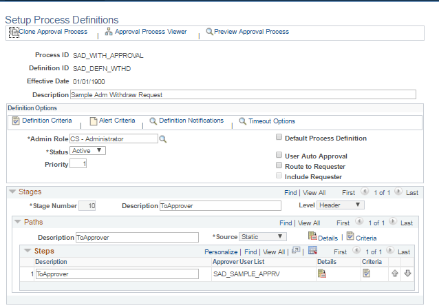

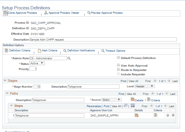

Defining the Approval Definition Process

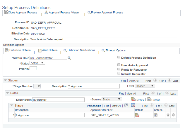

The approval process definition determines the flow of the approval. The approval process consists of stages, paths, and steps. Campus Solutions provides the following process definition setup for each process ID. Your institution may want to create its own definition IDs because it is at this level where approvers, notifications, and the process flow is defined. You associate the definition ID to one of the process IDs. On the Self Service Requests page, you associate the process and definition IDs to a sequence number under the high level keys Institution, Career, and Term. By linking the Definition ID to a sequence, you can customize which Approver User List to invoke for the workflow processing. If there are common attributes among the setup sequences, then one User List could certainly be reused.
For information about Approval Framework process definition, see PeopleSoft Approval Framework, Setting Up Approval Framework Process Definitions.
This example illustrates the fields and controls on the Setup Process Definitions page for Deferral Requests in Self Service Fluid User Interface.
This example illustrates the fields and controls on the Setup Process Definitions page for Withdrawal Requests.
Setup Process Definitions page for Withdrawal Requests in Self Service Fluid User Interface
This example illustrates the fields and controls on the Setup Process Definitions page for Change Program Plan Requests in Self Service Fluid User Interface.
