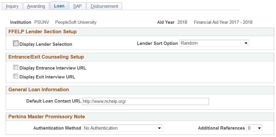

Displaying Lender Selection
Access the Loan page (Set Up SACR, and then Common Definitions, and then Self Service, and then Financial Aid, and then Self Service Options, and then Loan).
This example illustrates the fields and controls on the Loan page. You can find definitions for the fields and controls later on this page.
Loan page
Use this page to set up lender selection for the student and ensure that the preferred lenders are set up. You might have set up lenders while processing FFELP loans.
FFELP Lender Section Setup
Field or Control Description
Display Lender Selection
Select x to display the lender selection on the students' self-service pages.
Lender Sort Option
If you selected the Display Lender Selection check box, select Random or Sequence Number to control how the lender list is displayed in self-service:
Random (default) results in the lenders being displayed in a different random order each time the student accesses the Lender Selection page.
Sequence Number results in lenders being displayed based on the sequence number that was assigned to each lender on the Identify Self-Service Lenders page.

Controlling the Display of Loan Counseling Links
Loan counseling can be handled by the administrator or in Self Service by the student. When the student completes loan counseling for an award that requires an entrance interview, the loan is disbursed.
Entrance Exit Counseling Setup
These check boxes control the display of the Entrance and Exit fields on the Award Details > Loans page. If you do not want to display a link at certain times of the year, clear the check box.
Display Entrance Interview URL
To activate an entrance interview link for loan counseling, select this check box. The URL is defined on the Loan Counseling page.
Display Exit Interview URL
To activate an exit interview link for loan counseling, select this check box. The URL is defined on the Loan Counseling page.
For more information regarding Loan Counseling Setup, see:
Defining General Loan Information
Enter a URL to enable students to access more detailed loan information. This URL can link students to an already existing intranet loan page or to an external loan service provider for which you have established a relationship. This link is available only if the loan has been originated in the system. The URL appears on the Financial Aid - Loan Application Information page.
Setting up Options for eMPN Processes
Perkins Master Promissory Note
Use these options to support your eMPN processes and dynamically adjust the Self-Service page components within the eMPN process.
Authentication Method
Indicate the verification method for authenticating a student for eMPN. If you select Birthdate, Personal Identification Number, or National ID Number, students must enter the required information to authenticate and continue with the eMPN process. If you select No Authentication, the system does not prompt for authentication information.
You define a student's birth date, national ID number, and PIN in Campus Community. The system always uses the student's primary national ID number for authentication purposes.
Additional References
Indicate the number of required references (0, 1, 2, or 3) in addition to the required two references collected to complete the eMPN.
