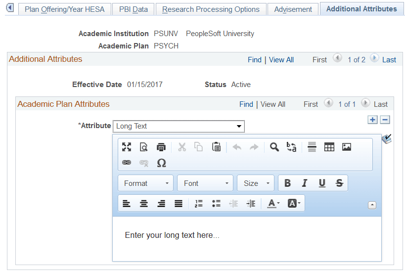

Additional Attributes
ACADEMIC_PLAN_CAF
Set Up SACR, and then Foundation Tables, and then Academic Structure, and then Academic Plan Table, and then Additional Attributes
Define academic plan Common Attribute Framework (CAF) attribute values.
Note: This page is available only after adding common attributes for the Academic Plan CAF Table attribute record using the CSS_CAF_REC_ATTRIBUTE component.

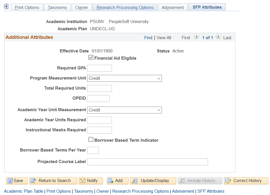

Student Financial Planning (SFP) Attributes
ACADEMIC_PLAN_SFP
Set Up SACR, and then Foundation Tables, and then Academic Structure, and then Academic Plan Table, and then SFP Attributes
Define the academic plan attribute values for SFP.

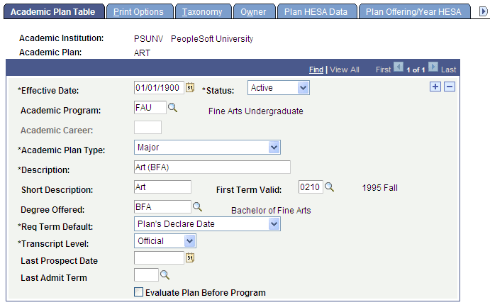

Describing Academic Plans
Access the Academic Plan Table page (Set Up SACR, and then Foundation Tables, and then Academic Structure, and then Academic Plan Table, and then Academic Plan Table).
This example illustrates the fields and controls on the Academic Plan Table page. You can find definitions for the fields and controls later on this page.
WARNING:
If you modified the academic program or academic career to which an academic plan belongs, you must first deactivate the academic plan by inserting a new row and entering the status of inactive. Then, you must add another new row to tie the academic plan to a different academic program or academic career. This procedure ensures proper functionality of academic plan prompts throughout the system.
Field or Control Description
Academic Program
Enter the academic program or an academic career to which this academic plan belongs. To require that a student be admitted to a specific academic program before declaring the academic plan, enter an academic program to link to this academic plan.
Academic Career
Enter an academic career to link to the academic plan if you want students in any academic career to be able to declare the academic plan. For example, an institution might enable all undergraduates to declare computer science as a major (academic plan), regardless of whether students are in a liberal arts program or an engineering program.
Academic Plan Type
Select a type for this academic plan, such as Major, Minor, or Concentration. You can modify these translate values.
First Term Valid
Enter the first term in which students can be admitted to the academic plan. You cannot admit students to the academic plan before the term that you specify. If you enter the term 0000, you can admit students to the plan for any term. When you convert data to the PeopleSoft system, be sure that you select a first valid term that is appropriate for the preexisting data for each academic plan. This field is optional.
Note: Students can modify this plan when their admit term is prior to this term as long as the effective date of the modification is greater than or equal to the start date of this term.
Degree Offered
Enter the degree offered for completion of the academic plan. If the institution offers dual degrees, you must establish separate academic plans for each degree or create a combined degree, such as B.A./B.S. The system creates degree records according to the definition of the academic plan. Therefore, if a student graduates with dual degrees and the degrees are the same—such as an English B.A. and a psychology B.A.—the system creates one degree record. However, if a student graduates with dual degrees and the degrees are different—such as an English B.A. and a biology B.S.—the system creates two degree records, one for each degree.
Req Term Default (requirement term default)
Select the default term for which the system begins accumulating requirements for the academic plan. You can override the default value for individual students on the Student Plan page. Modification to these translate values requires significant programming.
Note: Set this default so that, when you analyze completion requirements for an academic plan, you know which set of requirements to use. Requirements can change over time.
Transcript Level
Select a transcript level to determine the types of transcripts on which the system includes the specified data. Values are: Not Print, Official, Unofficial, Stdnt Life (student life), and Degr Prog (degree progress).
Last Prospect Date
Enter the latest date that a plan can be populated for a new prospect record. You cannot assign a plan to a prospect if the system date is greater than the last prospect date.
Last Admit Term
Enter the last term in which students can be admitted to the academic plan. You cannot admit students to the academic plan after the term that you specify. The system will compare the admit term used in the student's application to this last term valid value. If the admit term is greater than this value, then the program is not available to the user. This field is optional.
Evaluate Plan Before Program
Select to alter reporting sequences. This check box is a feature of PeopleSoft Academic Advisement.

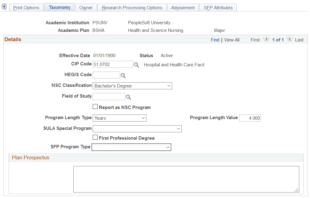

Setting Up Taxonomy
Access the Taxonomy page (Set Up SACR, and then Foundation Tables, and then Academic Structure, and then Academic Plan Table, and then Taxonomy).
This example illustrates the fields and controls on the Taxonomy page. You can find definitions for the fields and controls later on this page.
First Professional Degree
For National Student Clearinghouse (NSC) reporting, program level data is sourced from the Academic Plan Table. You must enter a value in the following fields: CIP Code, NSC Classification, Program Length Type, Program Length Value, and SULA Special Program.
See:
Student Records: Setting Up For NSC Program Level Reporting
Student Records: Understanding Consolidate Academic Statistics Process Calculations
Student Records: Producing NSC Extracts
CIP Code (Classification of Institutional Programs code)
Enter the CIP code for this academic plan. CIP codes are delivered with the system as translate values. You can modify CIP codes on the CIP Code Table page.
HEGIS Code (Higher Education General Information Survey code)
Enter the HEGIS code for this academic plan. HEGIS codes are delivered with the system as translate values. You can modify HEGIS codes on the HEGIS Code Table page.
NSC Classification (National Student Clearinghouse Classification)
Enter a NSC Classification. NSC Classification values are delivered with the system as translate values.
The system uses this value to derive a Class/Credential Level for each student in the NSC enrollment extract.
Note: If you enter a value of Bachelor's Degree here, you must also enter a value (for example Sophomore) in the NSC Level Category field on the Academic Level Table page.
See Defining Academic Level and Load Rules.
Field of Study
Enter a field of study for the academic plan.
Report as NSC Program
Select to identify a plan as one that should be reported as a program for NSC reporting purposes. When this check box is selected, all related NSC fields (CIP Code, NSC Classification, Program Length Type/Value, SULA Special Program) must have values.
Program Length Type
Select the unit of time you want to use to define the Program Length: Weeks, Months, or Years.
Enter the number of weeks, months, or years for the length of the Program.
SULA Special Program (Subsidized Usage Limit Applies special program)
Select a SULA Special Program. Values include:
  • 2-year Bachelor's Degree (two-year bachelor's degree) – A bachelor's degree program that requires an associate degree or the successful completion of at least two years of postsecondary coursework as a prerequisite for admission into the program.
  • Non-Cred Teacher Cert Pgm (non-credential teacher certification program) – A program that does not lead to a degree/certificate at an institution but leads to a State credential required for teaching.
  • Not Applicable – Not applicable.
  • Prep Crsewk Grad Prof Pgm (preparatory coursework graduate program) – Enrollment in preparatory coursework necessary for enrollment in a graduate or professional program.
  • Prep Crsewk Ugrad Program (preparatory coursework undergraduate program) – Enrollment in preparatory coursework necessary for enrollment in an undergraduate or professional program.
  • Selective Admission Assoc Degree (selective admission associate degree) – An associate’s degree program that:
    1. Requires an associate degree or the successful completion of at least two years of postsecondary coursework as a prerequisite for admission.
    2. Admits only a selected number of applicants based on additional competitive criteria which may include entrance exam scores, class rank, grade point average, written essays, or recommendation letters.
    3. Provides the academic qualifications necessary for a profession that requires licensure or certification by the State in which the coursework is offered.
Note: If this field is left blank, and the corresponding field is also blank in on a student’s FA Term record, then the field on the student’s FA Term is populated in the following ways: 1. FA Term Build (online and batch) populates this field as "Not Applicable". 2. The SULA Application Engine Request process populates this field as "Not Applicable". 3. Manual updates to the FA Term > Statistics page auto-populate this field as "Not Applicable".
See Financial Aid: Setting Up 150 Percent Direct Subsidized Loan Limit (SULA).
If selected, the SAFI element FirstProfessionalDegreeIndicator is true. This field is reserved for SFP integration.
SFP Program Type
Select to identify the COD Credential Level for the SAFI element ProgramType. This field is reserved for SFP integration.
Plan Prospectus
Enter descriptions of the academic plan, such as information about special programs, faculty, and associated societies. You can then create a separate advisement report querying this field and print the report for brochures and other documentation.

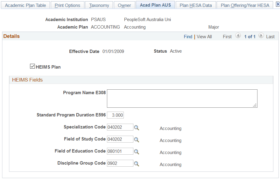

(AUS) Setting Up Australian Academic Plans
Access the Acad Plan AUS page (Set Up SACR, and then Foundation Tables, and then Academic Structure, and then Academic Plan Table, and then Acad Plan AUS).
This example illustrates the fields and controls on the Acad Plan AUS. You can find definitions for the fields and controls later on this page.
Acad Plan AUS page
Department of Industry, Innovation, Science, Research and Tertiary Education (DIISRTE) was previously known as DEEWR and before that as DEST.
HEIMS Plan
Select to activate theField of Study Code,Field of Education Code, andDiscipline Group Code fields. Select this check box to designate the plan for DIISRTE reporting. The Course Code field in DIISRTE reporting uses either the student's plan (when marked as a DEST plan) or the student's program. Course Code, element 307, is important for DIISRTE reporting.
HEIMS Fields
Program Name E308
Enter the program name for this academic plan.
Standard Program Duration E596
Enter the standard duration of the course of study.
Specialization Code
Enter a specialization code for this academic plan. The drop-down list contains the Field of Study Classifications you set up.
Field of Study Code
Enter a field of study code for this academic plan. Define field of study codes on the Field of Study Table page.
Note: Field of study codes have been replaced by field of education codes for terms after year 2000. Field of study codes are retained for historical reference.
Enter a field of education code for this academic plan. This code is used to derive the DIISRTE reporting element 464 Discipline Group Code. The element can be derived from either the plan or the course offering. Field of Education is defined by the Australian Standard Classification of Education as issued by the Australian Bureau of Statistics.
Enter a discipline group code for this academic plan. Define discipline group codes on the Discipline Group Code Table page.

Defining Additional Academic Plan Attributes
Access the Additional Attributes page (Set Up SACR, and then Foundation Tables, and then Academic Structure, and then Academic Plan Table, and then Additional Attributes).
This is an example of an attribute that can be used on the Additional Attributes page.
Additional Attributes (Academic Plan) page
Use this page to enter and review Common Attribute fields associated with the academic plan.
The Academic Plan Table CAF record (ACAD_PLAN_CAF) is delivered and associated with the Academic Plan Table (ACAD_PLAN_TBL) record.
This page appears only after adding common attributes to the Academic Plan CAF Table attribute record using the record context (CSS_CAF_REC_ATTRIBUTE) component.
On the Record Context page, you must select the Inline Subpage option in the Attribute Display Type group box. The other option, Secondary Page, is not a supported display type for attributes associated with the Academic Plan Table.
See Campus Community Fundamentals: Defining a Common Attribute.
See Campus Community Fundamentals: Associating a Common Attribute to a Record.
Defining Student Financial Planning (SFP) Attributes
Access the SFP Attributes page (Set Up SACR, and then Foundation Tables, and then Academic Structure, and then Academic Plan Table, and then SFP Attributes).
This example illustrates the fields and controls on the SFP Attributes page
SFP Attributes (Academic Plans) page
Use this page to enter and review SFP Attribute fields associated with the academic plan.
SFP Attributes Fields
Financial Aid Eligible
Select to indicate that students in the academic plan are eligible for financial aid.
Required GPA
This is the program’s GPA that is required of a student in order to pass a component of the SAP evaluation.
Program Measurement Unit
Defines if a program is credit hour or clock hour.
Total Required Units
Defines the number of units required to complete the student's program.
OPEID
COD requires schools to report a student's physical campus of attendance as the Enrollment School Code using the 8 digit OPEID codes assigned to your institution.
Academic Year Unit Measurement
Academic Year Units Required
This value determines if the program is a Credit or Clock Hour Program.
Instructional Weeks Required
Represents the Academic Year Definition in terms of instructional weeks required to complete an Academic Year. For Non-Term Programs, will ensure the student meets the minimum number of instructional weeks before completing the academic year. For Term Programs, we rely on the schools setting the academic terms/years to meet the regulatory minimum.
Borrower Based Term Indicator
Select if the terms in the Student Academic and Financial Information (SAFI) message should not be aggregated by the regular Academic Year.
Borrower Based Terms Per Year
Enter the number of terms per Borrower Based Academic Year. If you populate this field, ensure that the Borrower Based Term Indicator check box is selected.
Projected Course Label
If left blank, the default value of Projected Course Enrollment will be used.
