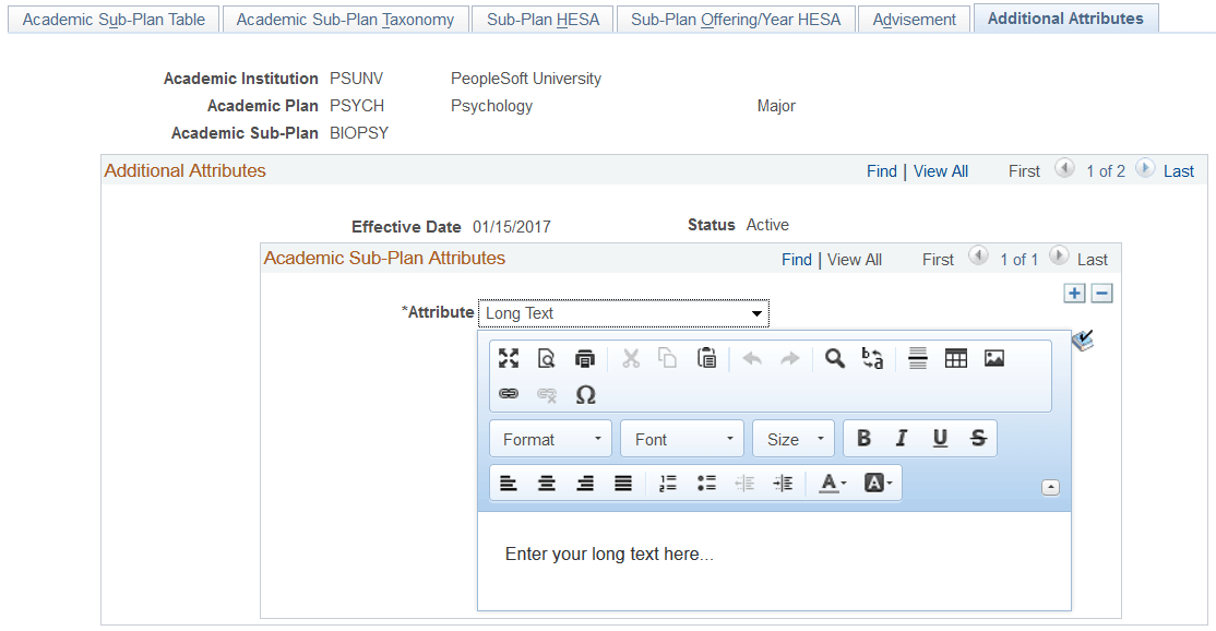

Defining Additional Academic Subplan Attributes
Access the Additional Attributes page (Set Up SACR, and then Foundation Tables, and then Academic Structure, and then Academic SubPlan Table, and then Additional Attributes).
This is an example of an attribute that can be used on the Additional Attributes page.
Additional Attributes (Academic Sub-Plan) page
Use this page to enter and review Common Attribute fields associated with the academic subplan.
The Academic Subplan CAF Table record (ACAD_SUBPLAN_CAF) is delivered and associated with the Academic Plan Table (ACAD_SUBPLN_TBL) record.
This page appears only after adding common attributes to the Academic Subplan CAF Table attribute record using the record context (CSS_CAF_REC_ATTRIBUTE) component.
On the Record Context page, you must select the Inline Subpage option in the Attribute Display Type group box. The other option, Secondary Page, is not a supported display type for attributes associated with the Academic Subplan Table.
