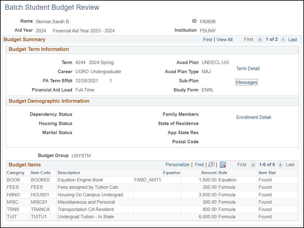

Viewing Batch Student Budget Review
Access the Batch Student Budget Review page (Financial Aid, and then Budgets, and then View Batch Budget Details, and then Batch Student Budget Review).
This example illustrates the fields and controls on the Batch Student Budget Review page. You can find definitions for the fields and controls later on this page.
Use this page to view and confirm information after running these budget batch processes:
The information that you view here is in a work table, so, after you run a process, this page may be blank depending on the Table Maintenance options that you set.
  • After running the Stdnt Bdgt Assign - Select process (FAPBDGTS), use this page to ensure that the correct budget categories were selected for the student and that the correct student population was selected during the batch.
  • After running the Stdnt Bdgt Assign - Equations process (FAPBDGTE), use this page to ensure that the budget item amount is accurate for those budget items determined by equation.
  • After running the Stdnt Bdgt Assign - Formulas process (FAPBDGTF), use this page to ensure that the budget item amount is accurate based on the budget formula assigned.
  • After running the Stdnt Bdgt Assign - Tuit/Tree process (FAPBDGTT), use this page to ensure that the budget item amount is accurate for those budget items determined by either tuition calculation or budget trees.
  • After running the Stdnt Bdgt Assign - Move process (FAPBDGTM), student budgets, use this page to ensure that the budget item is moved successfully during the batch.
Budget Term Information
Field or Control Description
Acad Plan Type (academic plan type)
Displays the type of the academic plan. Values include: Honors, Major, ROTC, and Concentration.
FA Term Effdt (financial aid term effective date)
Displays the effective date and effective sequence of the Financial Aid Term information used to build the budget.
Financial Aid Load
Displays the student's load, determined using the number of financial aid eligible units and level/load rules.
Study Form
Displays the type of study the student is engaged in. Values include: Detached, Enrollment, Abroad, and Candidacy.
Term Detail
Click to access the Budget Term Detail page and view additional information from the student's Financial Aid Term record. You can check for information that can cause errors using this page.
Messages
Click to access the Student Budget Messages page and view error messages generated during budget assignment.
Budget Demographic Information
Family Members
Displays the number of people in the student's family, as reported on the student's application (ISIR, Profile, Institutional Application).
Housing Status
Displays the student's housing type: on campus, off campus, with relatives, or with parents.
App State Res (application state of residence)
Displays the student's state of residence, as reported on the student's application.
Enrollment Detail
Click to access the Budget Enrollment Detail page and view the student's enrollment plans and sports participation information for the aid year. You can check for information that can cause errors using this page.
Budget Item Information
The amount of budget information that appears on this page depends on the number of budget assignment processes you have run. This table lists the processes:
Process Fields With Data
Category, Rule, and Status
For budget categories with an equation processing rule: Category, Item Code, Description, Amount, Rule, Status.
For budget categories with a formula processing rule: Category, Item Code, Description, Amount, Rule, and Status
For budget categories with a tuition or tree processing rule: Category, Rule, and Status
Budget Group
Identifies the generic budget group used for the batch.
Equation
Displays the amount equation used to determine the amount.
Rule
Indicates whether the budget assignment process uses a formula, tree, equation, or other assigned possibilities—such as tuition calculations—to determine the amount assigned to the student for this budget category.
Item Stat (item status)
Select one of these values:
Found: The budget assignment process was able to use the indicated rule to assign a budget item and amount to the student for the budget category.
Moved: The budget amount has been moved to the student's record.
Selected: This budget category has been selected for processing during the Stdnt Bdgt Assign - Formulas process (FAPBDGTF) or the Stdnt Bdgt Assign - Tuit/Tree process (FAPBDGTT).
Warning: The Stdnt Bdgt Assign - Formulas process (FAPBDGTF) or the Stdnt Bdgt Assign - Tuit/Tree process (FAPBDGTT) could not assign a budget item and amount for this budget category to the student.

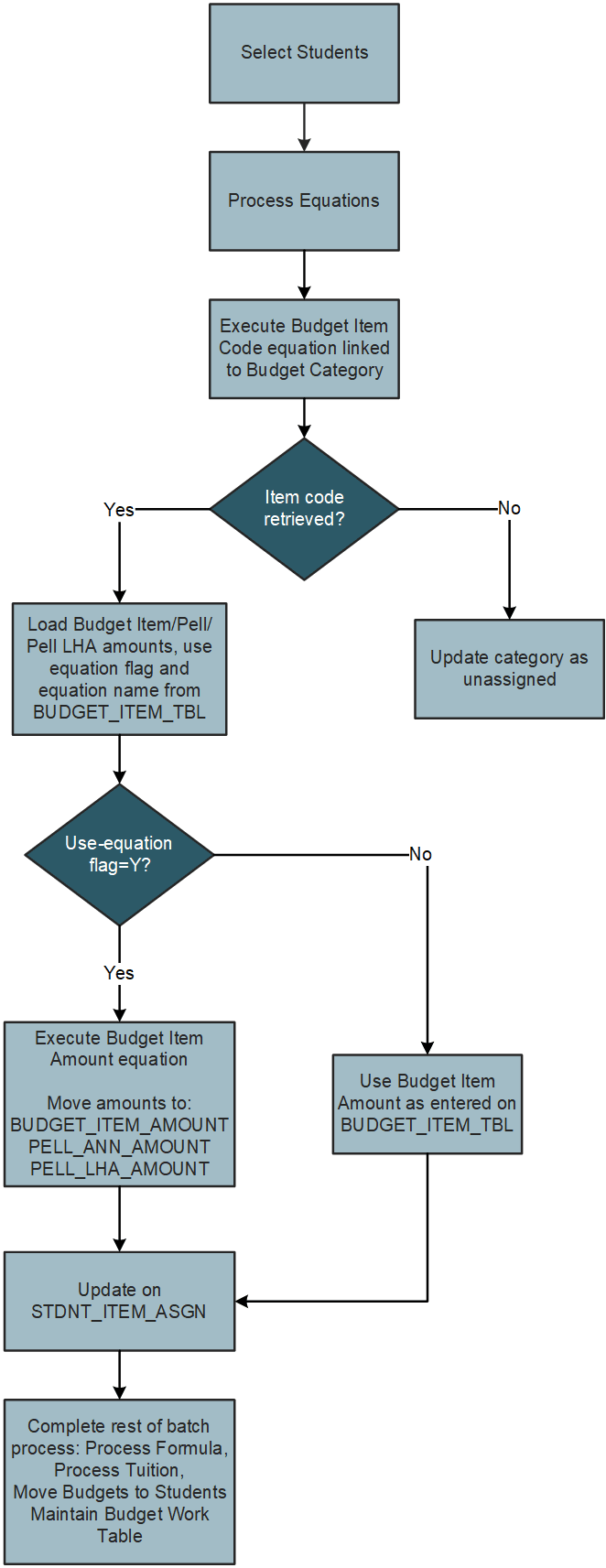

Processing Equations
Access the Batch Budget Assignment - Process Equations page (Financial Aid, and then Budgets, and then Assign Budgets, and then Process Formula, and then Batch Budget Assignment - Process Equations).
Budget Assignment Using Equations
This process passes the following fields, which are also key fields on STNDT_BDGT_ASGN:
  • EMPLID
  • AID_YEAR
  • INST
  • STRM
  1. Enter the institution and aid year for which you want to assign budget items and amounts.
    When you tab out of the Aid Year field, the system displays the table maintenance options for each career/term combination you set up on the Create Budget Run Controls page.
  2. Run the Stdnt Bdgt Assign - Equations (student budget assignment - equations) process (FAPBDGTE) when you are ready to assign budget items and amounts.
  3. After the process runs, view the information on the Batch Student Budget Review page to ensure that the budget item amount is accurate based on the budget formula assigned.

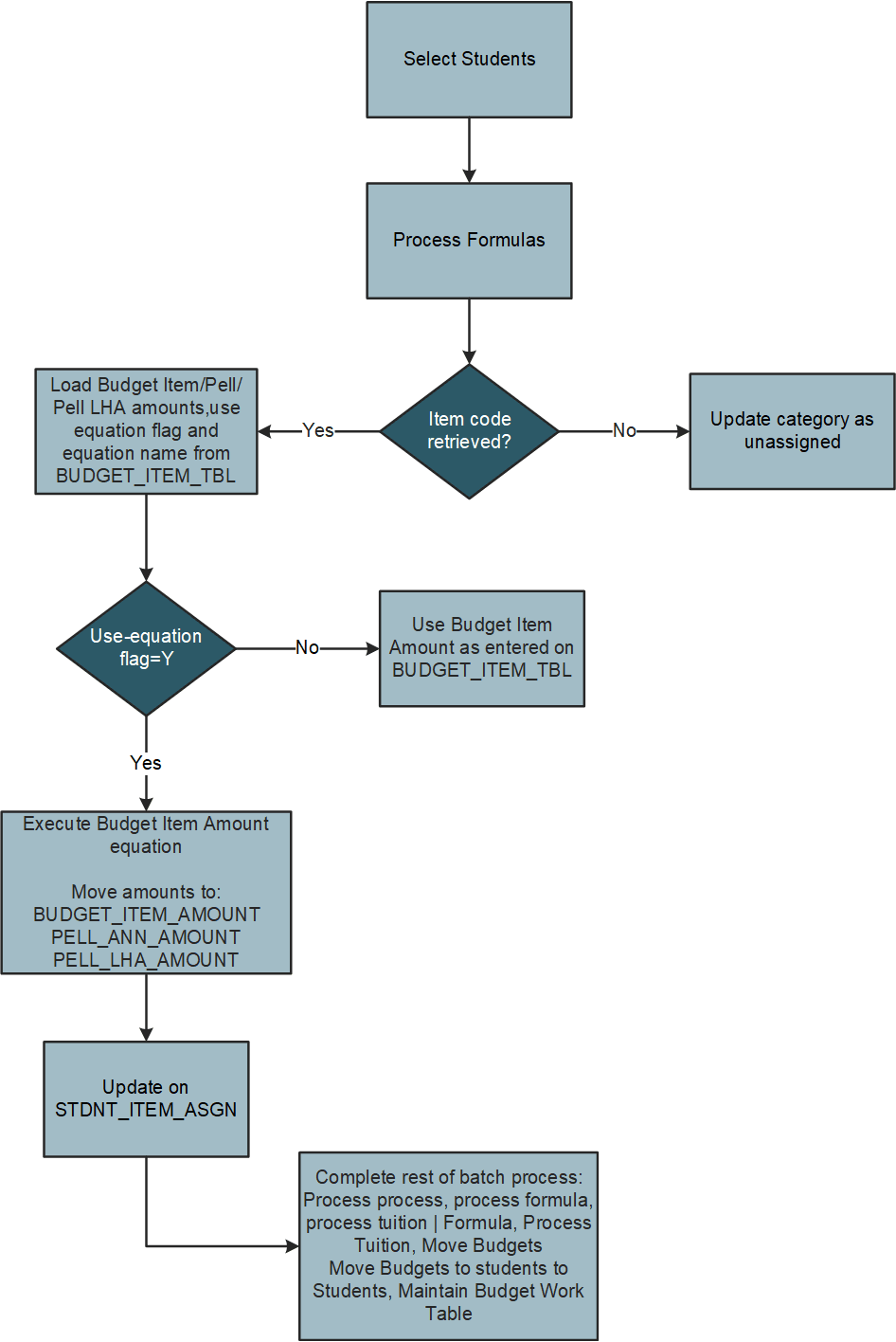

Processing Formulas
Access the Batch Budget Assignment - Process Formulas page (Financial Aid, and then Budgets, and then Assign Budgets, and then Process Formula, and then Batch Budget Assignment - Process Formulas).
Budget Assignment Using Formulas
  2. Run the Stdnt Bdgt Assign - Formulas (student budget assignment - formulas) process (FAPBDGTF) when you are ready to assign budget items and amounts.
