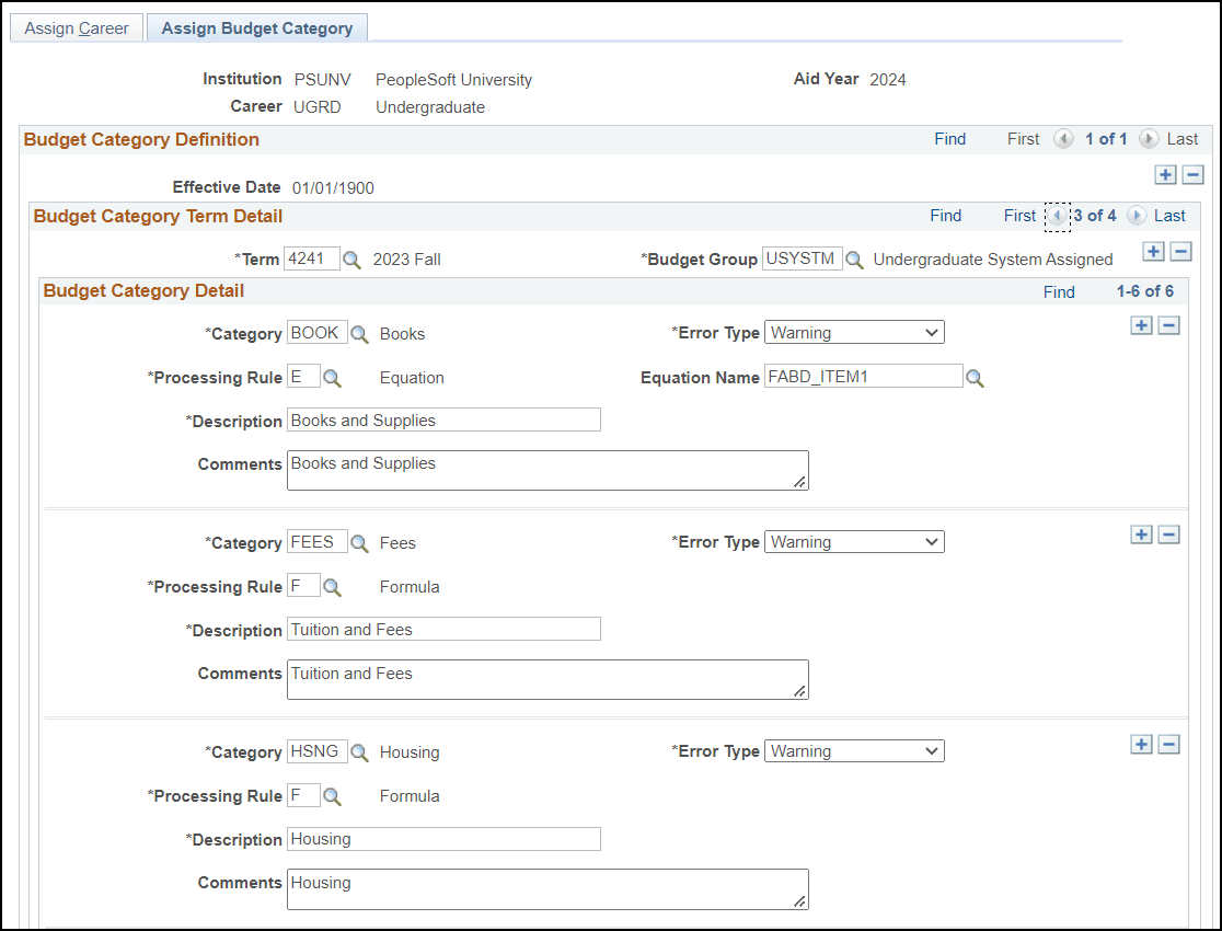

Assigning Automated Budget Categories
Access the Assign Budget Category page (Set Up SACR, and then Product Related, and then Financial Aid, and then Budgets, and then Budget Assignment, and then Assign Budget Category).
This example illustrates the fields and controls on the Assign Budget Category page. You can find definitions for the fields and controls later on this page.
If you have not set up generic budget groups to use with background processing, you must list each budget category individually. During background budget assignment, the system assigns the appropriate budget item and amount to each student using the budget formulas or trees that you set up for each budget item.
Field or Control Description
Bdgt Group (budget group)
If you have established generic budget groups for batch budget processing, enter the budget group code. The page automatically displays the budget categories that you assigned to this budget group.
Category
Enter the budget category to assign to the selected term's budget. Make sure that the category is valid for the selected term. For example, a summer term might not include housing costs, while a fall term includes housing costs.
Error Type
Select the action to take when the system encounters an error in assigning a value to a student for this budget category. Values are:
None: The system does not take any action when it encounters an error.
Skip: The system skips the record for which it encountered the error and does not assign a value to that record.
Stop: The system stops all processing when it encounters an error.
Warning: The system warns you of the error but continues processing. No budget item is assigned to the student for the budget category for which the system encountered the error. The student receives a zero dollar amount for that budget category and a warning that the student failed the budget assignment criteria for that budget category.
For example, you might assign the child care budget category a skip error type because not all students are parents and, therefore, would not be eligible for a dependent child care allowance. You might assign the fees budget category a stop type because all students need to have a particular fee amount in their budgets. You might assign a warning for the books budget category based on the student's career. If the career does not match the book criteria defined in the budget assignment setup, the system does not assign a book budget item and displays a warning. You can then reevaluate the assignment criteria to ensure correct definition.
Processing Rule
Select whether a formula, tree, or other assigned possibilities—such as tuition calculations—determine the amount assigned to the student for this budget category. Values are:
E - Equation Based Calculation: The system uses an equation to determine the budget item amount assigned to the student.
F - Formula Based Calculation: The system uses a budget formula to determine the budget item amount assigned to the student.
N - Tree Nodes: The system uses a budget tree to determine the budget item amount assigned to the student. When you select this option, a Name field appears and displays the name of the tree used to define the budget category.
T - Tuition: The system calculates the student's tuition budget item amount by running the Tuition Calculation routine. The Tuition Calculation routine can be run either by Student Financials or Financial Aid; the Use Actual/Projected Tuition check box on the Create Budget Run Controls page specifies which Tuition Calculation routine to use.
Equation Name
If using the Equation Based Calculation, select the user-defined Budget Item Code equation to use to determine the budget item code assigned to the student.
The equations available for selection are the ones set with the Application Prompt ID of FA Budgets Item Code on the Equation Editor page.
Name
If using Tree Nodes, displays the name of the tree used to determine which budget item is assigned to a student.
Description
You can edit the default description to specify how the rule is used. This can be different from the description on the Create Budget Categories page. For example, the book budget category might have a description of Books on the Create Budget Categories page, but be listed as Book Allowance Fall 2002 on this page.
Comments
The default value is the budget category description, but you can edit the description to provide more information about the processing of this budget category.
Use the top set of scroll arrows to view rows with different effective dates. Use the middle set of scroll arrows to view different terms. Use the bottom set of scroll arrows to view additional budget categories for a specific term and budget group combination.
