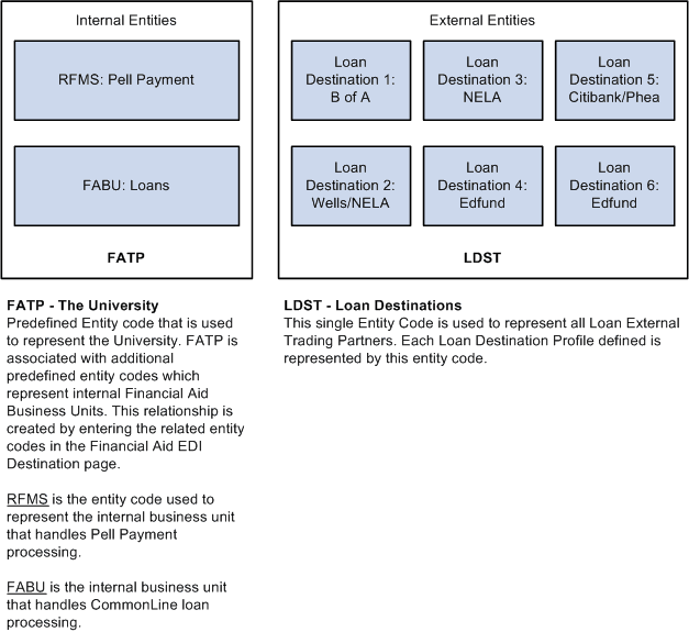

Entity codes define the internal and external entities that are involved in the EDI process. For loan processing, external trading partners are the loan destinations, and internal trading partners are the schools.

Predefined entity codes are provided. Use FABU for school loan offices and LDST for loan destinations. The following illustration shows internal and external entities and codes.
EDI Entity Codes for CommonLine 4
EDI (electronic data interchange) Entity Codes for CommonLine 4
