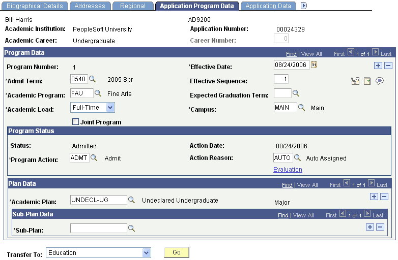

The applicant in our example was denied in his requested program (LAU), but was accepted into the alternate program (FAU), as illustrated in the following page shot. Maintain Applications is found by selecting Student Admissions, and then Application Maintenance, and then Maintain Applications.
This is an example of Application Program Data page (2 of 2).
Example Application Program Data page (2 of 2)
Note that the program number is now 1. The Alternate Programs process inserted a new row and incremented the program number by one. Thus, the program action of DENY for LAU still exists in the student's record. This new row contains the new academic program FAU (the alternate program) and note that the program action is ADMT. The Alternate Programs process also updated the remaining parameters that you selected on the Alternate Program Addition page, such as the action reason, campus, and academic load.
By evaluating this applicant in an alternate program, you were able to admit a person whom you would have otherwise denied.
