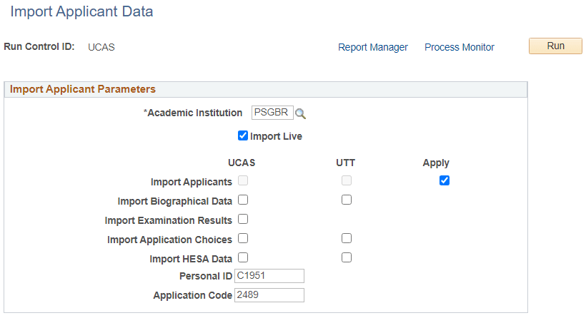

The Import Applicant Data process allows data to be imported from:
  • UCAS iv views (ODBC) or applicant methods (XML), if you selected UCAS on the UCAS Configuration page
  • Apply applications, if you selected Use Apply.
If Import Live is selected, the system imports data into Campus Solutions tables through the staging tables based on the import options selected for UCAS and Apply. You can select Import Live only if you selected it in UCAS Configuration.
  • If Personal ID and Application Code are specified, all application records for the applicant are imported irrespective of time stamp.
  • If Personal ID and Application Code aren't selected, records are imported to the staging tables based on the time stamp records for each system. For UCAS, internal time stamp records for each view/method are considered. For Apply, a single internal time stamp record is considered.
    • If there is an internal time stamp record, records with a higher time stamp than the internal time stamp value (set on the previous run of the import) are imported unless Override time stamp is defined, in which case records with a higher time stamp than that value are imported.
    • If there is no internal time stamp record, for UCAS all records are imported. For Apply, records updated since 2020-01-01T00:00:00Z are imported. At the end of the import, the internal time stamp records are updated to reflect the highest imported time stamp value.
    • For XML-link processing, if an Override time stamp isn't defined, the internal time stamp value plus one second is used for the lastUpdated request parameter.

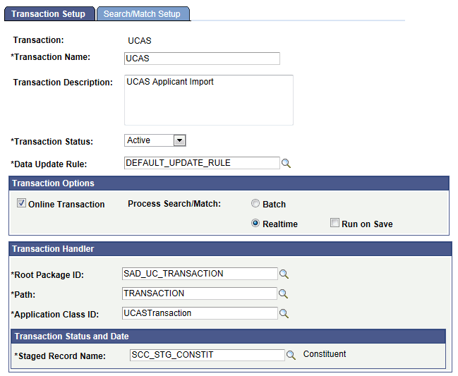

Transaction Setup
SCC_TRANSAC_DTLS
Student Admissions, and then UCAS Processing, and then Import Applicants, and then Transaction Setup
View the delivered UCAS and Apply transactions that you can use in the Transaction Search/Match Setup page. Don't modify any values for these delivered transactions or create new ones.

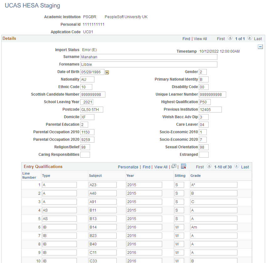

UCAS HESA Staging
SAD_UC_I_IVSTJ
Student Admissions, and then UCAS Processing, and then Import Applicants, and then UCAS Staging Data, and then HESA Staging
View, update, or delete the suspended HESA data stored in the staging tables.

Viewing the Transaction Setup
Access the Transaction Setup page (Student Admissions, and then UCAS Processing, and then Import Applicants, and then Transaction Setup).
This example illustrates the fields and controls on the Transaction Setup page (1 of 2).
Transaction Setup page (1 of 2) for UCAS (Universities and Colleges Admissions Service)
This example illustrates the fields and controls on the Transaction Setup page (2 of 2).
Transaction Setup page (2 of 2) for UCAS (Universities and Colleges Admissions Service)
The system uses the delivered UCAS and Apply transactions to process the incoming UCAS and Apply data. Don't change any values for this transaction.

Importing Applicant Data
Access the Import Applicant Data page (Student Admissions, and then UCAS Processing, and then Import Applicants, and then Import Applicant Data).
This example illustrates the fields and controls on the Import Applicant Data page. You can find definitions for the fields and controls later on this page.
Field or Control Description
Academic Institution
Enter the academic institution for which you want to import data.
Import Live
Select if you want the import process to load the data into the staging tables and then into the Campus Solutions tables. If you don't select this checkbox, the import process loads the data from the staging tables into the Campus Solutions tables.
By default, the system selects this checkbox if the Import Live checkbox on the UCAS Configuration page is selected.
Import Applicants
Indicates whether the process imports applicant data from UCAS or Apply.
Either one of these options can be selected, but not both.
  • The system selects the UCAS checkbox if you selected UCAS or on the UCAS Configuration page.
    If the system selects the UCAS checkbox, the process imports applicant data from UCAS ivStarN, ivStarA, and ivStarK views, or UCASApplicantDetail, ApplicantAddressHistory, Applicant Reinstated, and ApplicantAnswer if Use XML for Applicants is selected in UCAS Configuration.
  • When you’re importing applicant data using the Apply API, select the Apply checkbox for Import Applicants.
    Note:The Apply checkbox is enabled only when you select Use Apply on the UCAS Configuration page.
See Preparing for UCAS and Teacher Training Data Processing.

Import HESA Data
Select the UCAS checkbox if you want to import the ivStarj view or the UCASHesaData object.

Defining Timestamps for Reimporting Data
The Personal ID and Application Code fields are available only when you select the Import Live checkbox on this page.
Note: By using the Personal ID and Application Code fields, you can specify only one applicant for a single run of the Import Applicant Data process and you need to ensure that the correct UCAS or Apply import check boxes are selected on this page. Also, note that if you specify a personal ID, then the application code is required. Application code is expanded to a 10–digit value to allow a 10–digit Apply application ID.

  • Import HESA Data
    odbc-link View XML-Link Object Staging Record Record
    ivStarJ
    UCASHesaData
    SAD_UC_I_IVSTJ
    SCC_HE_PERS_FLD
    SSR_HE_INST_FLD
    EXTERNAL_SYSTEM
    ivStarJ
    UCASHesaData
    SAD_UC_I_IVSTJQ
    SSR_HE_QUAL_ENT
    See also Configuring the Processing of Imported HESA Data

Importing HESA Data
A subprocess is called by the Import Applicant Data process that imports HESA reporting data from UCAS when the UCAS check boxes for Import HESA Data is selected on the Import Applicant Data page. For more information, see Importing Applicant Data.
Business Rules
If you select the UCAS checkbox for the Import HESA Data sub-process, either the UCAS view ivStarJ (via odbc-link) or UCASHesaData (via XML-link) is imported to the staging table then processed.
The following tables are loaded if this subprocess is selected:
UCAS View/XML Object Staging Table Base Table
IVSTARJ/ivStarJU
UCASHESAData
PS_SAD_UC_I_IVSTJ
  • Person HESA Data (PS_SCC_HE_PERSON, PS_SCC_HE_PER_FLD)
  • HESA Instance Data (PS_SSR_HE_INSTANCE, PS_SSR_HE_INST_FLD, PS_SSR_HE_QUAL_ENT)
  • External System ID
General Process Logic
The following is the logic for the Import HESA Data subprocess:
  • The subprocess considers the Update Matriculated Students checkbox setting on the UCAS Configuration page for processing External System ID records.
  • The subprocess updates HESA-specific records regardless of the Update Matriculated Students checkbox setting to ensure that the records are synchronized with the corresponding UCAS view. Updates are controlled by the fields on the HESA Data Import tab on the UCAS Configuration page.
For more information about the UCAS Configuration page, see Setting Up UCAS and Teacher Training Options.
Prerequisites
For a successful run of the Import HESA Data sub-process, the Person HESA Data and HESA Instance Data records must have been created for each applicant whose details you want to import.
See Student Records: Creating HESA Instance and Person HESA Data Records for Students.
Import Records to Staging Table
If you have selected the Import Live Data from UCAS checkbox on the UCAS configuration page, then records are imported into the relevant staging table based on the time stamp value of each record. If the time stamp is greater than the internal time stamp for the view, then the record is imported. At the end of the Import Applicant Data process, the internal time stamp is updated with the highest time stamp of the records that have been imported.
Processing of Staging Table Records
For each staging table record with status of New, Pending or Error:
  1. The record is matched to an existing UCAS applicant record in PS_SAD_UC_APPLREC using UCAS Personal ID and Application Code to find the EMPLID, or if applicant record isn't found, then the EMPLID is selected from matching External System ID records with ID type UC.
  2. The imported Surname, Fnames, Birthdate and Gender values are compared with the values in the Campus Solutions primary person record. If the values are different then a message is logged. If a Surname, Fnames, Birthdate or Gender value is different and the Process Mismatched Applicants checkbox is selected, then the system adds a warning message to the log file (for example, “Warning: Personal ID: 0035697369, AppCode:UC01, ID:0278 - SURNAME value doesn't match person record”) and the subprocess continues to process the staging record. If a Surname, Fnames, Birthdate or Gender value is different and the Process Mismatched Applicants checkbox is not selected, the system sets the staging record status to Error. doesn't process the record and adds a message to the log file (for example, “Processing skipped for Personal ID: 0035697369, AppCode:UC01, ID:0278 - SURNAME value doesn't match person record”).
  3. Person HESA Data Update: If a Person HESA Data record exists, then fields are added or updated using the incoming values (see table below). The inserts/updates are done depending on the configuration values for each Staging Field on the UCAS Configuration page. Each staging field value is validated against active codes for the HESA Field defined in UCAS Configuration.
  4. External System ID (SCN/ULN):
    • If the Import checkbox is selected, external System ID records are created or updated based on the imported value and the selected Update Option. For Add/Update, a new effective-dated external ID record is created for the imported value. For Add If Blank, a new external ID is only created if there is no existing ID for the person.
    • Blank staging values and default values that are 999999999 for SCN and 9999999999 for ULN aren't processed.
    • For matriculated students, updates/inserts are done only if the Update Matriculated Students checkbox is selected.
  5. HESA Instance – Entry Profile Data Update:
    • HESA Instance records are selected by matching from existing UCAS application choice records via the related Student Program records
    • Fields are added/updated using the incoming values (see table below) and inserts/updates are done depending on the configuration values for each Staging Field on the UCAS Configuration page. Each staging field value is validated against active codes for the HESA Field defined in UCAS Configuration.
  6. HESA Instance – Entry Profile Data - Entry Qualifications Update
    If the Import Entry Qualifications checkbox is selected, the individual field values are validated against active codes for the corresponding HESA Field.
    Imported entry qualifications are matched to existing records (in PS_SSR_HE_QUAL_ENR) based on TYPE, SUBJECT, YEAR and SITTING and if a record already exists, then the GRADE value is updated, otherwise a new record is created
  7. Records with errors (E) and pending records (P) are retained in the staging table and can be reprocessed once errors are corrected.
Data Mapping
The following table shows the Person Data mapping:
UCAS Value Comment/Format Staging Table Column: PS_SAD_UC_I_IVSTJ Compared with (Page name - Field name)
Surname
Surname
SAD_UC_SURNAME
Names - Last Name (for primary name record)
Fnames
Forenames
SAD_UC_FORNAME
Names - First Name, Middle Name (for primary name record)
Birthdte
Date of Birth
SAD_UC_BIRTHDTE
Biographical Details - Date of Birth
Gender
Gender (1 = Male or 2 = Female)
SAD_UC_GENDER
Biographical Details – Gender
The following table shows the HESA Person Data mapping:
UCAS Value Comment/Format Staging Table Column: PS_SAD_UC_I_IVSTJ PS_SCC_HE_PER_FLD
Carer
HESA Carer code. Validated against the imported HESA codes for HESA Field defined in UCAS Configuration.
SAD_UC_CARER
CARER
Disable
HESA Disability code. Validated against imported HESA codes for the HESA Field defined in UCAS Configuration. (To view the codes that you have imported, select Records and Enrollment, HESA Reporting, Codes and Mappings, Codes).
Your institution may have already imported Disability values which the system will have used to create person Disability/Impairment records.
SAD_UC_DISABLE
DISABILITY
Ethnic
HESA Ethnicity code. Validated against imported HESA codes for the HESA Field defined in UCAS Configuration.
Your institution may have already imported Ethnic values which the system will have used to create person Ethnicity records.
SAD_UC_ETHNIC
ETHNICS
Nation
HESA country code. Validated against imported HESA codes for the HESA Field defined in UCAS Configuration.
Your institution may have already imported Nationality values which the system will have used to create person Citizenship records.
SAD_UC_NATIONALITY
NATION
ReligiousBelief
2-digit code.
SAD_UC_RELBLF
ReligiousBelief
SexualOrientation
2-digit code.
SAD_UC_SEXORT
SexualOrientation
The following table shows the External System ID mapping:
UCAS Value Comment/Format Staging Table Column: PS_SAD_UC_I_IVSTJ Base Table — Column
SCN
Scottish Candidate Number (default is 999999999).
Your institution may have already imported SCN values which the system will have used to create SCN external system ID records. The system doesn't use the default value 999999999.
SAD_UC_ SCN
External System ID – SCN
ULN
Unique Learner Number (default is 9999999999).
Your institution may have already imported ULN values which the system will have used to create ULN external system ID records. The system doesn't use the default value 9999999999.
SAD_UC_ULN
External System ID – ULN
The following table shows the data mapping for HESA Entry Profile:
UCAS Value Comment/Format Staging Table Column: PS_SAD_UC_I_IVSTJ HESA Base Table: PS_SSR_HE_INST_FLD
CareLeaver
Value of 04 indicates if an applicant has been in care for more than 3 months.
Value of 05 indicates if an applicant has been in care for less than 3 months, otherwise 99.
SAD_UC_CARELEAVER
CARELEAVER
Domicile
HESA country code
Your institution may have already imported APR which the system will have used to create person Residency Self-Report records.
SAD_UC_APR
PERMADDCOUNTRY
Estranged
SAD_UC_ESTRANGED
ESTRANGED
ParEd
SAD_UC_PARENTINHE
PAREDE
Postcode
No validation applied.
SAD_UC_POSTCODE
PERMADDPOSTCODE
Previnst
SAD_UC_PRVINST
PREVIOUSPROVIDER
Qualent3
SAD_UC_QUALENT2
HIGHESTQOE
Sec2020
Socio-Economic classification (ReferenceSocialEconomic). For applications up to 2021 cycle these aren't populated For applications from 2022 onwards these are populated using the value from SOC 2020 data.
SAD_UC_SOCECO2020
SECE
Soc2020
SAD_UC_POCC2020
SOC2020
Yrllinst
SAD_UC_YRLLINST
YRLLPROV
The following table shows the data mapping for Entry Qualifications:
UCAS Value Comment/Format Staging Table Column: PS_SAD_UC_I_IVSTJ HESA Base Table: PS_SSR_HE_QUAL_ENT
QualType1 – 30
Validated against imported HESA codes for QUALTYPEID.
SAD_UC_QUALTYPE1 to 30
SSR_HE_QUAL_TYPE
QualSbj1 – 30
Validated against imported HESA codes for SUBJECTID.
SAD_UC_QUALSBJ1 to 30
SSR_HE_QUAL_SUBJ
QualSit1 – 30
S (Summer) or W (Winter). Validated against translate values for SSR_HE_QUAL_SIT.
SAD_UC_QUALSIT1 to 30
SSR_HE_QUAL_SIT
QualGrade1 – 30
Validated against imported HESA codes for ENTRYQUALAWARDRESULT.
SAD_UC_QUALGRADE1 to 30
SSR_HE_QUAL_GRADE
QualYear1 – 30
4-digit Year value. No validation applied.
SAD_UC_QUALYEAR1 to 30
SSR_HE_QUAL_YEAR

Access the Import UCAS Link Data page (Student Admissions, and then UCAS Processing, and then Import Applicants, and then Import UCAS Link Data).
Before running the process for the first time, create an Internal Timestamp record for Applicant Contextual Data with a timestamp value earlier than the records that you want to import from UCAS.
Use this process to import data via the UCAS-link API. This is a separate process from the Import Applicant Data and Import Reference Data to give you more flexible run control options. This allows your institution to choose whether to run the process after importing applicant data via XML-Link.
To use this process, you must have access to the HCCPCSSA1000 permission list.
By default, this checkbox is selected. Selecting this checkbox enables or disables the Import to Staging and Process to Staging Records checkboxes.
Import to Staging
This checkbox is selected if Applicant Contextual Data is selected. This option controls whether API processing is done to load data to the staging record (SAD_UC_I_CONTEXT).
This is selected if Applicant Contextual Data is selected. This option controls whether staging records are processed to the base record (SAD_UC_CONTEXT).
Import to Staging and Process to Staging Records give you the option to choose whether to load data only to staging, only process staging records, or load data to staging and then process staging to the base record.
Here's what happens if you select Import to Staging:
  1. An authentication request is made using the Client ID and Client Secret to check the credentials.
  2. A data request is made using the Configured Cycle and the internal timestamp record for Applicant Contextual Data.
  3. The monitoring point of the data request is periodically checked until the request status is Completed.
  4. If data exists for the request, the data is loaded to the staging record.
  5. If data has been loaded to the staging record, the internal timestamp record for Applicant Contextual Data is created or updated.
