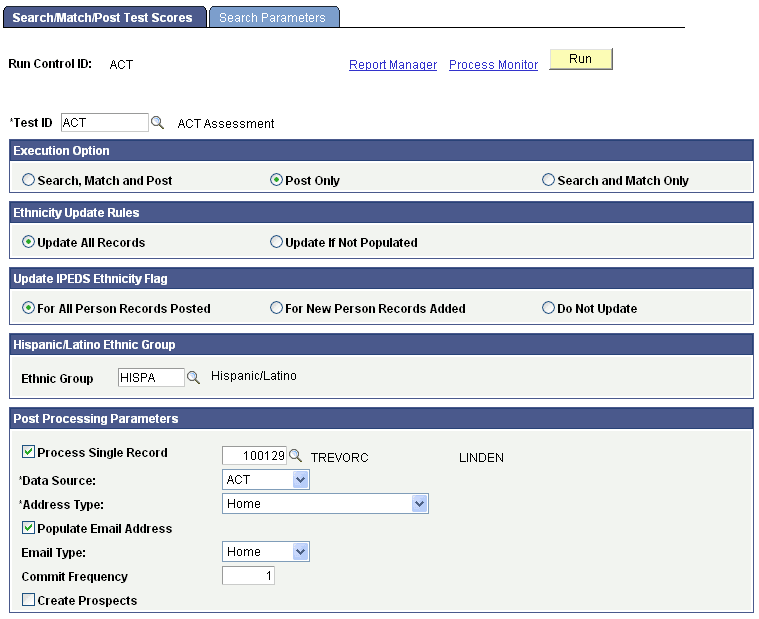

Access the Search/Match/Post Test Scores page (Student Recruiting, and then External Test Score Processing, and then Search/Match/Post/Test Scores or Student Admissions, and then External Test Score Processing, and then Search/Match/Post Test Scores).
This example illustrates the fields and controls on the Search/Match/Post Test Scores page. You can find definitions for the fields and controls later on this page.
Field or Control Description
Test ID
Enter the test ID that you want to process. Once you enter the test ID, the additional fields specific to the test will appear. You must have Test ID Security established in order to select a value. The prompt will display only test IDs to which you have security to access. This field is required.
LSAT/LSDAS Test Score
The system displays this group box if you have selected the CRM for Higher Education check box on the SA Features page and if the test ID is LSAT.
LSAD Test Score
The system does not display the Post To group box if you select this option. You cannot post LSAD test scores to CRM.
LSAT Test Score
The system displays the Post To group box if you select this option. You can post the LSAT test scores to CRM.
Execution Option
Search, Match and Post
Select this option if you want the process to search your database for records that match the suspense record and post the suspense data to your database. This is the recommended option.
Post Only
Select this option if you want only to post the suspense data to your database (if you select this option, you must have already run search/match or manually changed the Search and Post process options on the External Test Score Suspense page).
Search and Match Only
Select this option if you want to only run the search and match process on the suspense file. You will need to post the data at a later time.
Post To
Campus Solutions
Select this option if you want to post the suspense data to Campus Solutions.
Enterprise CRM
Select this option if you want to post the suspense data to PeopleSoft CRM.
The system displays this option if you have selected the CRM for Higher Education check box on the SA Features page of the Student Admin Installation component and if the test ID is eligible for posting to CRM. If the test ID is eligible for posting to CRM, the system displays the Available for CRM Post check box as selected on the  External Test Score Mapping page (Set Up SACR, Product Related, Recruiting and Admissions, External Test Scores, External Test Score Mapping).
Important: If you have opted to post to CRM and if there is no matching person record in Campus Solutions, the process does not create a EMPLID or any record in Campus Solutions. The process will only send the test score and prospect data as a message to Integration Broker. If you have opted to post to CRM and if there is a matching person record in Campus Solutions, the process adds a new record in the Test Results page for the EMPLID (Student Recruiting, External Test Score Processing, Test Results or Student Admissions, External Test Score Processing, Test Results) in addition to sending the message to Integration Broker.
Ethnicity Update Rules
For ACT, LSAT/LSDAS, AMCAS only:
Update All Records
Select this option if you want the process to post the ethnicity data to the ethnicity records (DIVERS_ETHNIC and ETHNICITY_DTL) for all existing EMPLIDS. The posted ethnicity data can be viewed on the Ethnicity page (Campus Community, Personal Information, Biographical, Personal Attributes, Ethnicity) or on the Regional page of the Add/Update a Person component (Campus Community, Personal Information or Personal Information (Student), Add/Update a Person).
If you select this option and if data already exists for an EMPLID on the ethnicity records, the process inserts a new row into the records for the EMPLID. If the Ethnic Group of NSPEC is currently populated on either ethnicity record, new rows will not be inserted.
Update If Not Populated
Select this option if you want the process to post the ethnicity data only for those EMPLIDS who do not have existing ethnicity data.
Set Hispanic/Latino Indicator
For LSAT/LSDAS only:
Hispanic/Latino Populated
Select this option if you want the process to check the Person is Hispanic or Latino check box on the Ethnicity or Regional page (HISP_LATINO = Y for a DIVERS_ETHNIC record).
If you select this option, the process checks the Person is Hispanic or Latino check box if the person's test score ethnicity data is mapped to an Ethnic Group with the EEO Ethnic Category of Hispanic/Latino (Ethnicity or Regional page displays EEO Ethnic Category as the Ethnic Category).
Do Not Update
Select this option if you do not want the process to check the Person is Hispanic or Latino check box on the Ethnicity page.
If you select this option, the process does not check the Person is Hispanic or Latino check box even if the person's test score ethnicity data is mapped to an Ethnic Group with the EEO Ethnic Category of Hispanic/Latino.
Update IPEDS Ethnicity Flag
For ACT, LSAT/LSDAS, and AMCAS only:
For New Person Records Added
Select this option if you want the process to check the IPEDS check box on each ethnic group row inserted to the Ethnicity or Regional page (ETH_VALIDATED = Y for each DIVERS_ETHNIC record) only for new EMPLIDS added to the system.
For All Person Records Posted
Select this option if you want the process to check the IPEDS check box on each ethnic group row inserted to the Ethnicity or Regional page (ETH_VALIDATED = Y for each DIVERS_ETHNIC record) for both new and updated EMPLIDS.
Do Not Update
This check box is available only for ACT. Select this check box if you do not want the process to check the IPEDS check box regardless of whether the suspense record contains ethnicity information.
Hispanic/Latino Ethnic Group
For ACT only:
Ethnic Group
Select the PeopleSoft ethnic group code that the search/match/post process should post to the Ethnicity group box of the Ethnicity or Regional page. The process posts this value only if the person is Hispanic or Latino.
Post Processing Parameters
Process Single Record
Select this check box if you want to run the search/match/post process for a single suspense record. The field to the right becomes available. Select the suspense record that you want to process. Only records where the Edit processing option is set to Complete on the External Test Score Suspense component will appear.
Data Source
Select the data source from which this information was received. Data source is a required value on the Test Results page. The search/match/post process will post the value that you select here to the Test Results page. Values for this field are delivered with your system as translate values. You can modify these translate values.
Address Type
If the search/match/post process adds a new record to your database, the process loads the address information from the test record into the Addresses page. Select the address type that you want the process to assign to the new address. Define address types on the Address Type Table.
Phone Type
If the search/match/post process adds a new record to your database, the process loads the phone number from the test record to the Personal Information page. Select the phone type that you want to process to assign to the new phone number. This field will appear only for test IDs where the phone number is loaded.
Commit Frequency
The commit frequency enables you to decide how often the data is saved during the Search/Match/Post process. The field defaults to 1000. Edit this field to decrease or increase the number of records that are processed before being saved. The commit frequency can help with the performance of the program. A commit frequency that is too low, however, can slow the program down.
Populate Email Address, Email Type
Select this check box to post an email address to the Email Addresses on the Add/Update a Person component. If you choose to populate an email address, you must then select an email type.
Note: These fields appear only for test IDs where an email address is loaded.
Create Prospects
Select to create prospect records for the IDs that are added or for existing IDs where no prospect record exists from the test score post. The Default Prospect Values group box becomes available to enter default values for the prospect records that the system creates. You can view prospect data in the Create/Update Prospect component under the menu Student Recruiting, Maintain Prospects.
If you have selected the Enterprise CRM option in the Post To group box, the system selects the Create Prospects check box and disables it
You must enter the required fields in the Default Prospect Values group if the Create Prospects check box is selected.
Select the default values that you want the system to assign to the prospects that you create from the test score post. For example, if you select UGRD in the Academic Career field, the system will assign every prospect it creates to the undergraduate academic career. To create prospects in Campus Solutions, you must enter an academic institution, academic career, recruiting status, and recruiting center. To create prospects in CRM, you must enter an academic institution, academic career, and recruiting status. Recruiting Center becomes an optional field if you have selected the Post to Enterprise CRM option. In certain circumstances, you might also want to assign additional information, such as academic program and plan, and admit term, when your test load contains a specific set of prospects.
Academic Program
Because the Academic Program table is keyed by admit term, you must select an admit term to select an academic program. You do not have to assign an academic program.
Assign 3C
If you are posting data to Campus Solutions, select this check box to assign 3Cs to the prospects that you create from the test score post. The Event ID field becomes available.
The system clears and disables this check box if you have selected the Enterprise CRM option in the Post To group box. The 3Cs feature is not available in CRM.
Event ID
Assign an event ID to the prospects that you create from the test score post. Only the event IDs that have the administrative functions PROS (prospect) and PROP (prospect program) are available. PROP is available only if you select an academic program on this page. Define event IDs on the Event Definition page.
If the testing agency provides a graduation date, the process uses the mapping defined on the Admit Term Map page to determine an admit term for a prospect. If the admit term mapping is not done or if the testing agency does not provide a graduation date, the process uses the default admit term defined on the Default Prospect Values group box. To navigate to the Admit Term Map page, select Set Up SACR, Product Related, Recruiting and Admissions, External Test Scores, Create Prospects Setup, Admit Term Map.
If the testing agency provides an interest code, the process uses the mapping defined on the Program Plan SubPlan Map page to determine the program, plan and subplan for a prospect. If this mapping is not done or if the testing agency does not provide an interest code, the process uses the default program, plan, and subplan defined on the Default Prospect Values group box. To navigate to the Program Plan SubPlan Map page, select Set Up SACR, Product Related, Recruiting and Admissions, External Test Scores, Create Prospects Setup, Program Plan SubPlan Map.
See Campus Community Fundamentals: Understanding the 3C Engine.
