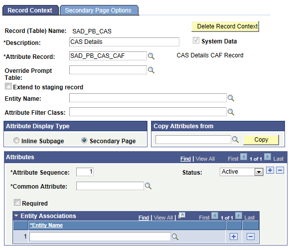

  • Configuring common attributes for PBI.

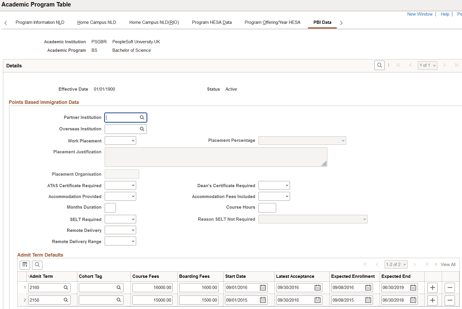

Academic Program PBI Data
SAD_PB_PROG
Set Up SACR, and then Foundation Tables, and then Academic Structure, and then Academic Program Table, and then PBI Data
Specify field values at program level.

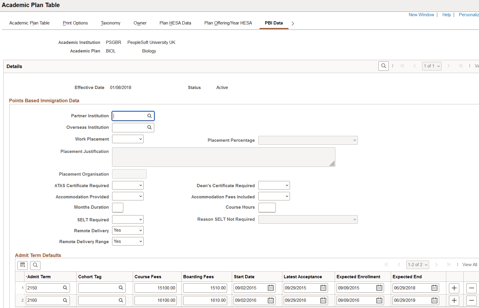

Academic Plan PBI Data
SAD_PB_PLAN
Set Up SACR, and then Foundation Tables, and then Academic Structure, and then Academic Plan Table, and then PBI Data
Specify field values at plan level.

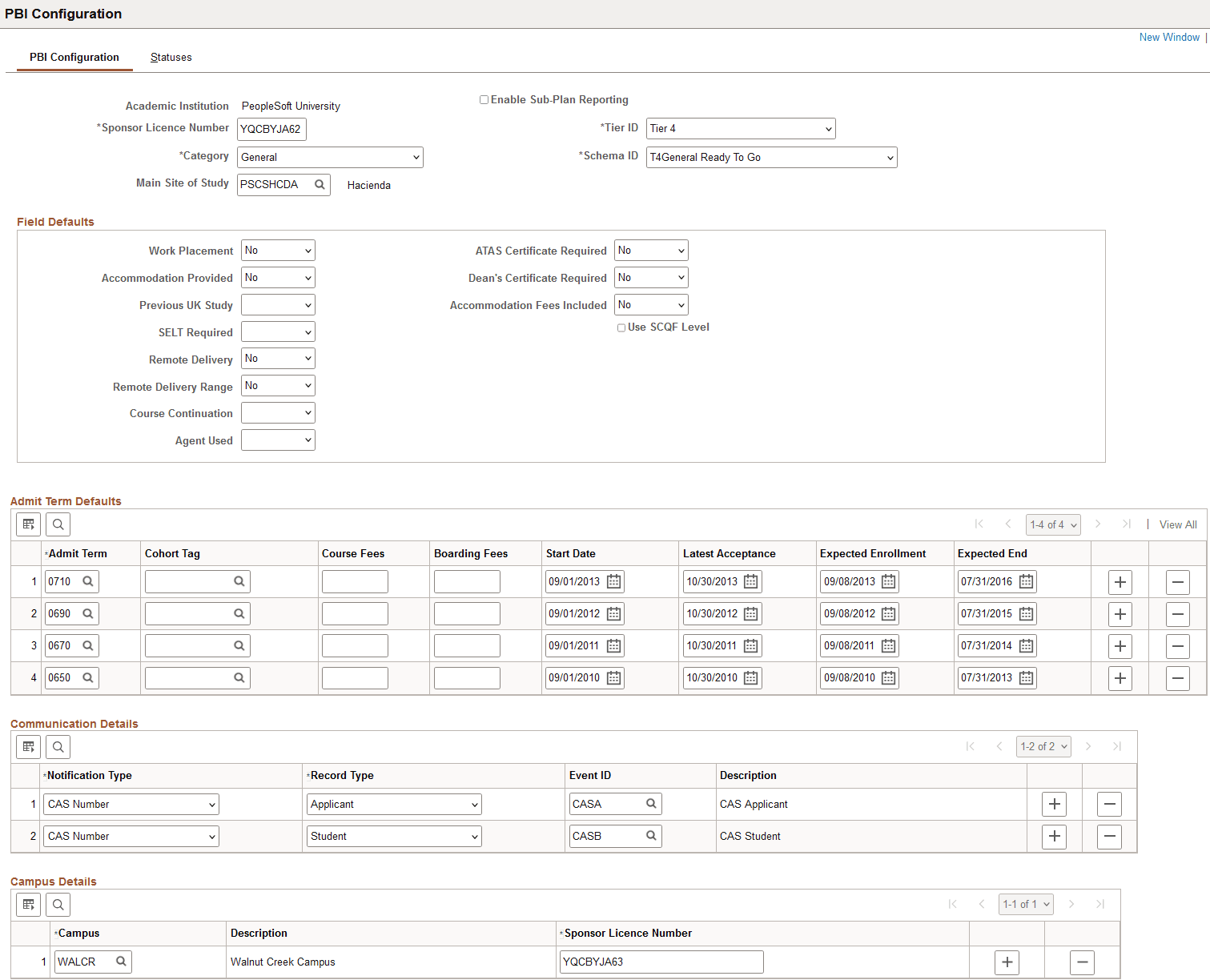

Setting Up a PBI Configuration Record
Access the PBI Configuration page (Student Admissions, and then PBI Processing, and then PBI Configuration).
This example illustrates the fields and controls on the PBI Configuration page . You can find definitions for the fields and controls later on this page.
PBI (Points Based Immigration) Configuration page
Field or Control Description
Enable Sub-Plan Reporting
Select the check box for Sub-Plans to be considered in the derivation of Course Title in the Upload extract.
Sponsor License Number
Enter your institution's license number. The value is used to derive the corresponding field in the Upload extract.
Use the Tier ID, Category and Schema ID fields to specify the values that are used to derive the corresponding fields in the Upload extract.
Main Site of Study
Enter the Location if the same Main Site details are reported in the Upload extract for all CAS records for your institution. The value is displayed as the default Main Site on the CAS Details page. The value is used in the derivation of the Main Site address fields in the Upload extract if no Reported Site is defined in the individual CAS Details record.
Field Defaults
Use this region to specify default field values for new CAS records. The system uses a Field Defaults value as a default value in a new CAS Details record only if the value is not defined at the program or plan level.
Admit Term Defaults
For each term, define the values that are used to populate the fees and course date fields in new CAS records if no values are defined at plan or program level. The Latest Acceptance Date should be on or after the Course Start Date.
Cohort Tag
(Optional) Select the appropriate cohort tag as set up for your institution.
Use this field to allow different dates and fees to be defined for different cohorts within the same Admit Term. The value you set in this field is used by the CAS Details component as well as the processes that are used to add new CAS records to evaluate the default dates and fees for an applicant or student.

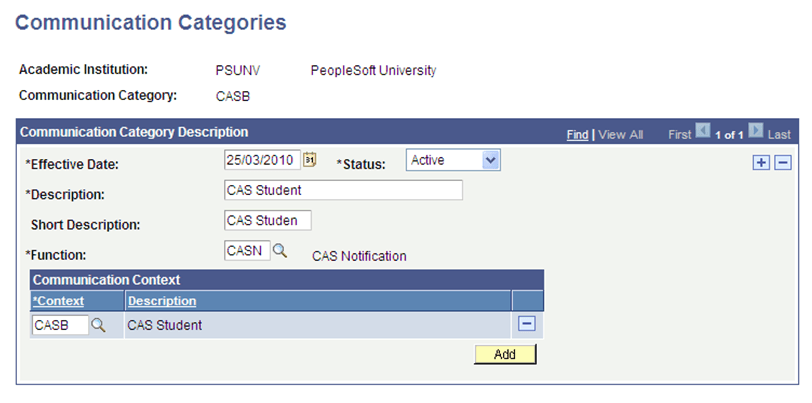

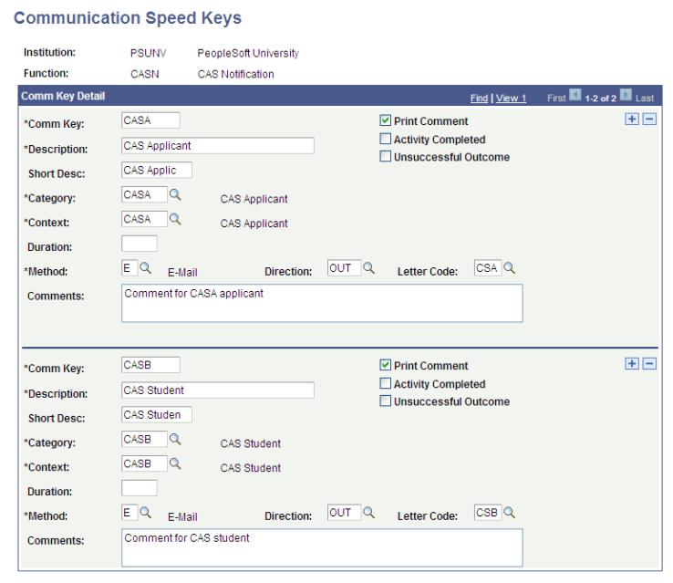

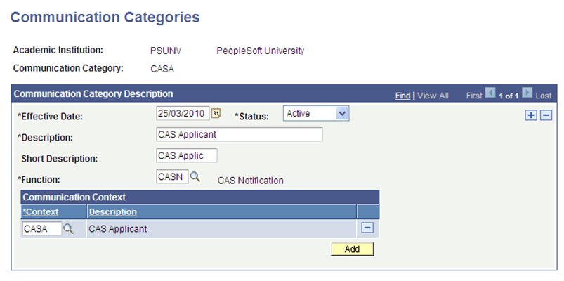

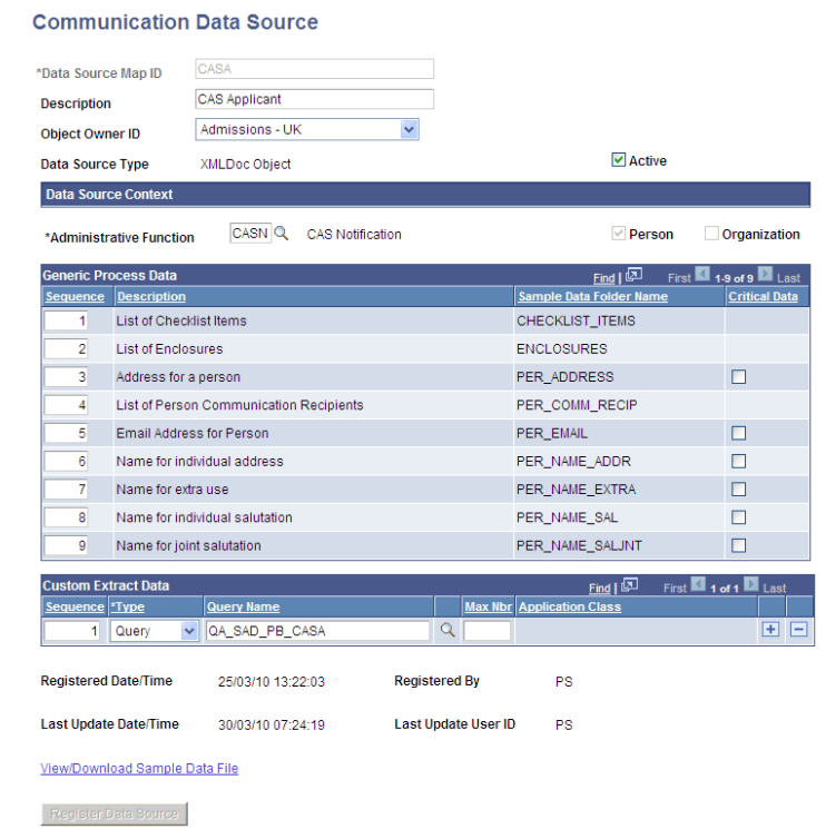

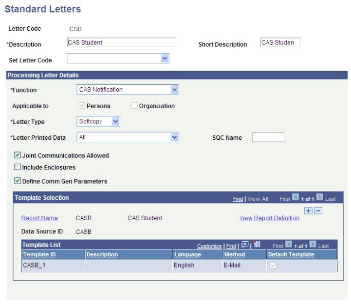

Communication Details
Use this region to set up the event IDs that are used in the communication generation process to notify applicants or students about their CAS number or fee updates.
Notification Type
Indicate whether you want to notify CAS Number or Fee Update.
Record Type
Indicate whether you want to notify the applicant or student.

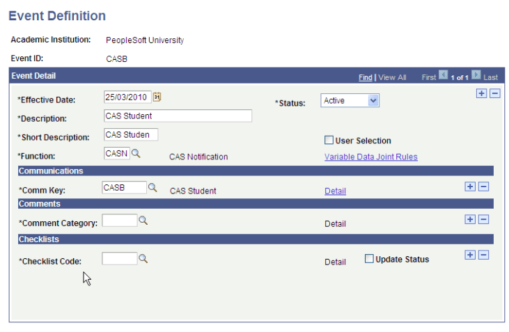

Event ID
Select the event ID that you want the system to assign the applicant or student.
You can select only event IDs defined for the CASN administrative function in Campus Community. The CASN function captures Academic Career, Career Number and CAS Number as variable data. Refer to "Setting Up PBI Communications" in this section for information about the event ID setups.
The system assigns an event ID for CAS Number notification type to a person when the Import CAS Details process loads the CAS number from the inbound XML file for the first time.
For more information about how the process assigns event IDs for CAS Number notification, see Importing CAS Details.
The system assigns an event ID for Fee Update notification type when the Create Extract process creates the update extract data.
You can create one or more communication records using the Communication Generation process to notify applicants or students about their CAS number or fee updates.
Campus Details
Use this region to specify Sponsor Licence Numbers for individual Campuses if your institution has a different licence number for a particular campus. The value is used to derive the corresponding field in the Upload extract based on the Campus value of the applicant or student in place of the value defined for your institution. If no value is defined the value defined for the institution is used.

Entering the PBI Data for an Academic Program
Access the Academic Program PBI Data page (Set Up SACR, and then Foundation Tables, and then Academic Structure, and then Academic Program Table, and then PBI Data).
This example illustrates the fields and controls on the Academic Program PBI Data page. You can find definitions for the fields and controls later on this page.
Academic Program PBI (Points Based Immigration) Data page
This page appears only if you have selected the PBI check box on the Academic Institution 6 or SA Features page. The values defined are used to populate the corresponding fields in new CAS records if no value is defined for the field at plan level. Values are also used during field derivation.
Cohort Tag
The Placement Percentage, Placement Justification, and Placement Organisation fields become available for entry if you select Yes in the Work Placement field. The Reason SELT Not Required field becomes available for entry if you select No in the SELT Required field.
Refer to the PBI Field Derivation documentation for information about derivation of the individual fields.
Entering the PBI Data for an Academic Plan
Access the Academic Plan PBI Data page (Set Up SACR, and then Foundation Tables, and then Academic Structure, and then Academic Plan Table, and then PBI Data).
This example illustrates the fields and controls on the Academic Plan PBI Data page.
Academic Plan PBI (Points Based Immigration) Data page
This page appears only if you have selected the PBI check box on the Academic Institution 6 or SA Features page. The values defined are used to populate the corresponding fields in new CAS records. Values are also used during field derivation.
Cohort Tag
You must set up Campus Community communications to notify applicants and students about their assigned CAS numbers or fee update details. This section discusses the steps required to define the Event ID values that are used in the PBI Configuration page, the Import CAS Details process (for CAS Number notification), the Create Extract - update process (for Fee Update notification), the 3C Engine process and the Communications Generation process to create communications to notify applicants and students.
For more information on setting up communications, see:
This section provides communications setup examples for sending CAS number notifications to applicants and students. Similar setups are required for Fee Update notification. The Fee Update notification should contain the relevant update data: First Year Course Fees, Course Fees Paid, Accommodation Fees Paid, and Boarding Fees Paid.

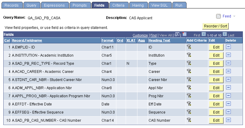

Creating Queries
Access the Query Manager page (Reporting Tools, and then Query, and then Query Manager).
The PeopleSoft system delivers example queries, one for CAS Number notifications to applicants (QA_SAD_PB_CASA) and one for CAS Number notifications to continuing students (QA_SAD_PB_CASB).
Create your own queries to select all the data you require for your communications. Refer to "Defining Communication Data Sources" in this section for information about data sources.
Each query requires the following:
  • The core record must be included in the query associated with the administrative function. For the CASN function, the CAS Details record (SAD_PB_CAS) must be included.
  • A prompt must be created for the applicant/student ID. The Unique Prompt Name must be changed to Person_ID.
  • Prompts must also be created for the variable data fields relating to the administrative function, ACAD_CAREER, STDNT_CAR_NBR and SAD_PB_CAS_NUMBER.
This example shows the selected fields for the QA_SAD_PB_CASA query.
Fields page for the QA_SAD_PB_CASA query

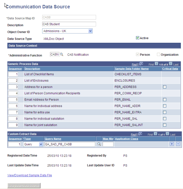

Access the Communication Data Source page (Campus Community, and then Communications, and then Set up Communications, and then Communication Data Source).
Define Communication Data Sources for each query.
This example shows the CASA data source map ID.
Communication Data Source page for CASA (Confirmation of Acceptance of Studies Number notifications to applicants)
This example shows the CASB data source map ID.
Communication Data Source page for CASB (Confirmation of Acceptance of Studies Number notifications to continuing students)

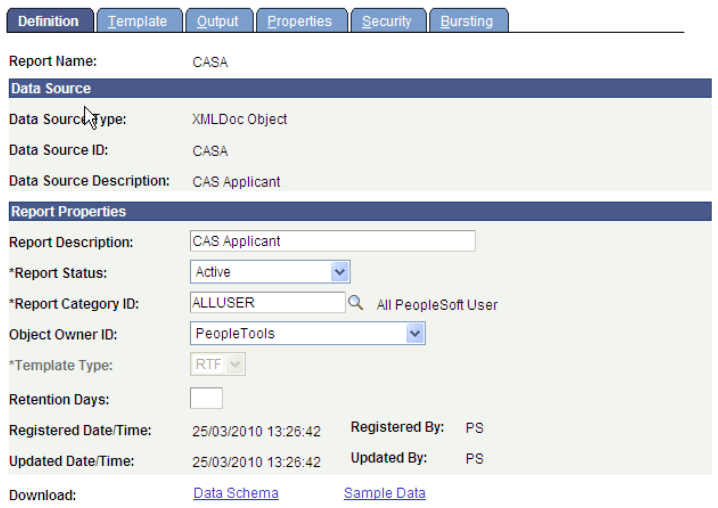

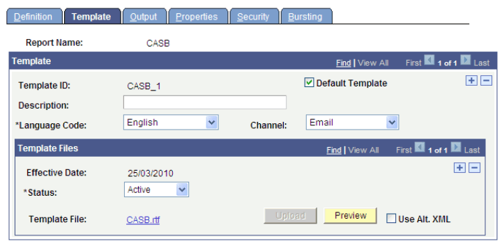

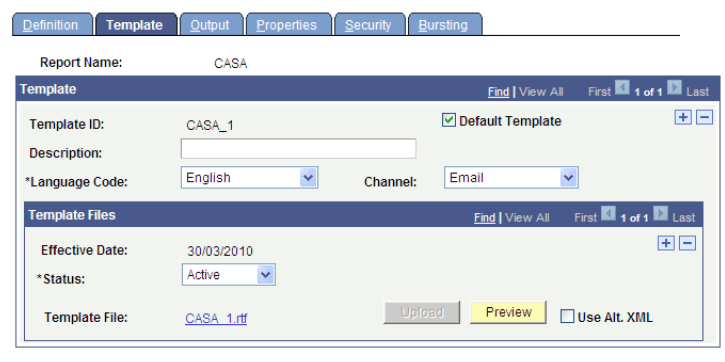

Defining Report Definitions
Access the Definition page (Reporting Tools, and then BI Publisher, and then Report Definition).
Example templates are delivered that can be used in Report Definitions for CAS Number notifications to applicants (CASA_1) and CAS Number notifications to students (CASB_1). The templates have been created from the XML file downloaded from each Data Source using Oracle BI Publisher.
Create your own template files. There are several possible methods including installing BI Publisher for Word which creates a new menu option in Word. A template can then be created from the XML document downloaded from the Data Source page.
This example shows the Definition page for CASA.
Definition page for CASA (Confirmation of Acceptance of Studies Number notifications to applicants)
This example shows the Template page for CASA.
Template page for CASA (Confirmation of Acceptance of Studies Number notifications to applicants)
This example shows the Definition page for CASB.
Definition page for CASB (Confirmation of Acceptance of Studies Number notifications to continuing students)
This example shows the Template page for CASB.
Template page for CASB (Confirmation of Acceptance of Studies Number notifications to continuing students)

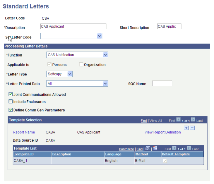

Defining Standard Letters
Access the Standard Letters page (Campus Community, and then Communications, and then Set up Communications, and then Standard Letter Table).
Create standard letters for applicants and students. Select Report Name to add the details.
This example shows the Standard Letters page for CSA.
Standard Letters page for CSA (Confirmation of Acceptance of Studies Number notifications to applicants)
This example shows the Standard Letters page for CSB.
Standard Letters page for CSB (Confirmation of Acceptance of Studies Number notifications to continuing students)

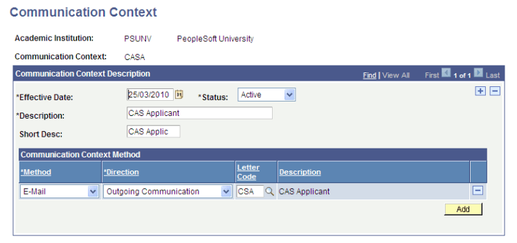

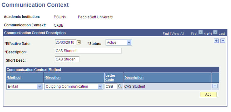

Defining Communication Contexts
Access the Communications Context page (Campus Community, and then Communications, and then Set up Communications, and then Communications Context Table).
Create communication contexts for applicants and students.
This example shows Communications Context page for CASA.
Communications Context page for CASA (Confirmation of Acceptance of Studies Number notifications to applicants)
This example shows Communications Context page for CASB.
Communications Context page for CASB (Confirmation of Acceptance of Studies Number notifications to continuing students)
Defining Communication Categories
Access the Communications Category page (Campus Community, and then Communications, and then Set up Communications, and then Communications Category Table).
Create communication categories for applicants and students using the CASN administrative function and the communication contexts created in the previous step.
This example shows the Communications Categories page for CASA.
Communications Categories page for CASA (Confirmation of Acceptance of Studies Number notifications to applicants)
This example shows the Communications Categories page for CASB.
Communications Categories page for CASB (Confirmation of Acceptance of Studies Number notifications to continuing students)
Defining Communication Speed Keys
Access the Speed Key Table page (Campus Community, and then Communications, and then Set up Communications, and then Speed Key Table).
Create speed keys for applicants and students using the CASN administrative function and the communication contexts and categories created in the previous steps.
This example shows the Communications Speed Keys page for CASA and CASB.
Communications Speed Keys page for CASA (Confirmation of Acceptance of Studies Number notifications to applicants) and CASB (Confirmation of Acceptance of Studies Number notifications to continuing students)

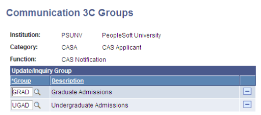

Defining Communication 3C Groups
Access the Communication 3C Groups page (Campus Community, and then Communications, and then Set up Communications, and then Communication 3C Groups).
Define the new categories for the appropriate Communication 3C Groups for the user depending on your institution's group setup (Set Up SACR, User Defaults, User 3C Group Summary).
This example shows the Communication 3C Groups page for CASA.
Communication 3C (communications, comments, and checklists) Groups page for CASA (Confirmation of Acceptance of Studies Number notifications to applicants)
This example shows the Communication 3C Groups page for CASB.
Communication 3C (communications, comments, and checklists) Groups page for CASB (Confirmation of Acceptance of Studies Number notifications to continuing students)

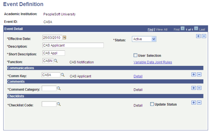

Creating Event Definitions
Access the Event Definition page (Campus Community, and then 3C Engine, and then Set Up 3C Engine, and then Event Definition).
Define events using the CASN administrative function and communication keys defined in previous steps. Additional communications, comments or checklists can be added to the events if required.
This example shows the Event Definition page for CASA.
Event Definition page for CASA (Confirmation of Acceptance of Studies Number notifications to applicants)
This example shows the Event Definition page for CASB.
Event Definition page for CASB (Confirmation of Acceptance of Studies Number notifications to continuing students)

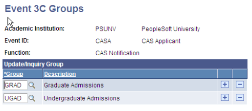

Defining Event 3C Groups
Access the Event 3C Groups page (Campus Community, and then 3C Engine, and then Set Up 3C Engine, and then Event 3C Groups).
Define the new event IDs for the appropriate Communication 3C Groups for the user depending on your institutions group setup (Set Up SACR, User Defaults, User 3C Group Summary).
This example shows the Event 3C Groups page for CASA.
Event 3C (communications, comments, and checklists) Groups page for CASA (Confirmation of Acceptance of Studies Number notifications to applicants)
This example shows the Event 3C Groups page for CASB.
Event 3C (communications, comments, and checklists) Groups page for CASB (Confirmation of Acceptance of Studies Number notifications to continuing students)

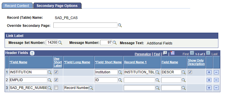

Configuring Common Attributes for PBI
Common Attribute Framework is enabled for the CAS Details page (SAD_PB_CAS) with a delivered record context. You can use this framework to add an additional fields link and secondary page to the CAS Details page. For more information on the CAS Details page, see the next section:
Creating and Maintaining CAS Details
For information on using Common Attribute Framework, refer to the Campus Community — Common Attribute Framework documentation.
See Campus Community Fundamentals: Understanding Common Attribute Framework
This example shows the delivered record context for SAD_PB_CAS.
Record Context page for CAS (Confirmation of Acceptance of Studies) Details page
Secondary Page Options for CAS (Confirmation of Acceptance of Studies) Details page
When you add a minimum of one attribute to this record context, the Additional Details link will appear on the CAS Details page. Click that link to capture additional data. If no attribute is added to this record context, the CAS Details page will not display the link.
