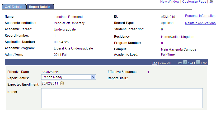

Report Details
SAD_PB_CASREPDTLS
  • Student Admissions, and then PBI Processing , and then CAS Maintenance, and then Report Details
  • Student Admissions, and then Application Entry, and then CAS Maintenance
  • Student Admissions, and then Application Maintenance, and then Maintain Applications, and then Application Program Data, and then CAS Details, and then Report Details
  • Records and Enrollments, and then Career and Program Information, and then Student Program/Plan, and then Student Program , and then CAS Details, and then Report Details
Enter or update report field values for a CAS Details record at the application or student career level.

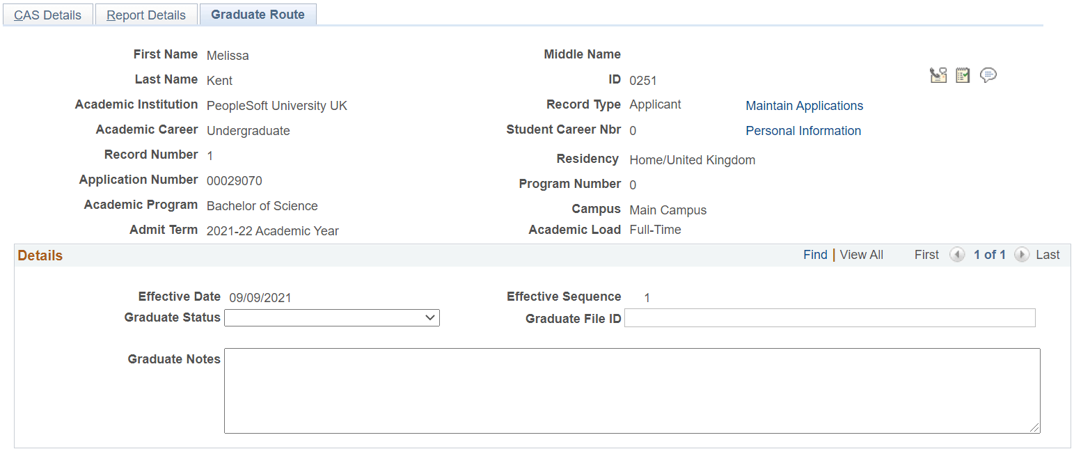

Graduate Route
SAD_PB_CASGRDRPT
Student Admissions, and then PBI Processing , and then CAS Maintenance, and then Graduate Route
View, enter, or update values for Graduate Route processing.

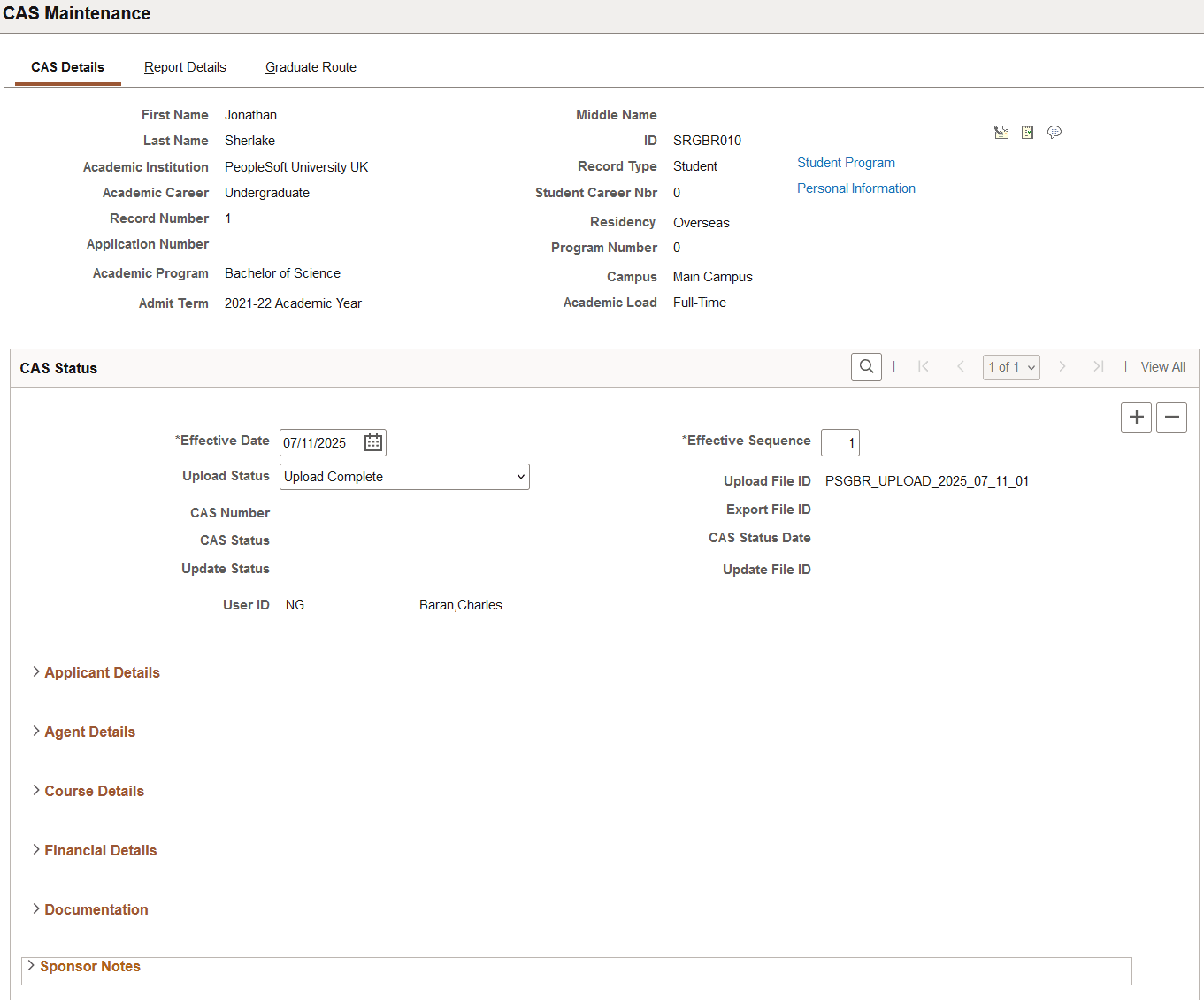

Access the CAS Details page (Student Admissions, and then PBI Processing, and then CAS Maintenance, and then CAS Details).
This example illustrates the fields and controls on the CAS Details page. You can find definitions for the fields and controls later on this page.
CAS (Confirmation of Acceptance of Studies) Details page
You can use the CAS Details page to view a CAS record's history of changes throughout its processing cycle. Each history change record has a unique Effective Date and Sequence Number combination.
Field or Control Description
First Name, Middle Name, and Last Name
Displays the values from the most recent effective-dated primary name record for the person.
Personal Information
Click to navigate to the Biographical Details page of the Add/Update a Person component.
View Long Name
Click to access the Manage Long Name page.
This link appears only when there is a long names record associated with the primary name record
Effective Date
By default, the current date for new rows is reflected. But you can manually update this date to reflect the actual date the change was reported.
Upload Status
Identifies whether the record has been identified as:
  • Newly added (New or blank)
  • To be included in the Upload extract (Upload Ready)
  • Included in the Upload extract (Upload Complete)
Once the CAS Number and Status have been imported the system makes this field non-editable.
Upload File ID
Displays the File ID generated when the record is included in the Upload extract.
CAS Number, Export File ID, CAS Status, andCAS Status Date
Displays the values imported using the Import CAS Details process.
The CAS Number field is used to derive the corresponding field in the Update and Report extracts.
Update Status
  • Requiring inclusion in the Update extract (Update Required)
  • To be included in the Update extract (Update Ready)
  • Included in the Update extract (Update Complete)
The system enables this field once the CAS Number and Status has been imported and the CAS Status is Assigned. Once the CAS Status is updated to one of the post-assigned values, for example, Used, the field becomes non-editable.
Once the CAS Status is Assigned, the system will automatically update the Update Status to Update Required when changes are made to the Course Fees Paid, Accommodation Fees Paid or Boarding Fees paid values.
Update File ID
Displays the File ID generated when the record is included in the Update extract. If the record is included in multiple Update extracts the most recent Update File ID is displayed in the current effective date/sequence record.
User ID
Indicates the User ID and name of the user who last updated the record.
If the Create Extract Data or Import CAS Details process updated the record, the User ID field indicates the user who ran the process.
Applicant Details

Course Start Date
The system automatically populates this field when a new CAS record is created. The value is populated based on the value defined for the Admit Term and Cohort Tag (if defined) from:
  • Academic Plan PBI Data page
  • Academic Program PBI Data page
  • PBI Configuration page
  • For applicants, the term begin date of the Admit Term on the Application Program Data page; for students, the earliest effective date on the Student Program page.
You can override the default value.
Course Start Date must be equal to or greater than the current system date when the Upload Status is set to Upload Ready.
Expected End Date
The system automatically populates this field when a new CAS record is created. The value is populated based on the value defined for the Admit Term and Cohort Tag (if defined) from (a) Academic Plan PBI Data page, (b) Academic Program PBI Data page, (c) PBI Configuration page or (d) the end date of the Expected Graduation Term.
Latest Acceptance Date
The system automatically populates this field when a new CAS record is created. The value is populated based on the value defined for the Admit Term and Cohort Tag (if defined) from (a) Academic Plan PBI Data page, (b) Academic Program PBI Data page or (c) PBI Configuration page. If default value does not exist at these three levels, then the system sets the field as blank.
You can override the default value. The value must be on or after the Course Start Date and on or before the Expected End Date.
Months Duration
The system automatically populates this field when a new CAS record is created. The value is populated from (a) Academic Plan PBI Data page or (b) Academic Program PBI Data page. If default value does not exist at these two levels, then the system sets the field as blank.
You can override the default value by entering a number in the range of 0 and 99.
This field is informational only and is not included in the Upload, Update or Report extract.
Full-Time Course
If the Academic Load field displays Full-Time, the system automatically populates the value Yes when a new CAS record is created.
Course Hours
You can override the default value by entering a decimal value in the range of 0.0 and 168.0.
Course Continuation
If the value is set to Yes, Original Course Start Date is enabled.
For new records, this value is derived from the value that's set on the PBI Configuration page.
Set a value that's before the course start date.
Remote Delivery
If the value is set to Yes, Remote Delivery Range is enabled.
For new records, this value is derived from any one of these sources if they're defined there: Academic Plan, Academic Program, or PBI Configuration.
Previous UK Study
The system automatically populates this field when a new CAS record is created. The value is populated from the PBI Configuration page. If default value does not exist at the configuration level, then the system sets the field as blank.
You can select a different value if required.
Previous Academic Level, Current Level Comparison, and Progression Justification
These three fields become available when the value is Yes in the Previous UK Study field.
Work Placement
The system automatically populates this field when a new CAS record is created. The value is populated from (a) Academic Plan PBI Data page, (b) Academic Program PBI Data page or (c) PBI Configuration page. If default value does not exist at these three levels, then the system sets the field as blank.
Placement Organization
Enter an external ID value if required.
This field becomes available when the value is Yes in the Work Placement field.
Placement Justification
Placement Percentage
For Placement Percentage, Placement Justification and Placement Organisation: If Work Placement defaults to No from the academic plan, then the system skips step (b) for these three fields and values for these fields are not derived from the academic program. In such a case, the value for each of these three fields will either default from (a) academic plan or will be blank to ensure that the default Work Placement details are consistent.
Financial Details
Accommodation Provided
First Year Course Fees
The system automatically populates this field when a new CAS record is created. The value is populated based on the value defined for the admit term and Cohort Tag (if defined) from (a) Academic Plan PBI Data page, (b) Academic Program PBI Data page or (c) PBI Configuration page.
If no value is defined for the admit term, then the field value defaults to zero.
You can override the value by entering a number in the range of 0.00 to 1,000,000.
Course Fees Paid
Enter a number in the range of 0.00 to 1,000,000.
You cannot enter a value greater than the First Year Course Fees, if the First Year Course Fees field has a value greater than zero.
If the CAS Status is Assigned the Update Status value is updated to Update Required when the value for this field is updated.
If you leave the field blank, the Create Extract process derives zero for the field in the Upload extract.
Accommodation Fees Included
First Year Boarding Fees
The system automatically populates this field when a new CAS record is created. The value is populated based on the value defined for the admit term and Cohort Tag (if defined) from (a) Academic Plan PBI Data page, (b) Academic Program PBI Data page or (c) PBI Configuration page. If default value does not exist at these three levels, then the system sets the field as blank.
Boarding Fees Paid
You cannot enter a value greater than the First Year Boarding Fees, if the First Year Boarding Fees field has a value greater than zero.
Bursary/Scholarship
For new records, the default value is 0.
Documentation
Offer Documents
Enter a value up to a maximum of 2000 characters.
The value is used to derive the DocumentsUsedToObtainOffer field in the Upload extract.
ATAS Certificate Required
Dean's Certificate Required
Sponsor Notes
To notify UKVI of corrections to the applicant data, an institution adds Sponsor Notes to a CAS record through SMS. You can use Notes field to enter the same notes to a CAS record in the system. This enables you to maintain the Sponsor Notes locally. The system does not include the Notes field value in the Upload extract data.
Entering PBI Report Data for Applicants or Students
Access the Report Details page (Student Admissions, and then PBI Processing, and then CAS Maintenance, and then Report Details).
This example illustrates the fields and controls on the Report Details page . You can find definitions for the fields and controls later on this page.
Report Details page
Report Status
  • To be included in the Report extract (Report Ready).
  • Included in the Report extract (Report Complete).
You can set report status to Report Ready, only if the CAS Number is populated and the CAS Status of the record is Used.
Report File ID
Displays the File ID generated when the record is included in the Report extract.
Expected Enrollment
You can override the default value. The value must be on or before the Latest Acceptance Date defined on the Course Details region of the CAS Details page.
Notes
The value is used to derive the Notes field for the Report extract.
Entering Graduate Route Information
Access the Graduate Route page (Student Admissions, and then PBI Processing , and then CAS Maintenance, and then Graduate Route ).
This example illustrates the fields and controls on the Graduate Route page . You can find definitions for the fields and controls later on this page.
Graduate Route page
Graduate Status
Identifies whether the record is:
  • To be included in the Graduate extract (Graduate Eligible).
  • Excluded from the Graduate extract (Graduate Ineligible).
  • Included in the Graduate extract (Graduate Reported).
Graduate File ID
When a student's record has been included in the graduate extract, this field shows the file ID that contains the record.
You can update this field to clear the existing value in case there's an error in processing the file at UKVI.
Graduate Notes
The CAS Update Record process can manually update this field, or you can update it manually for students who have been reported directly through the SMS portal.
Note: Graduate Notes is not included in the XML file for submission to the UKVI.
