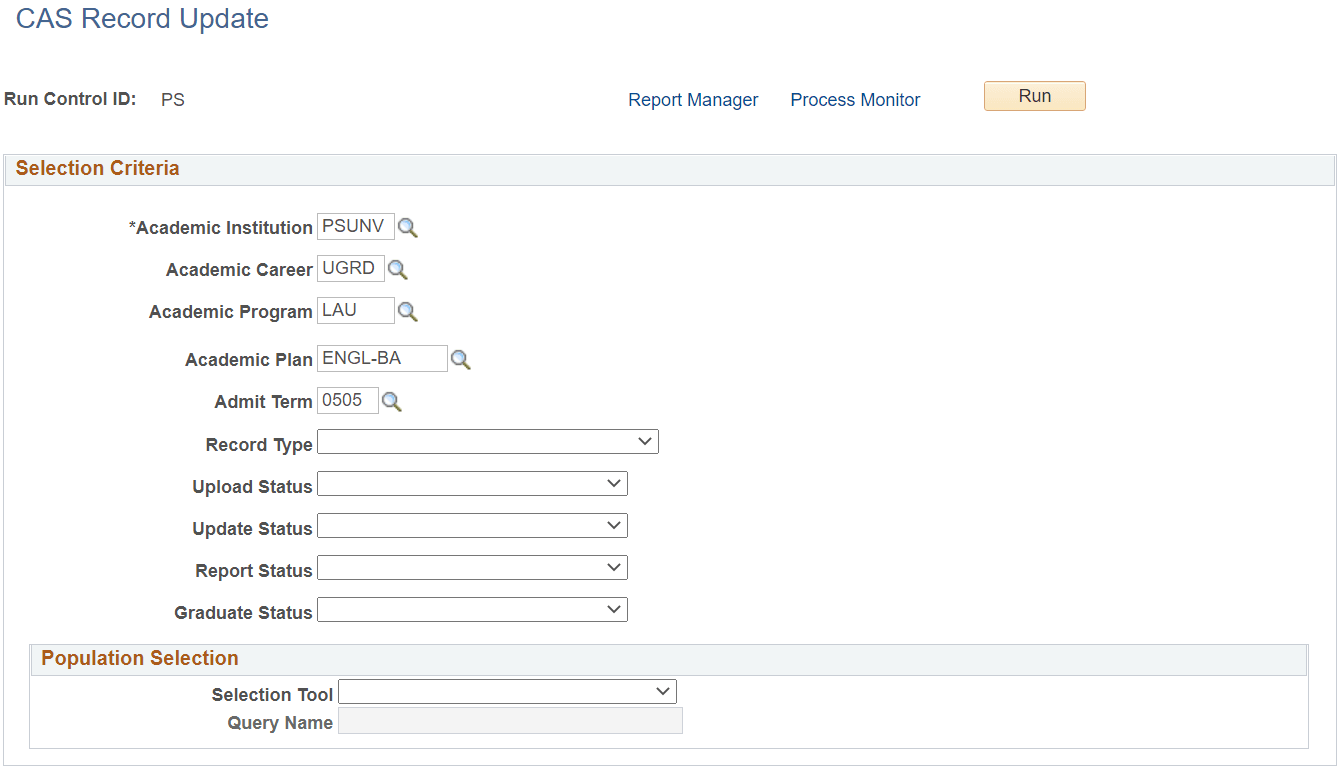

Access the CAS Record Update page (Student Admissions, and then PBI Processing , and then CAS Record Update).
This example illustrates the fields and controls on the CAS Record Update page (1 of 2). You can find definitions for the fields and controls later on this page.

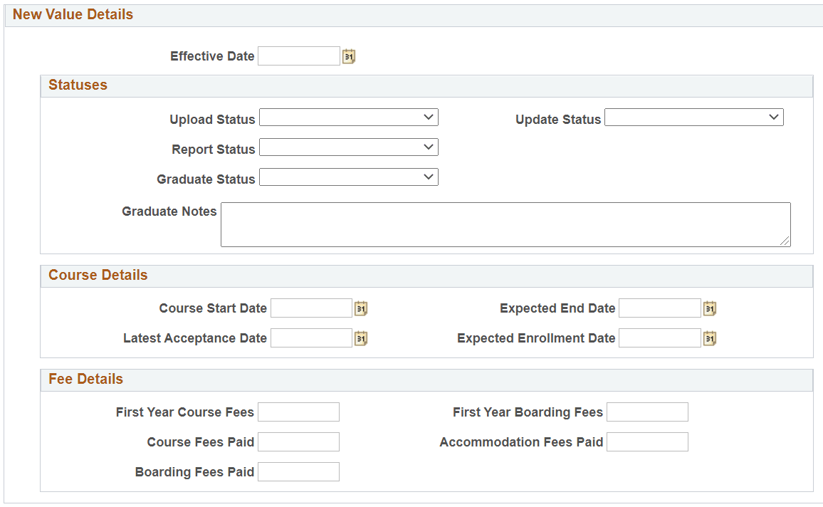

This example illustrates the fields and controls on the CAS Record Update page (2 of 2). You can find definitions for the fields and controls later on this page.
Use the Selection Criteria region to specify the group of CAS records that you want to update.
Use the Population Selection region to further filter the records that are selected for update by selecting a PS Query value or an external file.
Use the New Value Details region to specify the values that are updated by the process.
