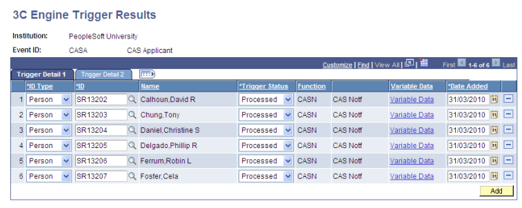

This example shows the 3C Engine Trigger Results page for CAS Number notification.
3C Engine Trigger Results page for CASA
