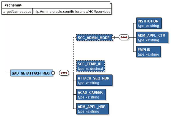

Input Message: SAD_GETATTACH_REQ
This image shows the input parameters that the SAD_GETATTACH service operation receives from an online application.
SAD_GETATTACH_REQ Message Parameters
Required data that the online application must supply to the service operation in Non-administrator (Applicant) mode:
  • Attachment Sequence Number
  • Academic Career
  • Application Number
Required data that the online application must supply to the service operation in Administrator mode:
  • Institution
  • Admission Application Center
